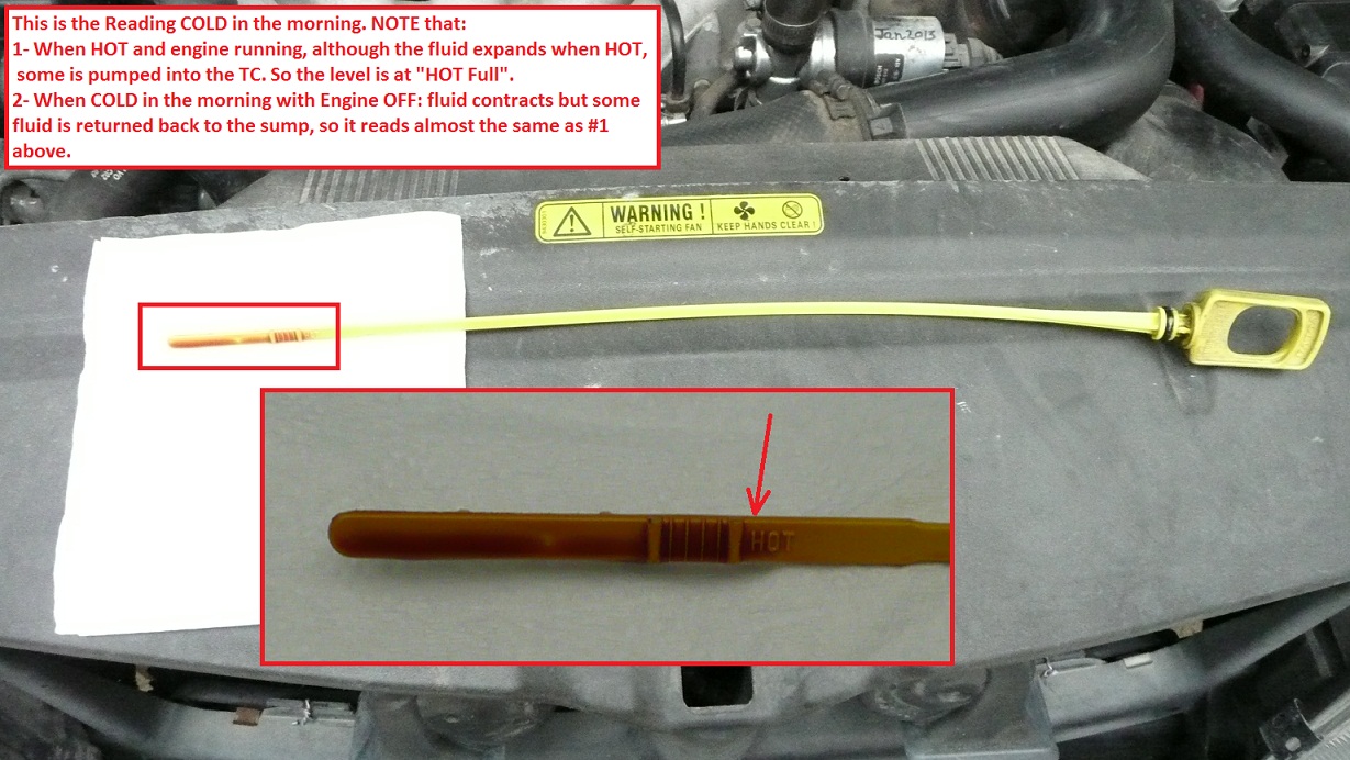

OK,
I did my experiment.
1- HOT engine and idle rpm, checked the ATF level: it was 3 mm Below Max.
It has been this way since the last time I changed the ATF a few years ago.
2- Next morning with COLD engine (engine OFF) and car in exact same spot.
Checked the ATF level, it is 3 mm Above Max "Hot Full".
So, my thinking is...
- When HOT, although the fluid expands in volume, some is pumped into the TC, so the level is a bit Below MAX as the book says.
- When COLD in the morning (engine OFF), although the fluid now contracts in volume, some is returned back to the sump, so the level is a bit Above MAX.
Anyway, this goes to tell you that it is fine to check your ATF fluid COLD in the morning and with engine OFF (on a flat driveway), as long as you know what you are looking at.
No need to warm up the car. If you have any doubt, do your own experiment, take photos (HOT and engine IDLE vs COLD engine OFF) and post.

Just checked again with engine HOT and at Idle speed of 750 rpm.
I revised my post above to be accurate.
If you use the Max (HOT) as a landmark, in my case:
- Engine HOT and Running at 750 rpm: 3 mm Below Max.
- Engine COLD and Off (not running) in the morning: 3 mm Above Max.
The bottom line: the difference is about 6mm for these 2 situations.
So, if you want a quick check in the morning with engine COLD and OFF, 6-10mm above Max is good.
I sketched a little diagram so you can see what I mean:

Later on, I did the test myself with real measurements in the afternoon (going home from work with hot engine running) and again early in the morning at 7AM when I get up. Car in the exact same spot, the latest post is correct, the difference is about 6-10 mm.

Actually it is not cumbersome at all as long as you make a sticky note (masking tape in the engine compartment saying "6-10 mm above Max is OK for COLD and OFF engine"). This way you don't have to memorize this stuff.
So let's say you get up in the morning with COLD engine (engine off), all you care is checking engine and ATF levels.
You check engine oil level, then...
You pull the ATF dipstick, if it reads 6-10 mm above Max with engine COLD and OFF, then you are OK. Nothing magical.
