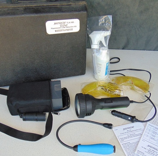

Got a deal on a Spectroline Titan TLK-100 Leak Detection Kit on ebay, looks like it was never used:
- SPEC-TITAN.jpg (110.4 KiB) Viewed 1178 times

Seems that the bulb in the large lamp is dead, they are only rated for 50 hrs.
Ad claimed that the bulbs were good.
The smaller one works since I replaced the CR2 Lithium batteries.
The spray "solution" is to wash off the UV dye, no dye in the kit.
I mainly wanted a lamp and glasses which I got, but annoyed about the large lamp.
