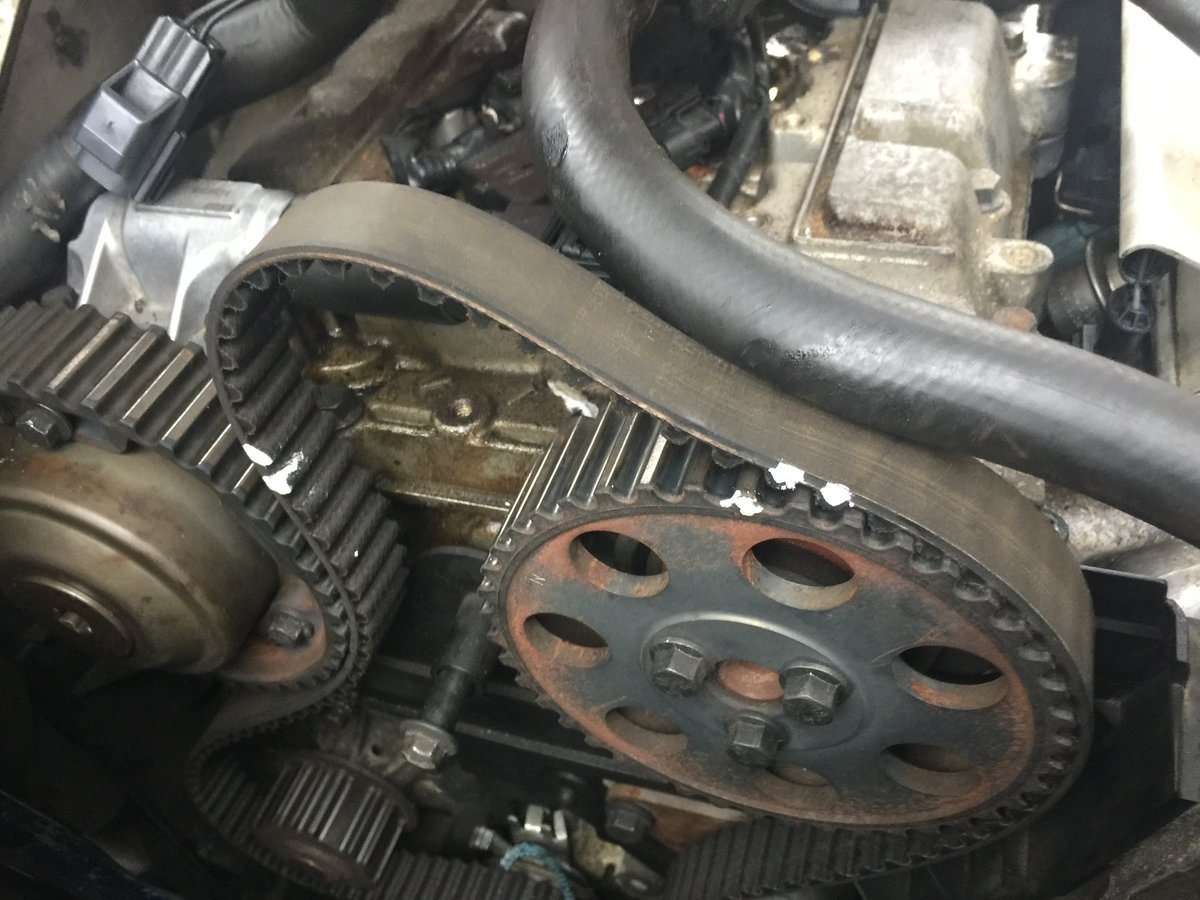

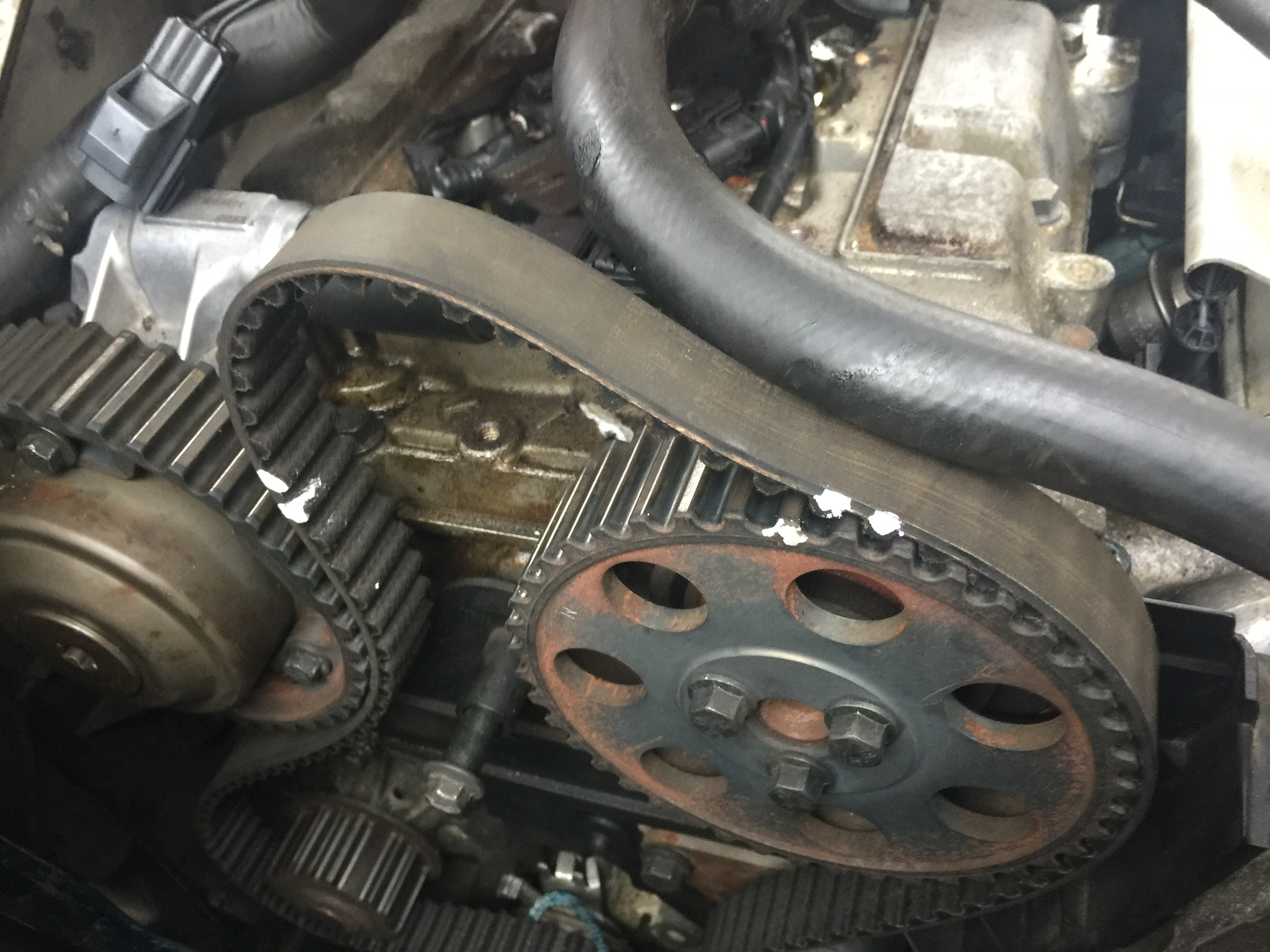

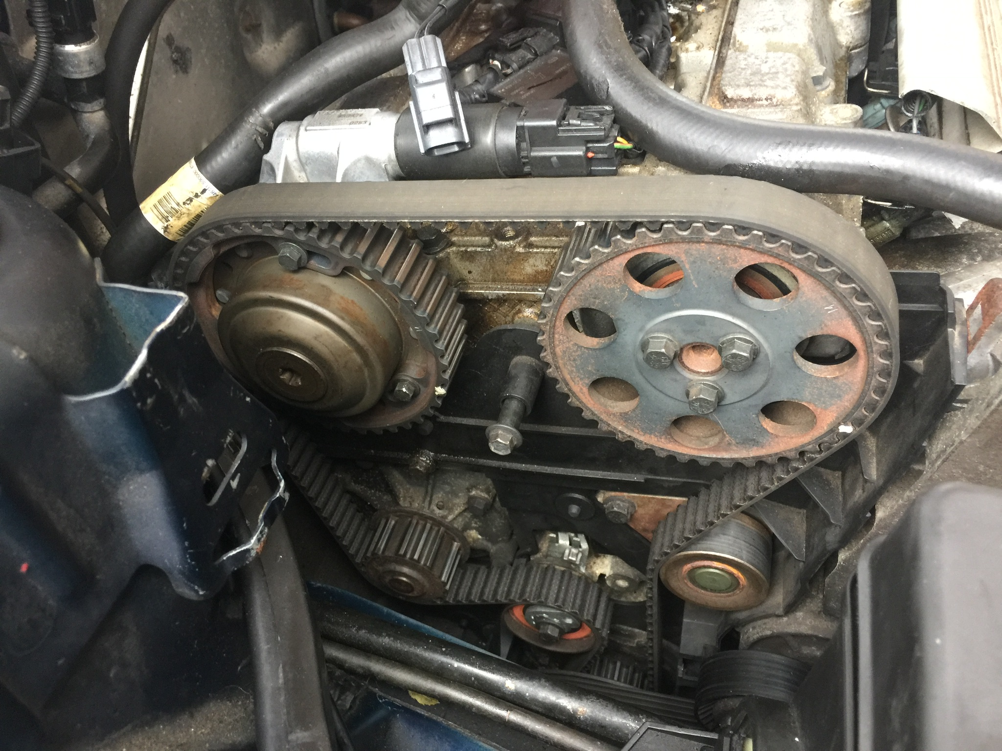

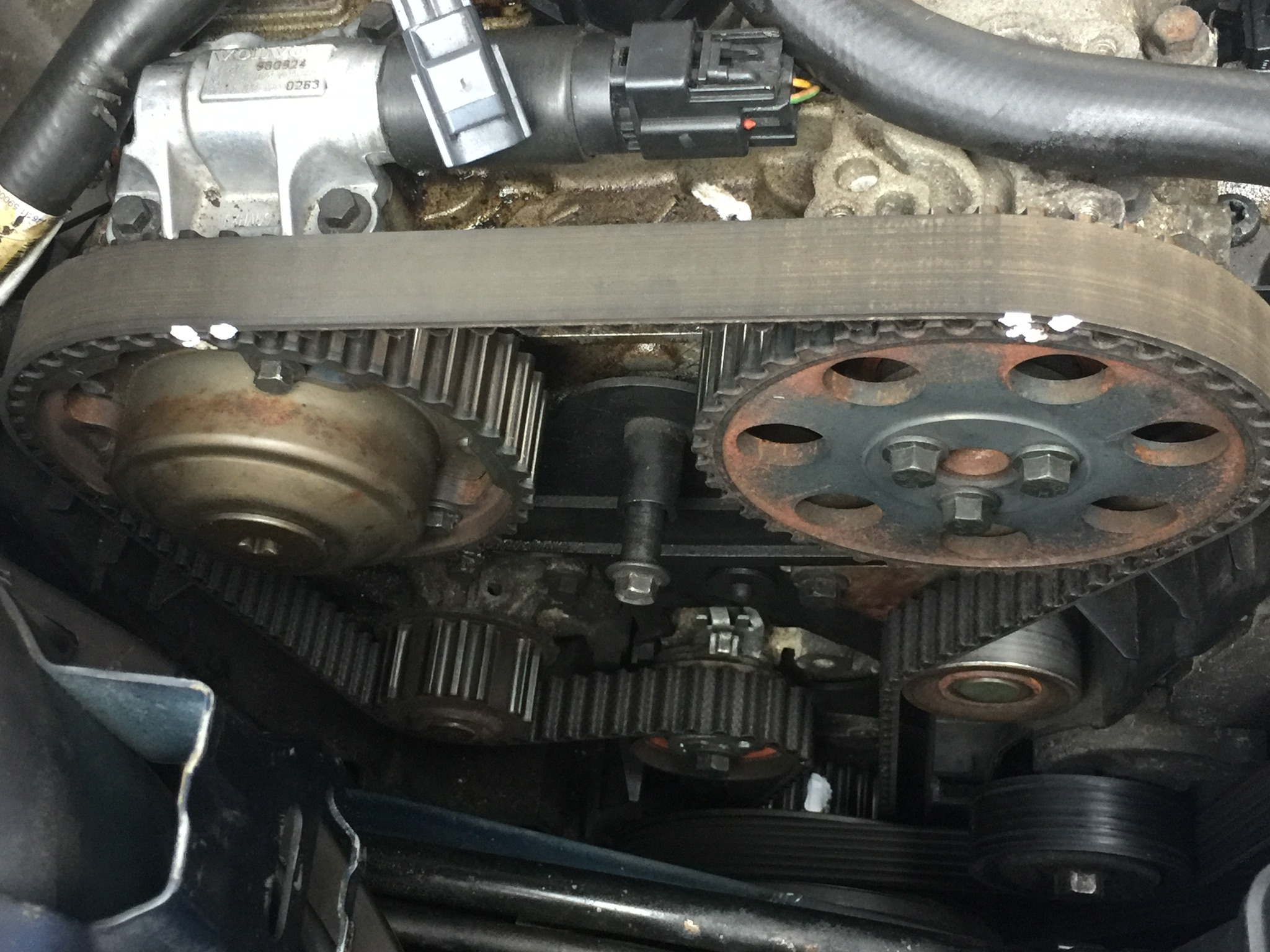

Fuel filter is new BOSCH fuel filter. Fuel pump is NEW BOSH fuel pump. Relay is NEW as well. at this point 3 reputable shops have looked at it and they all seem to think its due to the timing. The car has 76k miles and is the original belt and am getting poo14 even with a new vvt solenoid. So i think at this point i am about to bite the bullet and let someone do the timing belt and water pump on this car and see where it goes if that does not fix the problem i might sell it. I have come to find out that the evaporator needs to be replaced as well. The cars black with leather interior and i live in the south. That is not a job i am willing to take on. We will see what happens after i have the timing belt replaced.

Having just come in from the cold and wet doing this on a 99, if the shop,lines up the marks after preloading the VVT, it will code P0014
Vida says the exhaust hub needs to be set one tooth retarded to get timing right and I found this to be exactly the case
