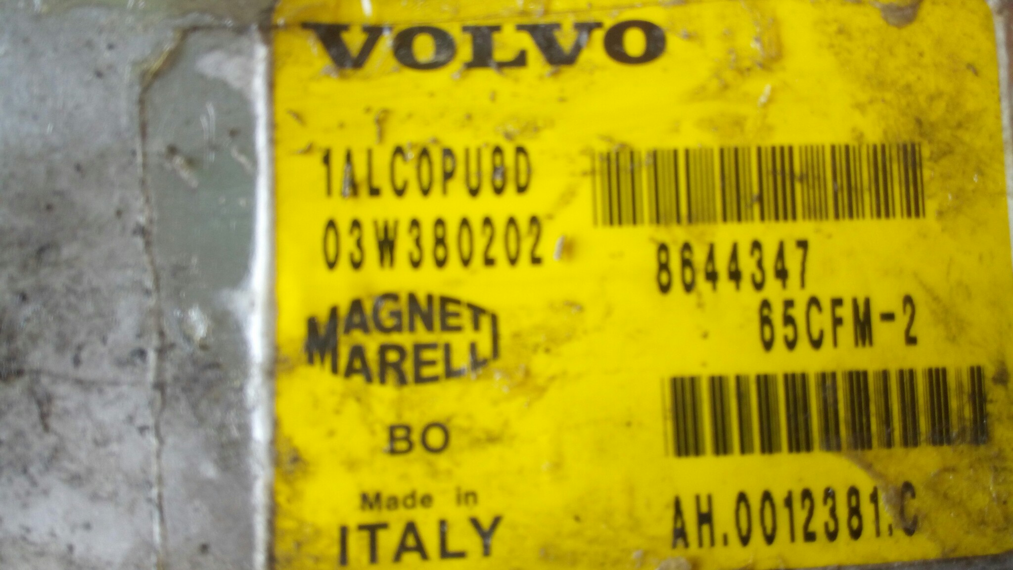

If power to the flap motor died due to a failed board it will still limp with almost zero air getting to the cylinders.
The 2006 software prevented limp home due to one or both of the position sensors not being read properly. The updated software won't help if there's a 12V supply issue, a Canbus fault or an internal ETM board fault.
It's easy to identify whether you have a white label or a yellow label (even if you're color blind)
Yellow label ETMs were manufactured AFTER your vehicle's build date and white labels were manufactured BEFORE your vehicle's build date.
The build date nomenclature is first two digits are year and then the week of build such as this yellow label pictured with 2003 build week 38 denoting a September build. There is also a date stamping on the aluminum body with month and year in a simpler format.
