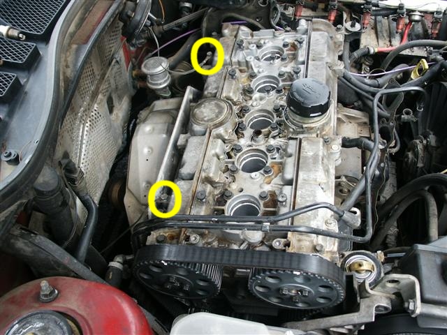

I had this issue once and it was because I forgot to reconnect the ground wires on the back of the head. They sit on the back of the cam cover. There is also a ground wire under the intake manifold next to the lower bolt fastener on the bottom of the intake manifold, but I am unsure if that would cause a no spark coil.
Seeing you were messing with the pcv system going to the back of the engine area maybe you damaged that ground or moved it out of way to work?
Ground wires location.
