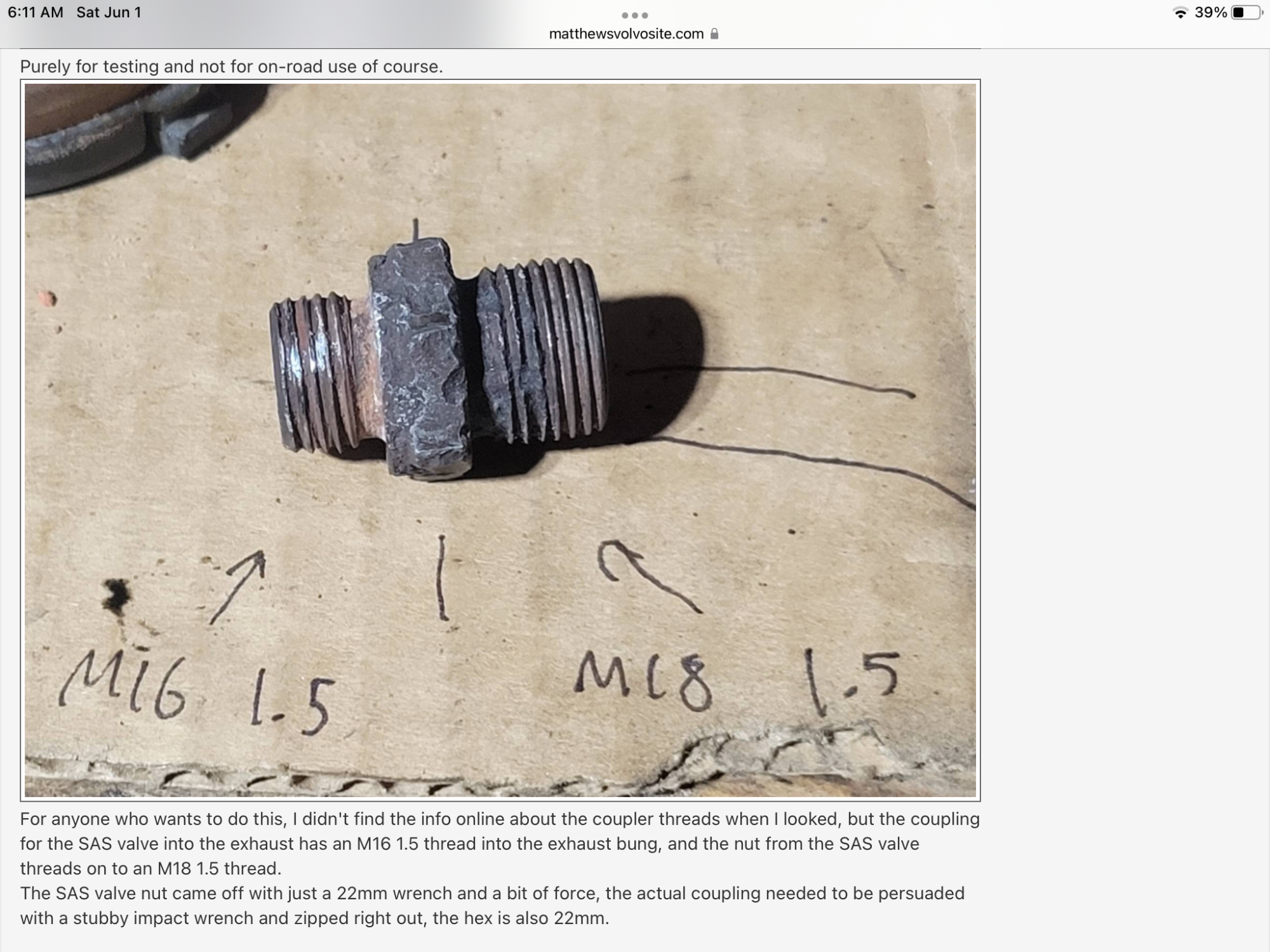

Sas bung measured today
M18 thread 1.5mm thread pitch

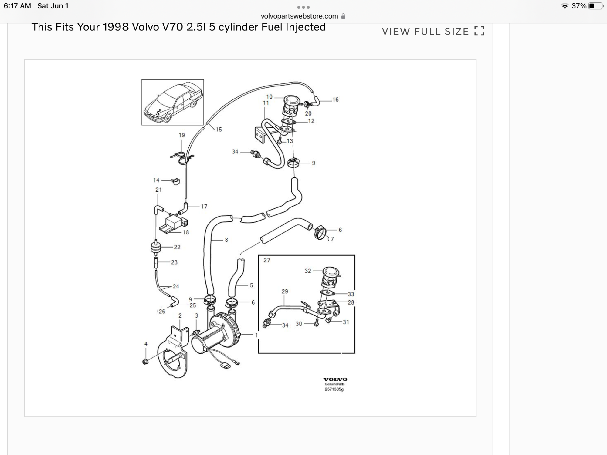

And jrnsis did a nice job documenting the bung on both sides
M16x 1.5
M18x 1.5

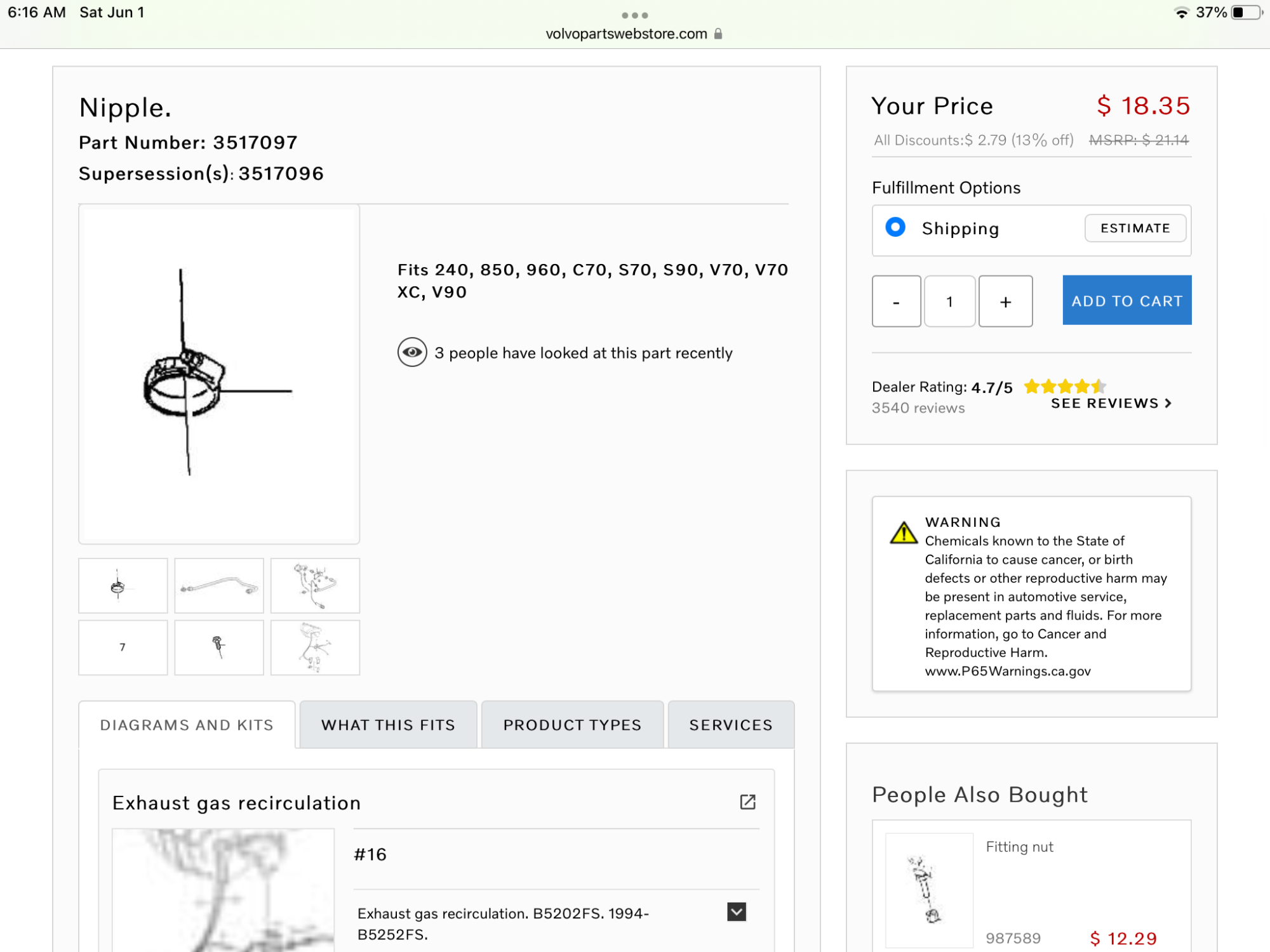

Part number
It’s called a nipple in Volvo-Swede-speak and the picture is wrong but this is it..
M16x 1.5
M18x 1.5
Part number
