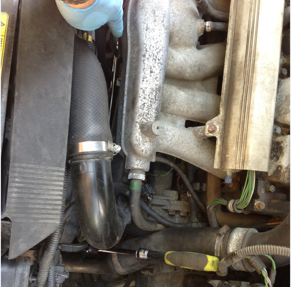

I’ve found you can crack and tighten these with about 30 inches of extender over near the end of the motor.
Use a brand new sharp good quality tooL ( hex or Torx to fit), smack end with hammer 5x to seat , and crack the fastener. Installing is easier , just make sure that oring stays in place with an inspection mirror to confirm

Yes, I found good quality torx bits are absolutely essential. I picked up a set of 1/4" Williams Torx sockets for the job.
https://www.toolsdelivered.com/williams ... c-t10-t30
I would never attempt this job with Harbor Freight Torx sockets!

Well, abscate, you're forgetting the silly hand contortion you have to accomplish to attach lines to the compressor... :lol: (My god that took hours... I can only imagine what it's like for you Turbo guys!!!)
Heres the pic of cracking the Compressor hard line bolts, these can be H6 or Torx, Ive found
Fresh new bit. Harbor Freight ok if it is new.
Long extensions
Clean out head with a pick. Use solvent if its greasy and full of crud. Get it clean!!
Put bit in, smack with 6 love taps with hammer, let weight of hammer head do the work, no Gorilla smacks
Out you come...
Removing compressor bolts
