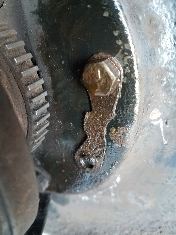

The retainer loop snapped on one of the e-brake shoe brackets while freeing the attaching bolt in preparation to install a new bracket. The non-bolted end had also slipped out from under the retaining tab. See photo. The loops on both the front and rear brackets actually were already bent toward the axle line such that the shoes slid fore-aft with minimal force. Not sure how this could happen if previous e-brake work was done correctly.
PB Blaster and patience should eventually free the bolt for the new bracket. My question is - is this dangerous in the mean time? It's actually not very different from the situation before the loop broke because the shoes were already free to move foe and aft due to the bent loops. This shoe can now move "sideways" but there isn't anywhere for it to go except perhaps to widen the contact zone a bit. Are these parking brake shoes at more risk of locking the wheel while moving? Will they work like this? They don't need to work but they do need to not lock the wheel.
Related, can anyone recommend specific aftermarket brake cables for 1998 V70 T5? Some are 1/3 the price of Volvo branded but some reviews aren't good.

I think the consensus is that Volvo only for the parking brake cable unless you want to get half way through the job and start over.
