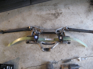

Looking at diagram/descriptions, its part of a stabilizer....I'd have to see this part...it looks like it could be fabricated. Is it broken, or does it have some busted rubber? Click on links
(Bushings closest to wheels) 6819182
(Middle of axle) 6819183
I'm coming up empty here, but this thread should be considered: V90 multilink rear suspension transverse leaf spring anchore
What is the issue with this?
If these parts are removed, can you take photos of them so I can visually see the issue? I assume they have metal frame with rubber slabs?
Maybe this site has part in stock...maybe.
(Near driveshaft yoke at base of differential)6843603

All 4 on the leaf spring seem to have rubber chewed up. I’m not hearing any sound when I drive the car except for a slight clunk when I go over a big pothole.
I don’t have it all taken apart yet. I’m kind of “drained” for the winter on this car I have been replacing a lot of nickel and dime parts since November out in the cold all of which seemed to be on the way out anyway. I’m trying to locate parts in preparation for the next following winter. I am going to try rebuild as much as dried out worn rubber as I can economically . Also, maybe CV halfshaft boots If I can find thick quality rubber ones. I also attached a an image
I’m sorry for the kind of blurry image, it appears that the parts with the Volvo blue label are the ones I am looking for in the middle
