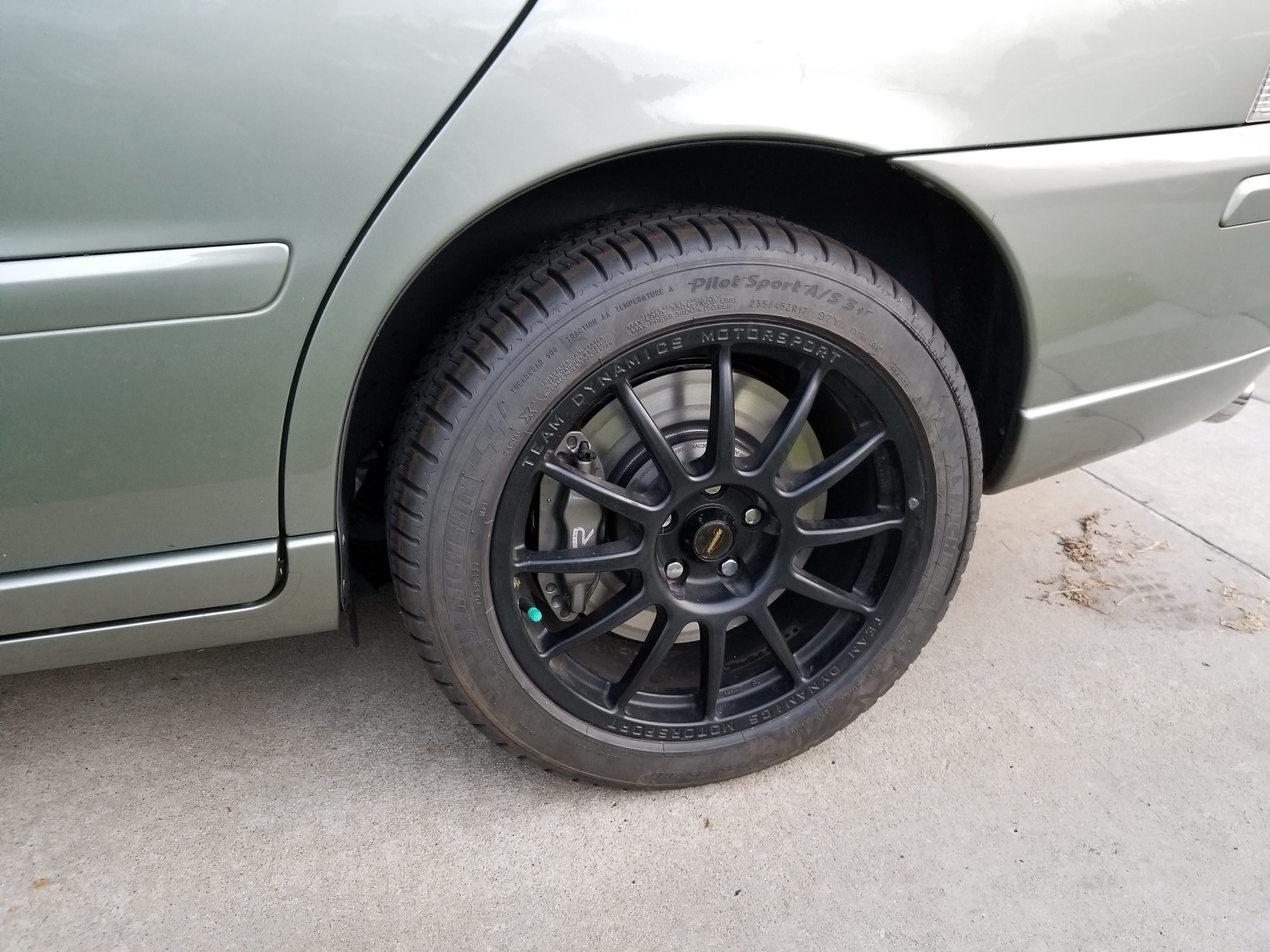

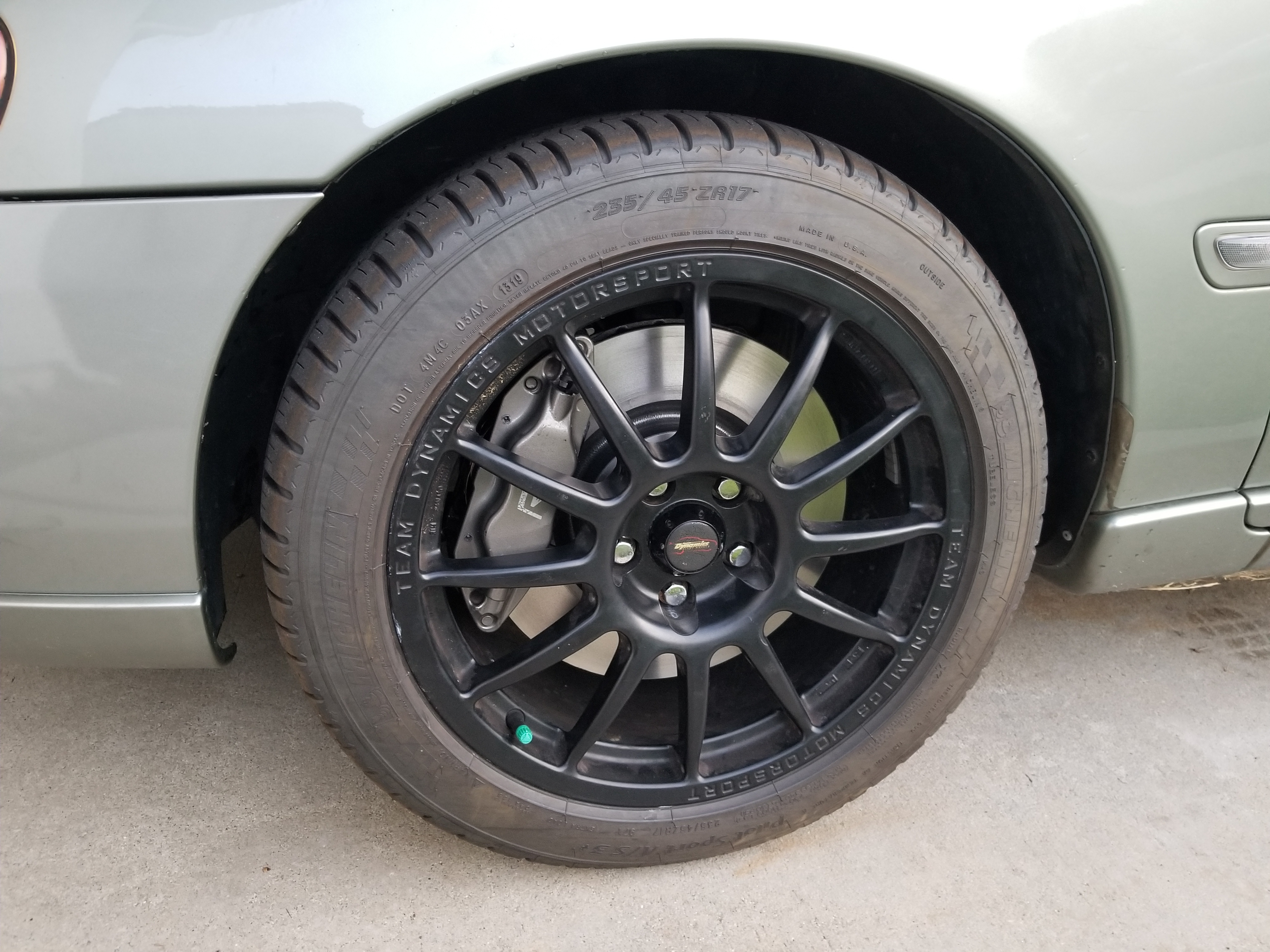

Some pics of R brakes installed and (finally) feeling good, too:
