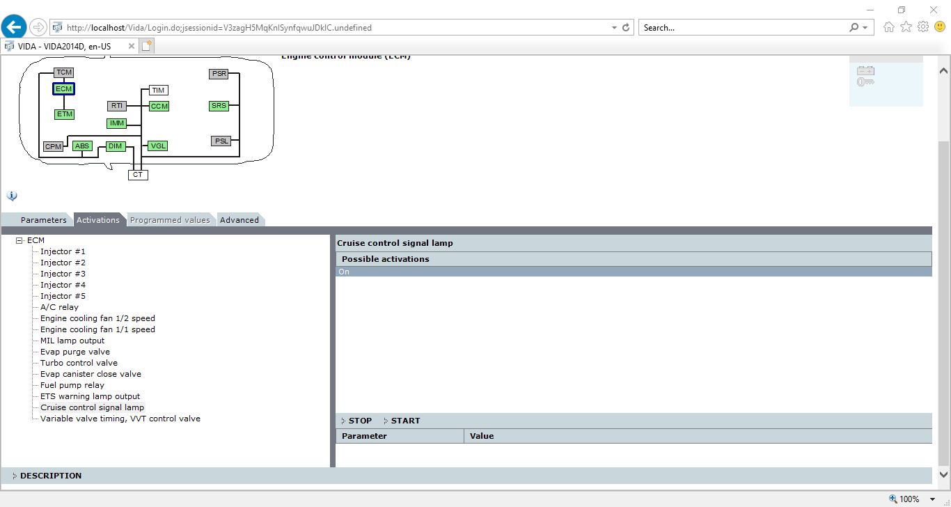

abscate wrote: 16 Apr 2019, 04:39 The only way to troubleshoot your cruise control light on a P80 is ....have it work.
It does not come on with key in pos I or II. It’s the only dash light that does not self test.
Maybe you can turn the light on in VIDA for a 99?
Well -1998 cars don't have a light, but you could probably turn it on with VIDA with '99+ cars. I haven't tried it yet.

Can confirm that VIDA can activate the cruise control light... however it appears mine doesn't work. Shocker... lol

bmdubya1198 wrote: 16 Apr 2019, 08:05
Probably because cruise on ME7 is fully integrated into one unit - the ETM
So how do you know when cruise is loaded, but not activated, on a -1998 car? I thought an indicator was mandatory..

abscate wrote: 16 Apr 2019, 13:17 Probably because cruise on ME7 is fully integrated into one unit - the ETM
I guess they assume you'll just look at the switch! I've always thought it was odd that the older cars don't have a light.
