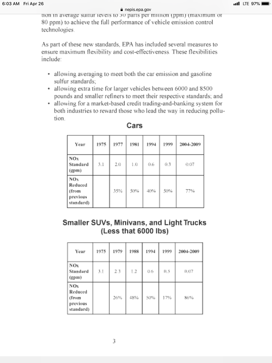

Is that true? I though three way cats, closed loop fuel injection pretty much took HC, CO, and Nox to the flat part of the diminishing returns curve...
What I found quickly was NOX evolved but the rest see, flat
I bet all the improvement was VVT And start up mitigation , too.
