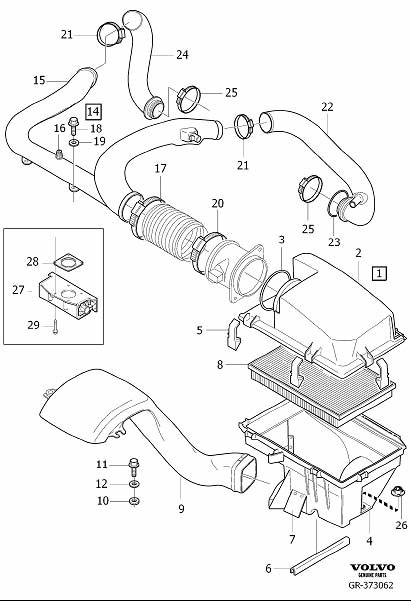

RickHaleParker wrote: 26 May 2019, 19:15
Anybody know where to source the seals for VPN 30636760?
Following, I'll pipe up if I think I can help!
Not sure if this helps, but here is the 30636760 hose, not necessarily the seal...
https://www.fcpeuro.com/products/volvo- ... o-30636760
Or from Volvo:
https://www.volvopartswebstore.com/prod ... 36760.html
Looking at the parts diagram, I'm not seeing the part you posted a picture of...
Roger

Roger_850T wrote: 27 May 2019, 20:14 Looking at the parts diagram, I'm not seeing the part you posted a picture of...
That is what I am finding, $175 for the whole assembly. If nobody can locate replacement seals, I will do one of two things. Build up the seals with RTV or soak the seals in ATP AT-205 Re-Seal to recondition them. Still debating on which course of action.

RickHaleParker wrote: 27 May 2019, 20:22
The seals have no apparent damage.
Where do the seals go? I'm looking at the diagram, and I don't see anything that looks like the picture you posted. If you can point me at where the seals go, I'll keep digging and see what I can find...

Roger_850T
Posts: 351
Joined: 31 Dec 2013, 11:55
Year and Model: 854T 1995
Location: Frederick MD
Been thanked: 26 times
Post by Roger_850T »
Can you point at where it goes in this picture?

Roger_850T wrote: 27 May 2019, 20:45 Where do the seals go?
The red arrows are pointing to the location of the seals. The bulges off the main pipe are just clipped on. I know the diagrams show a different pipe.
Hum, I never checked the bulges for a separate part number ...

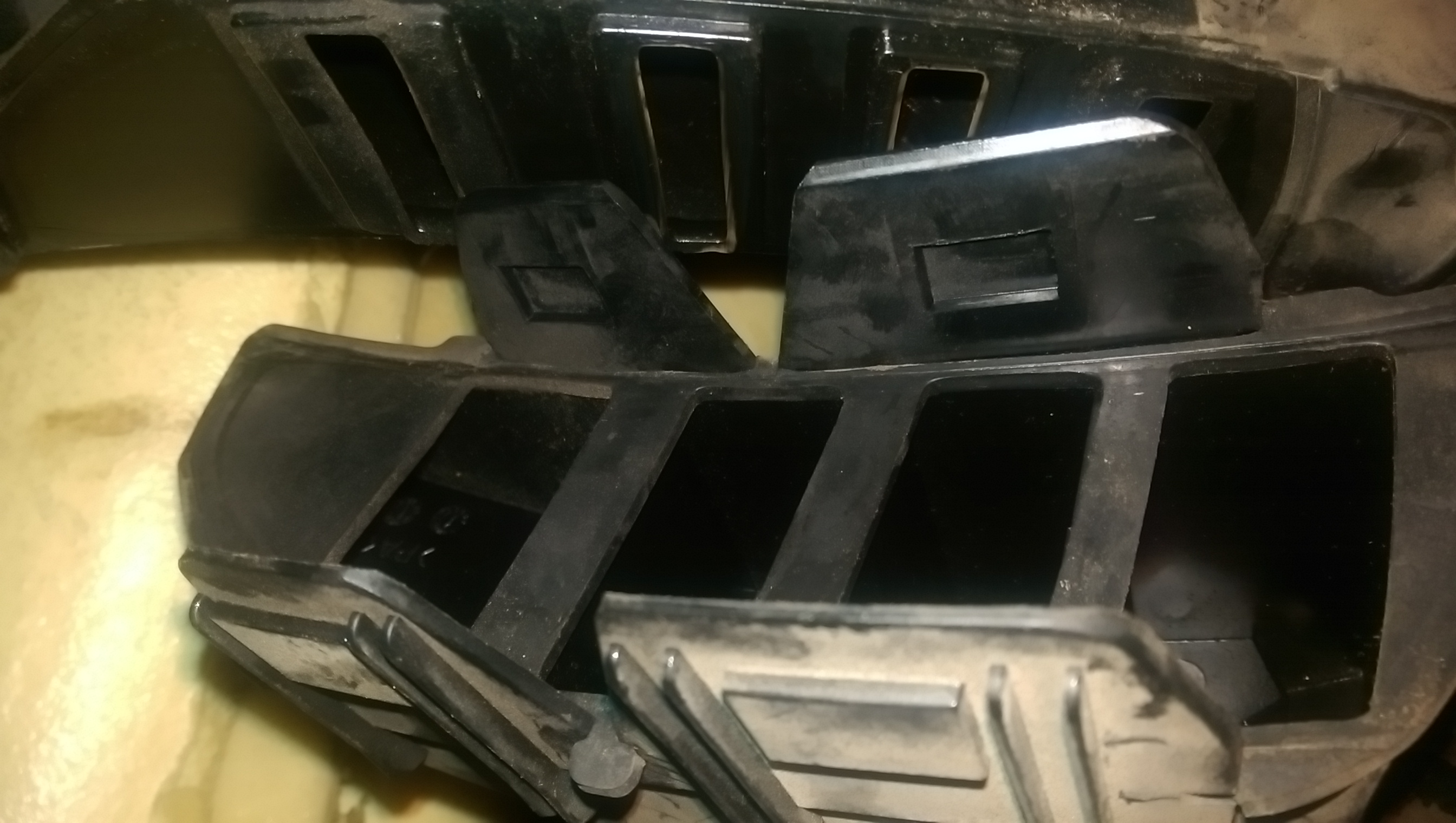

RickHaleParker
Posts: 7195
Joined: 25 May 2015, 14:30
Location: Kansas
Has thanked: 8 times
Been thanked: 977 times
Post by RickHaleParker »
No separate part number for the bulges.
Picture with a bulge unclipped and the seal in place. Looks like resonator chambers or reservoirs.
