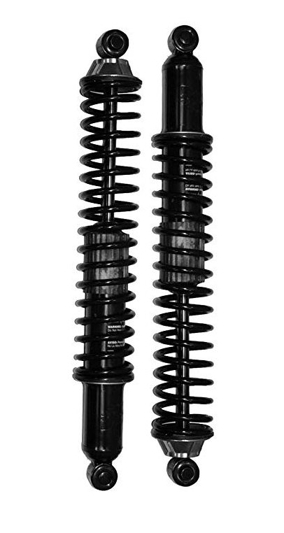

I think I also mentioned this in a recent post about the difference between a strut and shock. I originally questioned whether the eBay seller was selling Nivomat parts to go with the Nivomat suspension? IPD shows and describes the Nivomat as a shock and not strut and it does not have a spring perch.
Again, a strut is part of a McPherson Strut Assembly by design so it will always have a spring perch. The only exception is a shock with a "helper" spring.
Shock Helper Spring.png (146.45 KiB) Viewed 1196 times
I have not seen a complete Nivomat suspension but from the looks of the lower attachment point it is inside of a spring rather than sitting outside. As for the eBayer if those parts are for the 04 XC70 than the description is incorrect.
