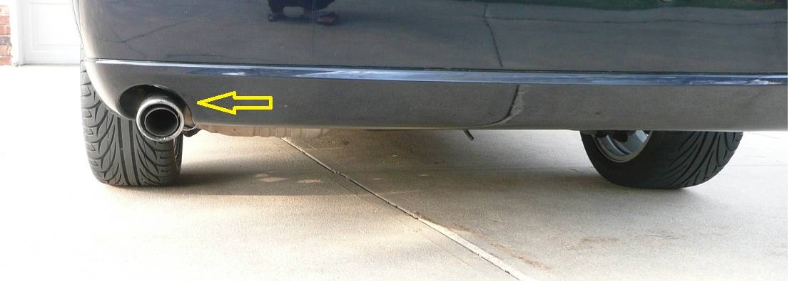

UPDATE on my 2007 S60 2.5T...
- The tail pipe broke off bc the P.O. allowed the middle hanger to break (not his fault, just mfg "defect").
Once the middle hanger broke off, the entire rear system (piping + muffler) relied on the rearmost bracket to hold it.
So, wherever the weakest link was, it broke. In this case, the part where the tail piece joined the muffler.
- Bought a "sleeve" from local O'Reilly for $4.00. The I.D. = 2-1/8", and O.D. = 2-1/4".
- I drilled a hole and used a sheet metal screw. Hole not big enough (might have been 1/16" or whatever), so the
Sheet metal screw broke off, leaving the broken part behind. Worked out perfect bc it kept the sleeve inside the tail piece.
In retrospect, I did not have to do this step bc the muffler shop welded it.
- Went to muffler shop (local Midas was very nice). The shop charged me $40 for the welding job.
MIG welding, battery cables never disconnected: they have never removed battery cables in thousands of cars
over the last 30 yrs. I did not want to appear OCD, so left battery cables attached, no issues afterward.
- So all in all, this whole tail pipe saga cost me some ~ $55.00. About $15 for the hardware (the corner piece and bolts/nuts, see my previous post $9, this sleeve $4), and welding cost $40.
- The muffler shop told me this fix should give me another 4-5 yrs. Good enough for me.
- Some photos...
