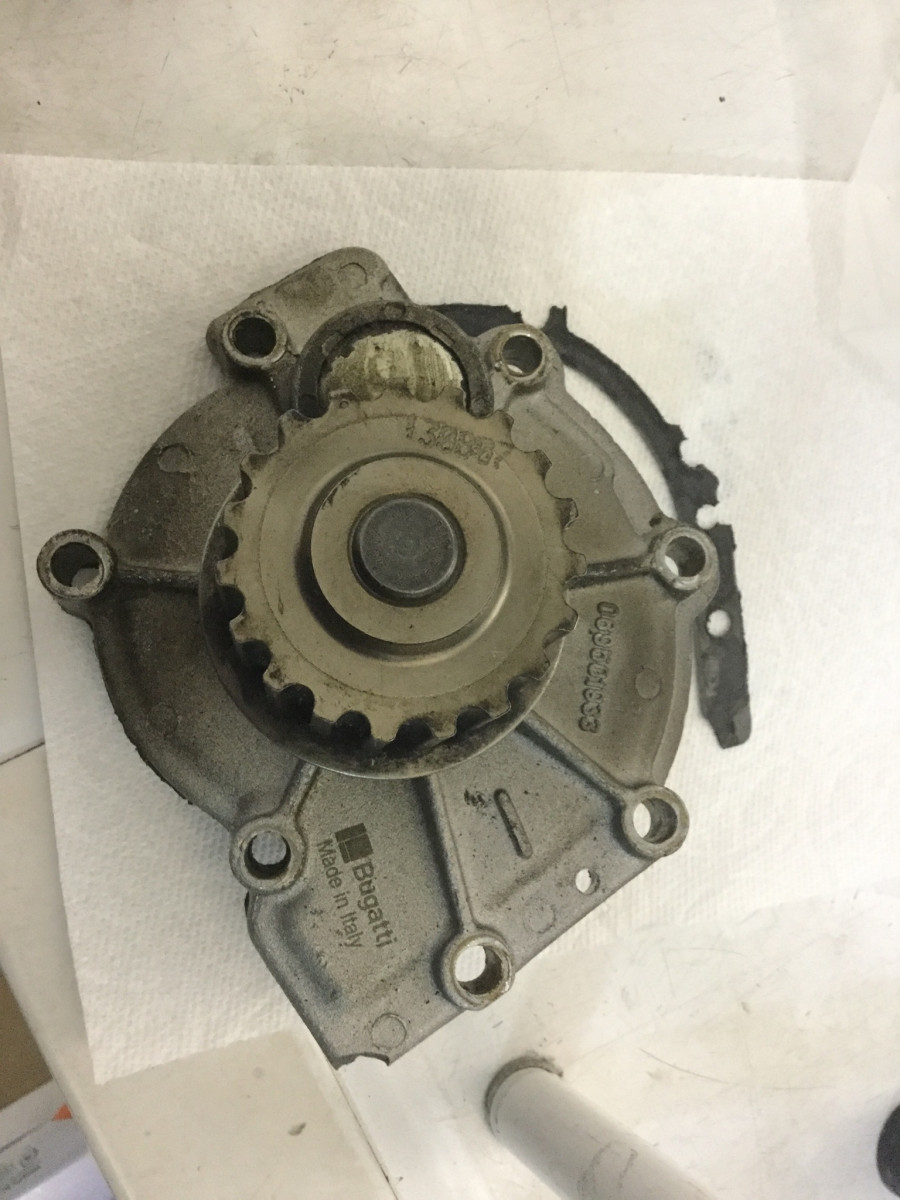

Started on resolving this oil leak. I have replaced the oil pump seal and gasket, but this was not the source of the leak. Replaced the water pump. A Bugatti water pump was installed by a repair shop together with the timing belt @120k. It was not leaking and the bearing was still in good shape. But per recommendation replaced with an Aisin water pump.
The rear seals where not leaking but I will replace these in the last step.

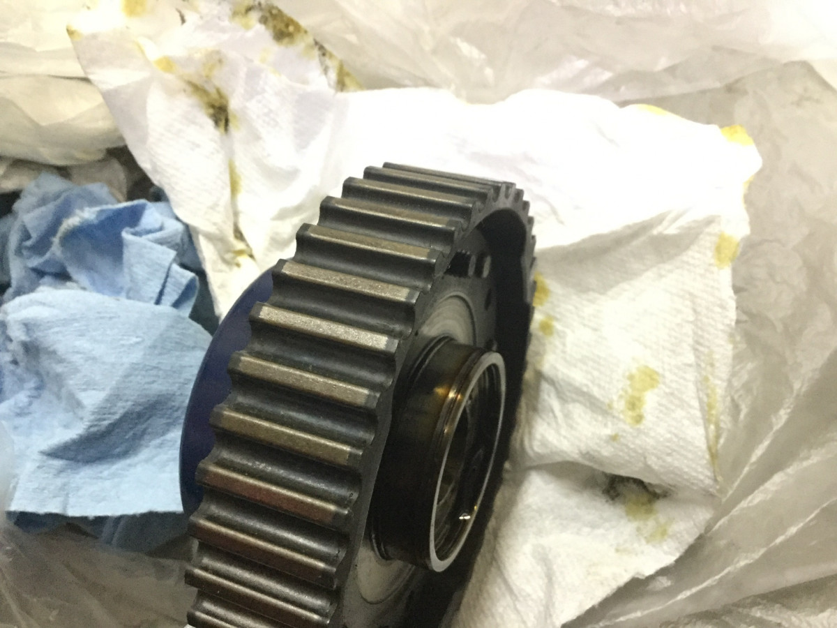

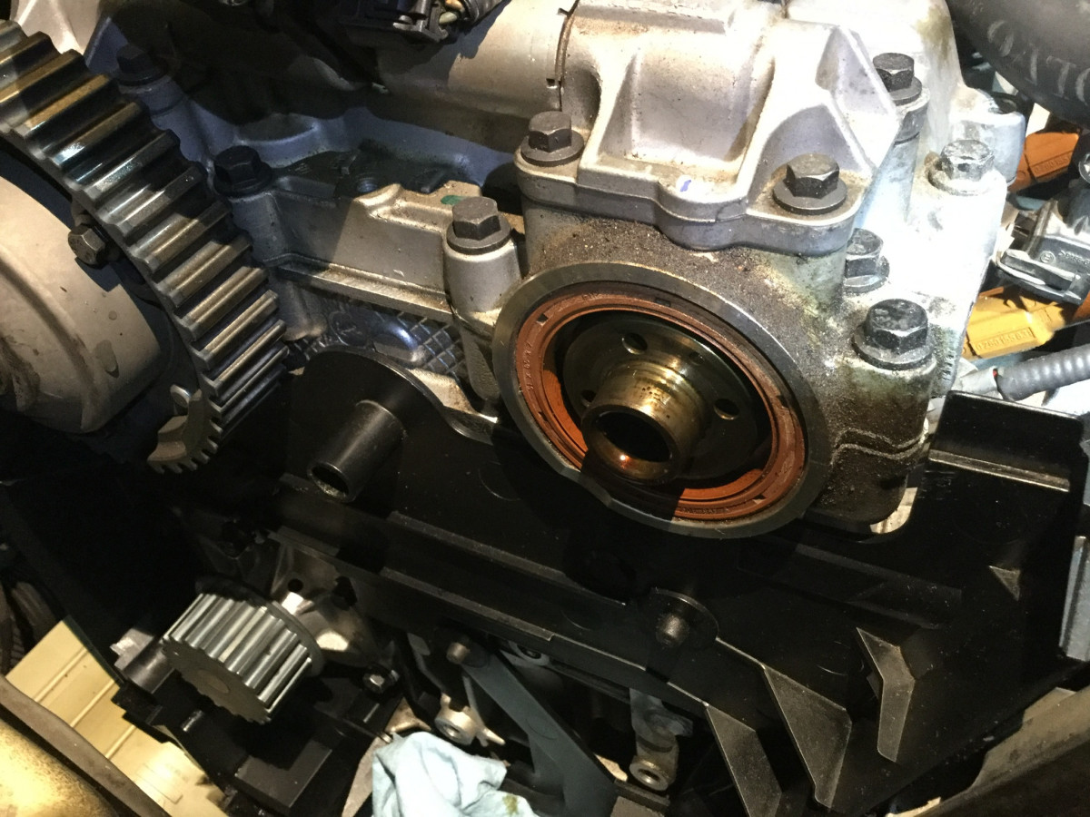

The source of the leak is the intake hub. I measured the play of both hubs, while still mounted. Intake hub 2mm & 1.5mm Exhaust hub. Replaced the internal o-ring of the intake hub with one from FCP, it fits well, old one was hard and not pliable.
I measured the play again while removed with calipers and the play is 3mm.
Now that all the parts are removed It makes sense that the hubs start leaking with play over 1.5mm when looking at the attached pictures. I measured the outer edges of the running area of the inner seal and it measured about 1.5mm. Anything over and the seal starts riding on the chamfer of the vvt hub.
(Timing belt cover already cleaned in the pictures).

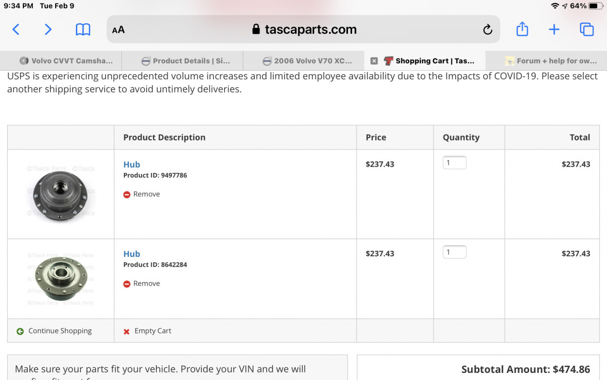

Now debating to reuse the hubs and mount the inner seals flush the allow for more travel of the hubs or source new hubs.
Tasca has the best pricing I have found so far.

That’s interesting that Bugatti ( car company or just coincidental) makes a water pump that fits Volvo’s?
