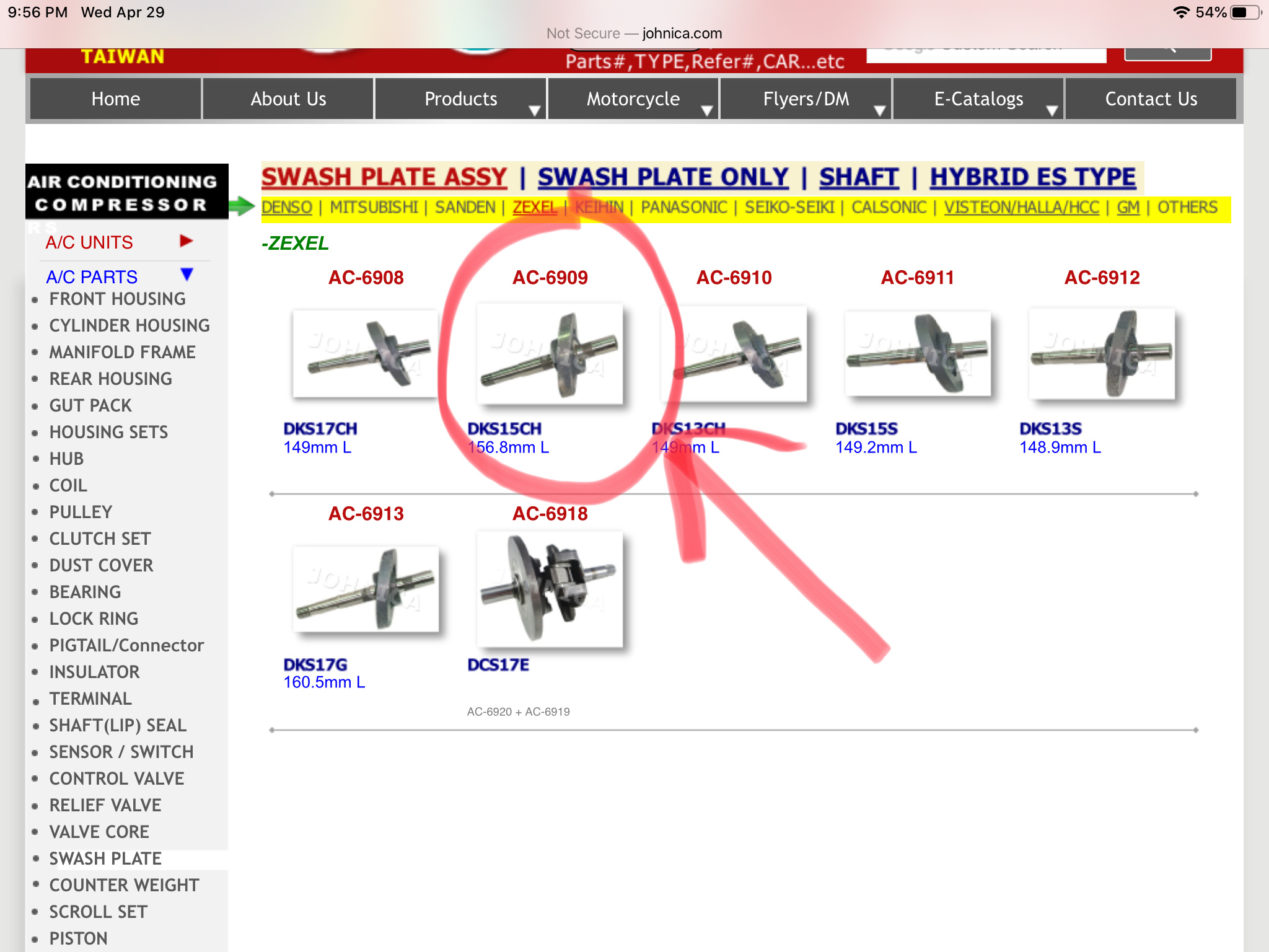

DKS15CH is the Zexel model number. Use DKS15CH to search for parts. You can find Santech parts for a lot less.abscate wrote: 28 Apr 2020, 20:00 That front seal is the hard to find/ expensive part.
1/4 the cost of a new compressor
DKS15CH uses the same front seal as DKS13G & DKS15BH.

From Johnica.com in Taiwan
I wonder what these cost in low quantity? I could refurbish this 1999 2000 AC for under $50 it’s worth more than a junkyard one.

Front seal is Santech MT2043 you can get one at Autozone for $12.99.

I’d buy a few swash plates, if there’s a minimum order from Taiwan.

I’ve sent an email to Taiwan to see their distribution model850oldschool wrote: 30 Apr 2020, 10:35 I’d buy a few swash plates, if there’s a minimum order from Taiwan.
I have another AC compressor which is growly that I can recondition
I think sharing shipping costs will be the key. It’s about $100 to bring an small package from Taiwan to US
