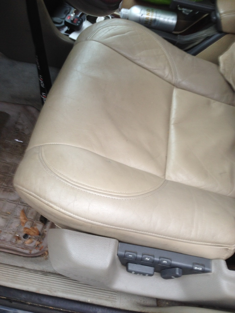

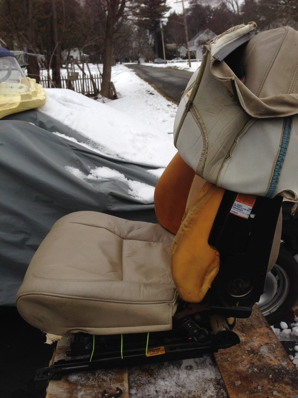

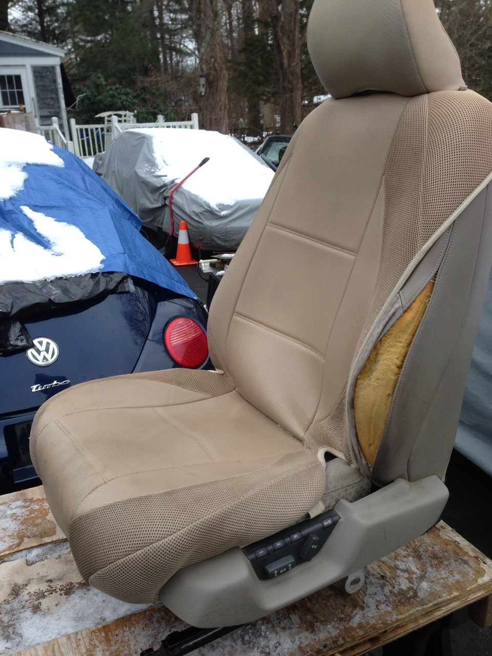

I love all my leather in the P80s but worked on my first all cloth interior this year. That’s a really nice cloth and very high end.
Without kids or dogs I would like that in my cars.
Abbys Evita had the cheaper vinyl/ cloth mix, tastefully covered with Greek seat covers, but I’m halfway through replacing with nice C70 leather
