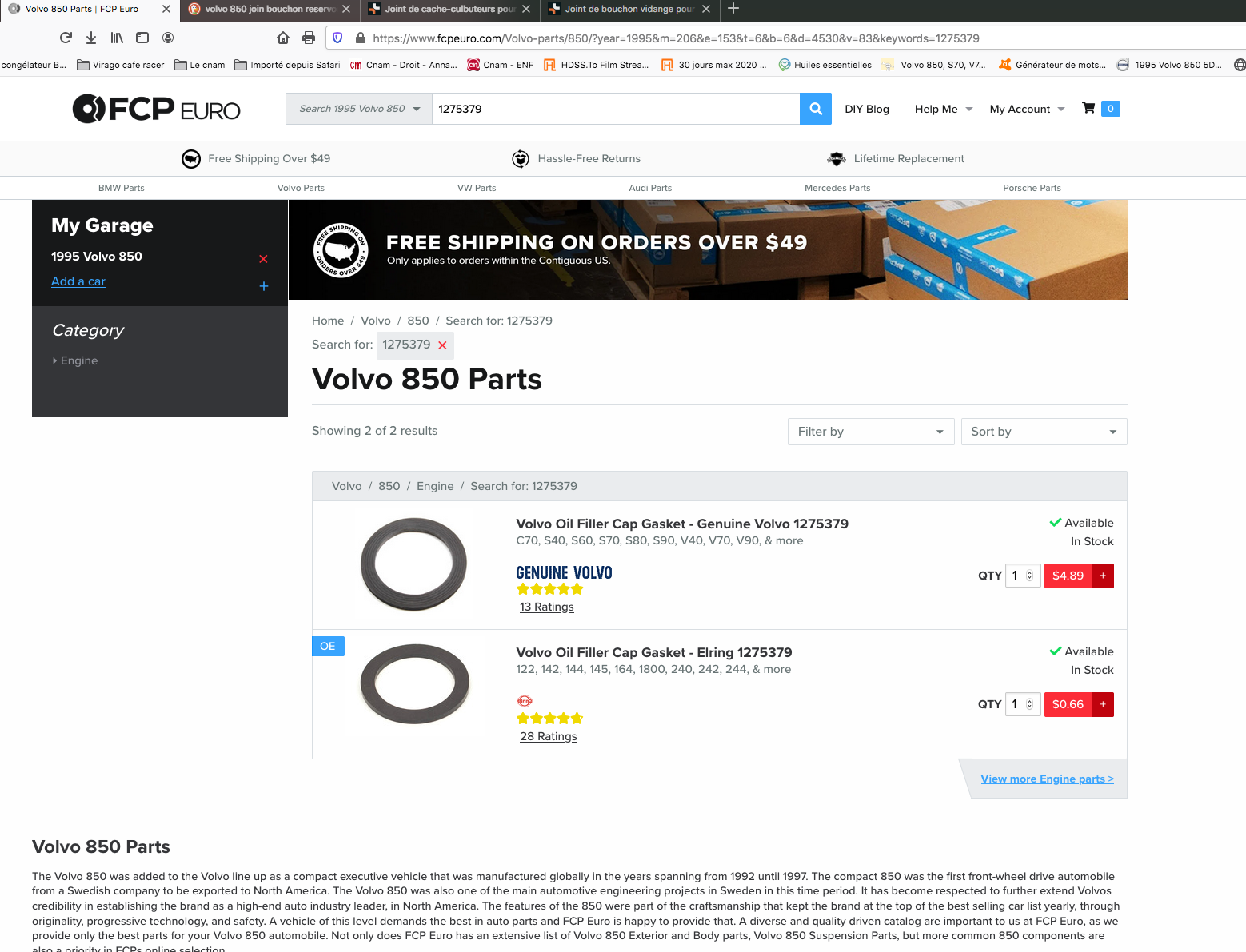

SomeGuy537 wrote: 27 Dec 2020, 11:13 There's oil under the spark plug cover i might add.
Known issue with 850. It can be solved by changinging the cap seal.
Manov

manovlov wrote: 28 Dec 2020, 02:50
Manov
Seems like a cheap and simple fix, i will definitely give it a go!
