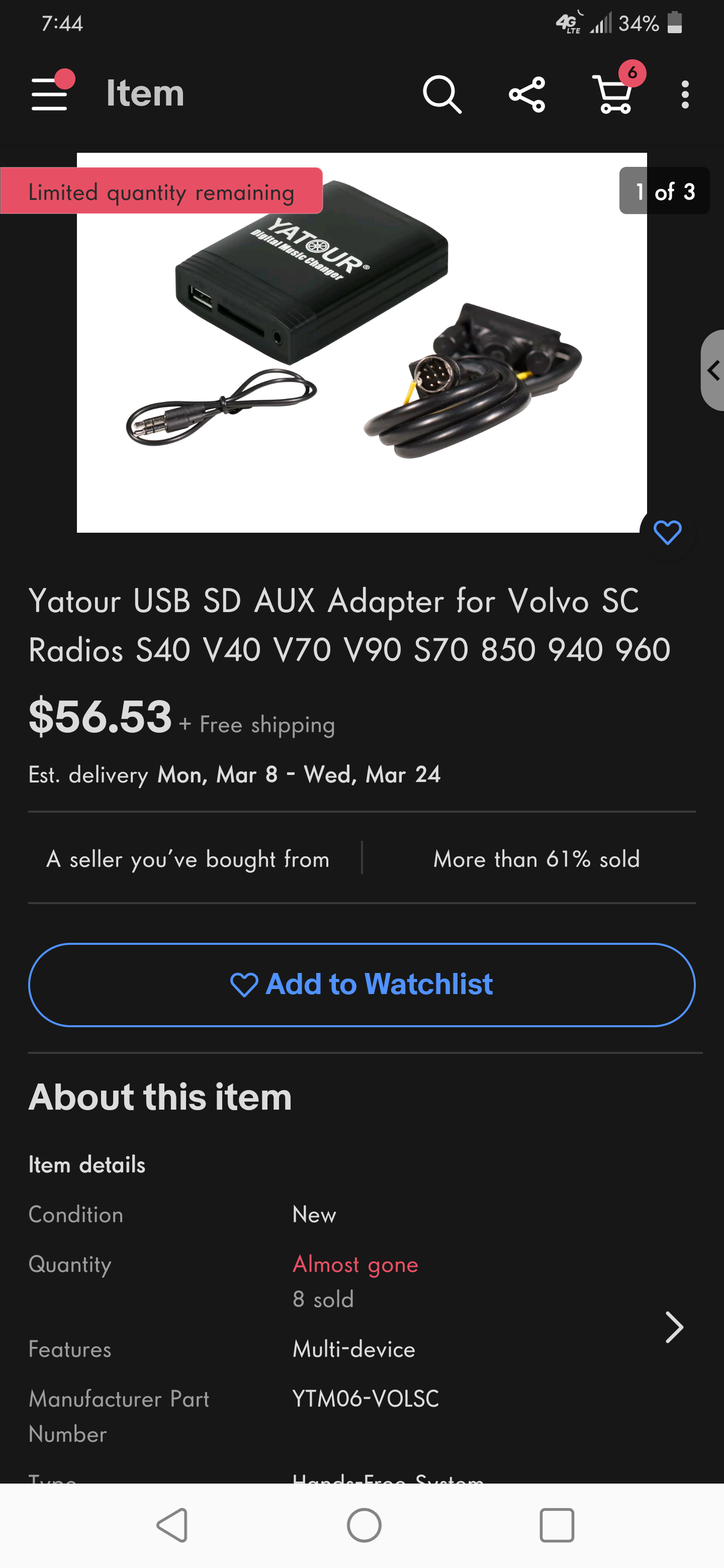

Your best bet might be this. It's AMAZING. You'll need to adjust the equalizer on your phone because sound quality goes down by 10% or so. But its nifty! Love it! This is on ebay but you might find it on Amazon too. I got this for my 96 960 because the CD changer quit working. Use the aux like you would with a modern stereo.wrybread wrote: ↑10 Feb 2021, 16:08 I just did the line in mod to my sc-815, and it sounds very distorted. And on my previous car I never had any luck doing it with the sc-816.
I used the instructions here, connecting to the rear of the tapedeck on my sc-815:
http://atthetipwebs.com/technologyinstr ... eo_mod.htm
And interestingly my phone doesn't detect that it's connected to a stereo and doesn't enable it's output. That's true with both the sc-815 and sc-816. And devices that do work with it sound absolutely terrible.
I triple checked my work, there's no solder bridges, I used two different cables (one a shielded rca), but still no joy.
Stumped.

Yatour is what i am trying replicate kinda and if i can send some custom messages and command my phone music player through radio next and previous buttons like super lazy person i want to be (actually just too poor to buy ready solutions).
