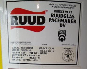

Way, way overdue! Mine was 07/06 and it gave out in April. Warn two neighbors and theirs went back to back last week. Crawl space, basement and garage were the locations.
