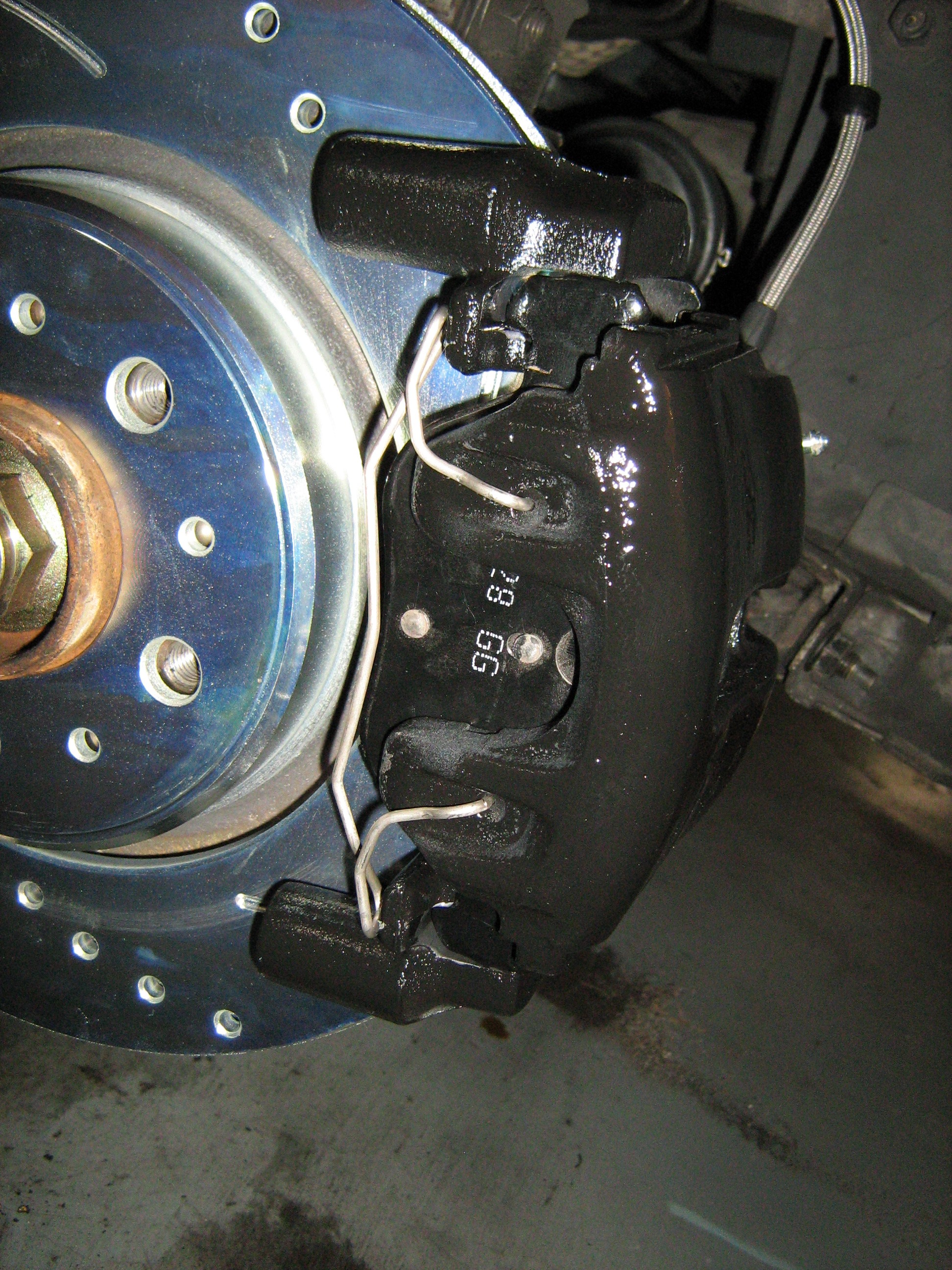

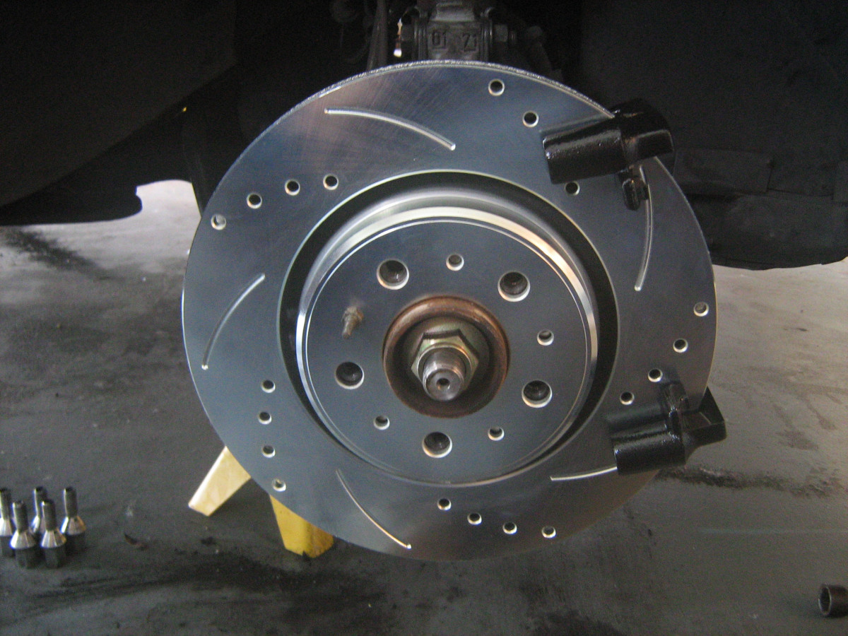

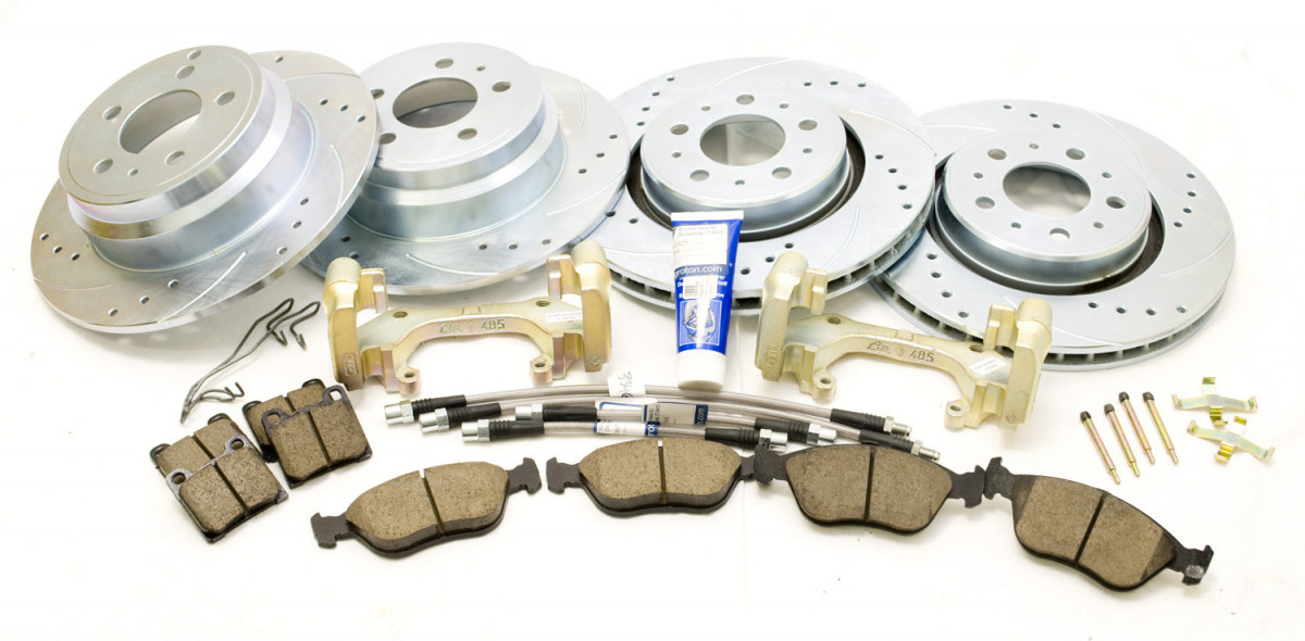

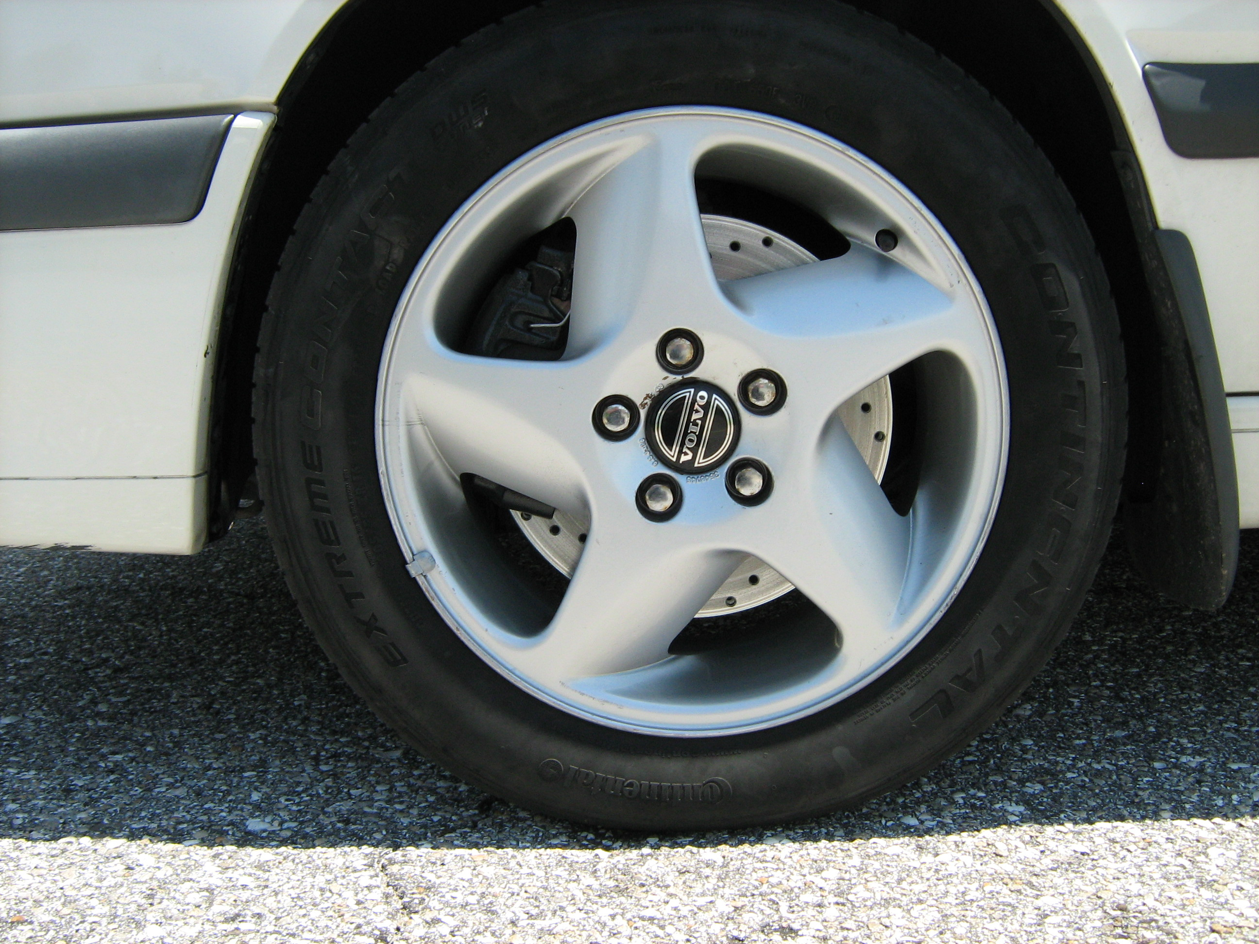

Back in 2012, I upgraded my brakes to FCP's 302mm brake kit. If I remember correctly, the kit uses the front rotors from the P2 V70R, or at least rotors meant for that application. Technically, it's not supposed to fit the 850 with the 16" Columba wheels that came stock on the Turbo.FireFox31 wrote: 09 Sep 2021, 23:27 My rear calipers look terribly rusty but they operate almost perfectly. I would like to rebuild them to ensure functionality and repaint their exterior to prevent future rust.

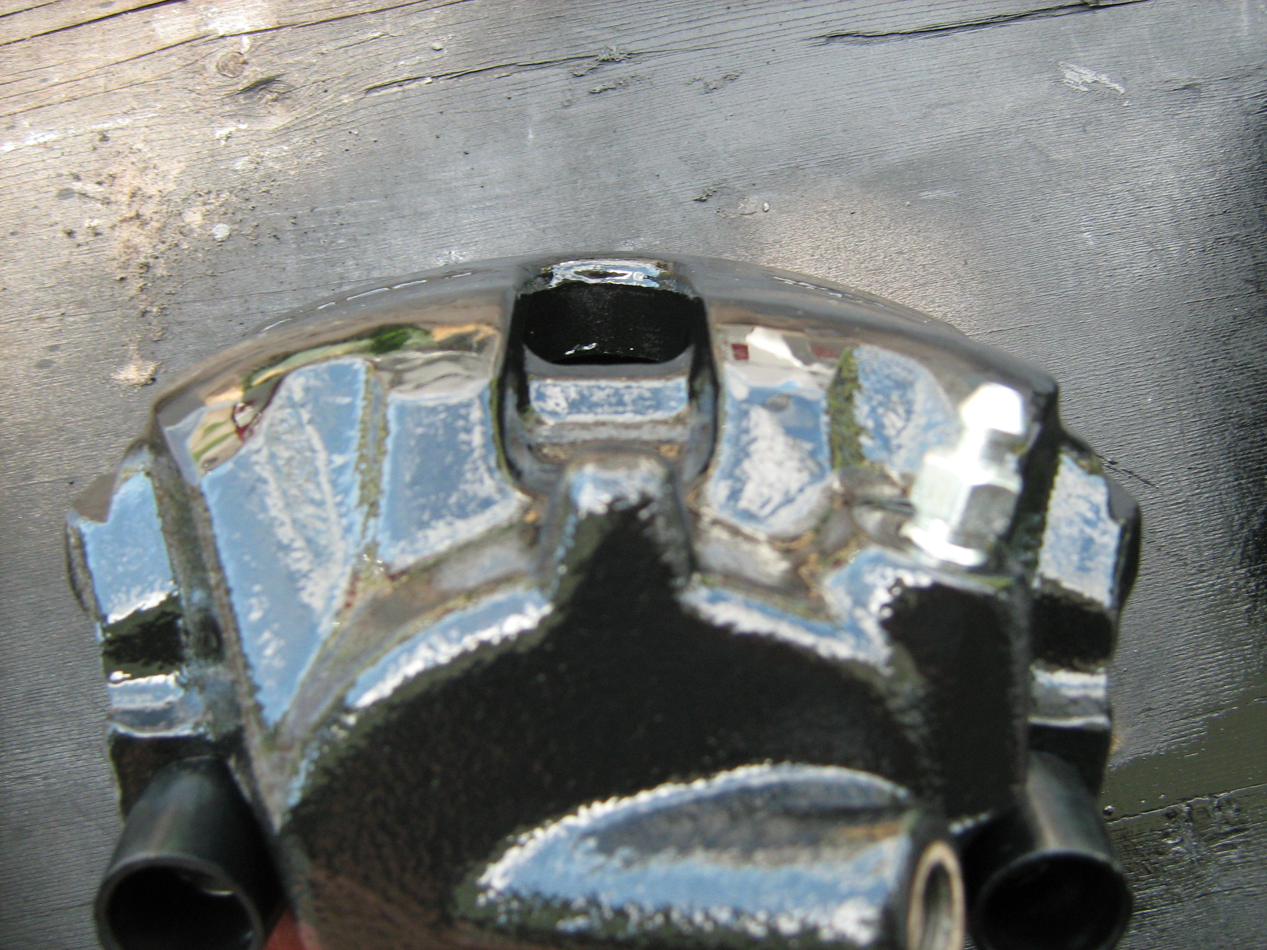

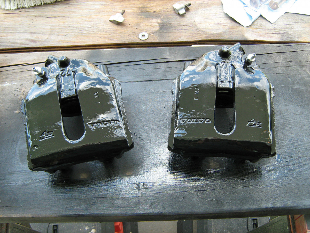

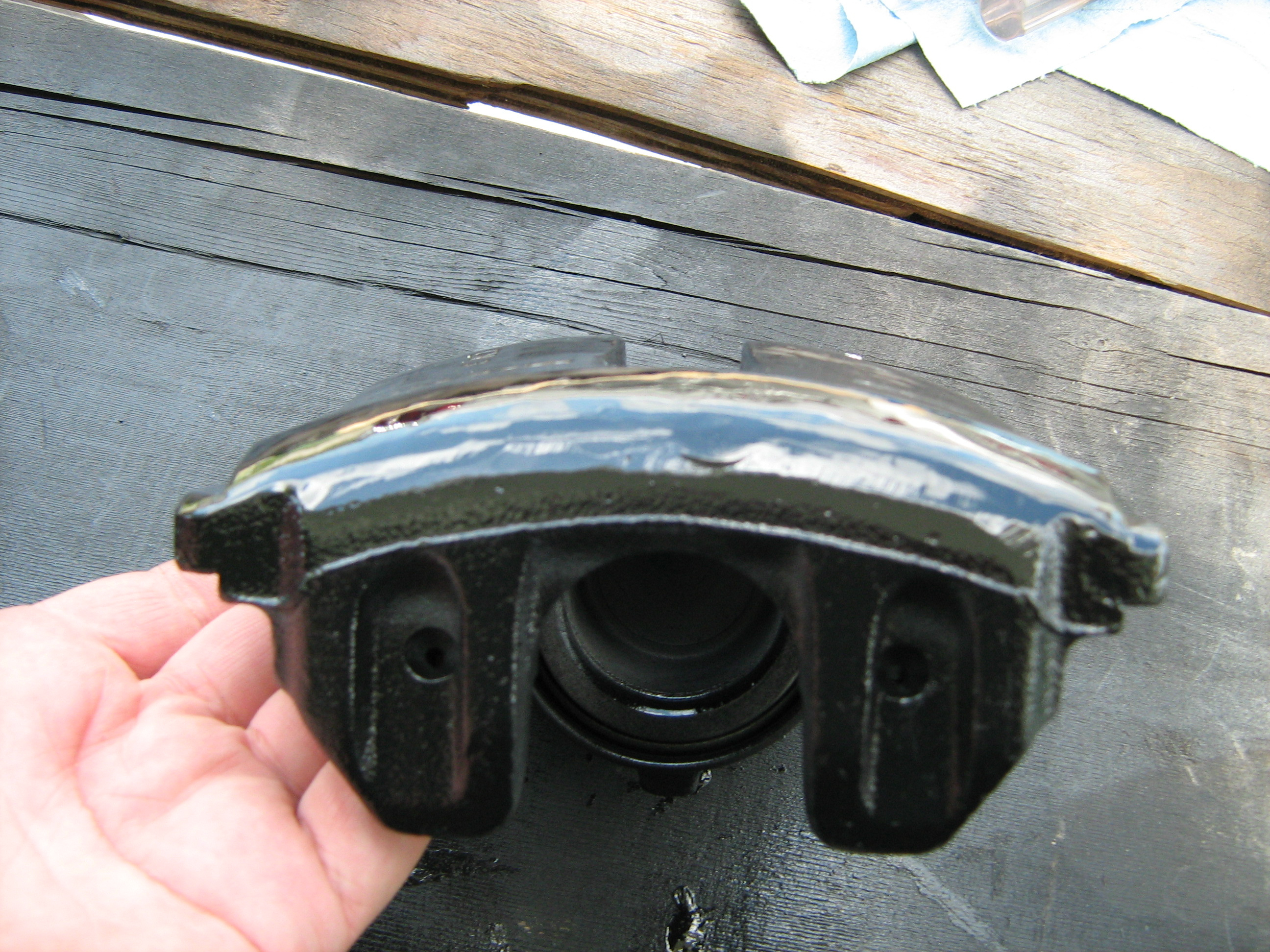

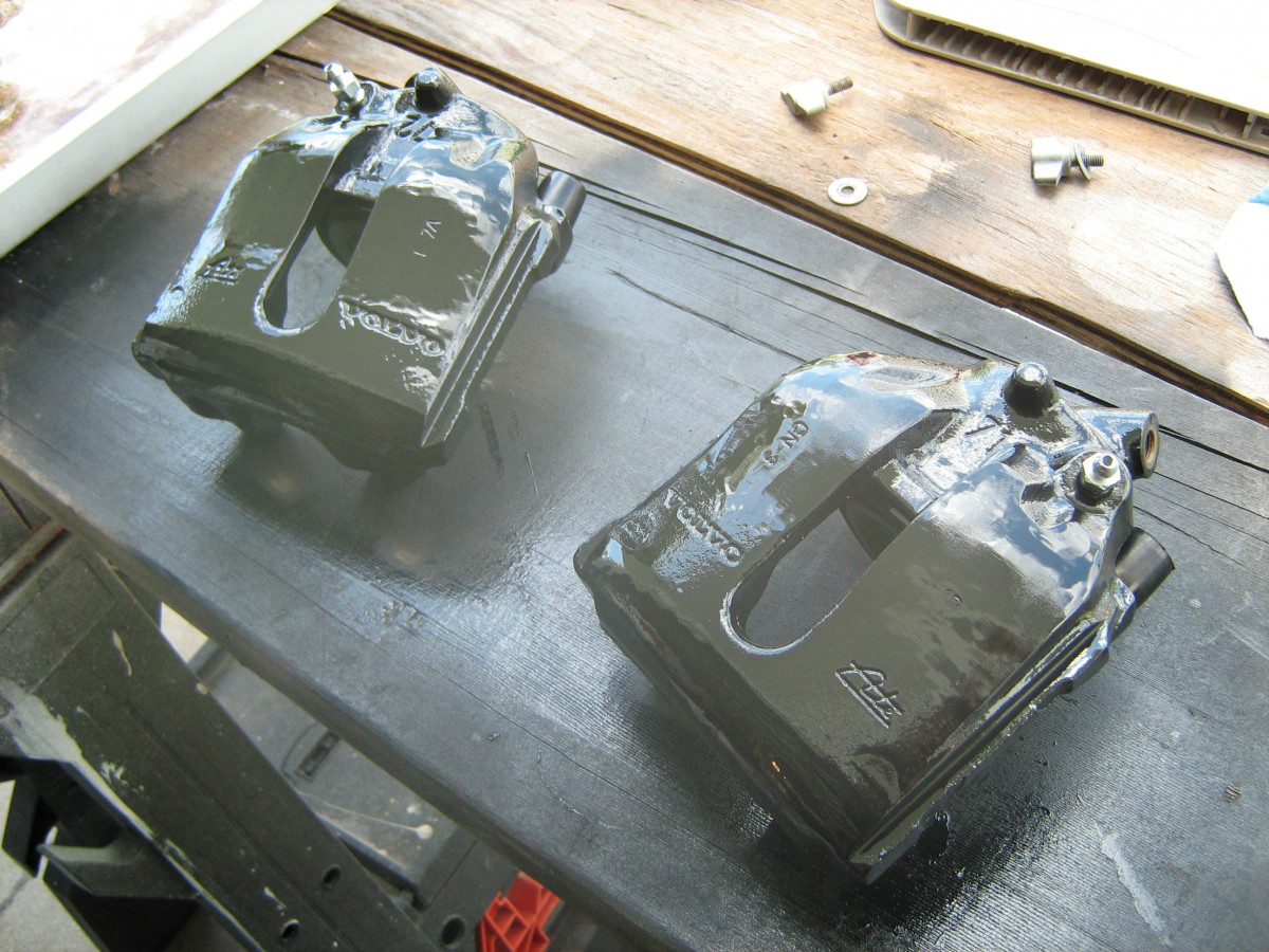

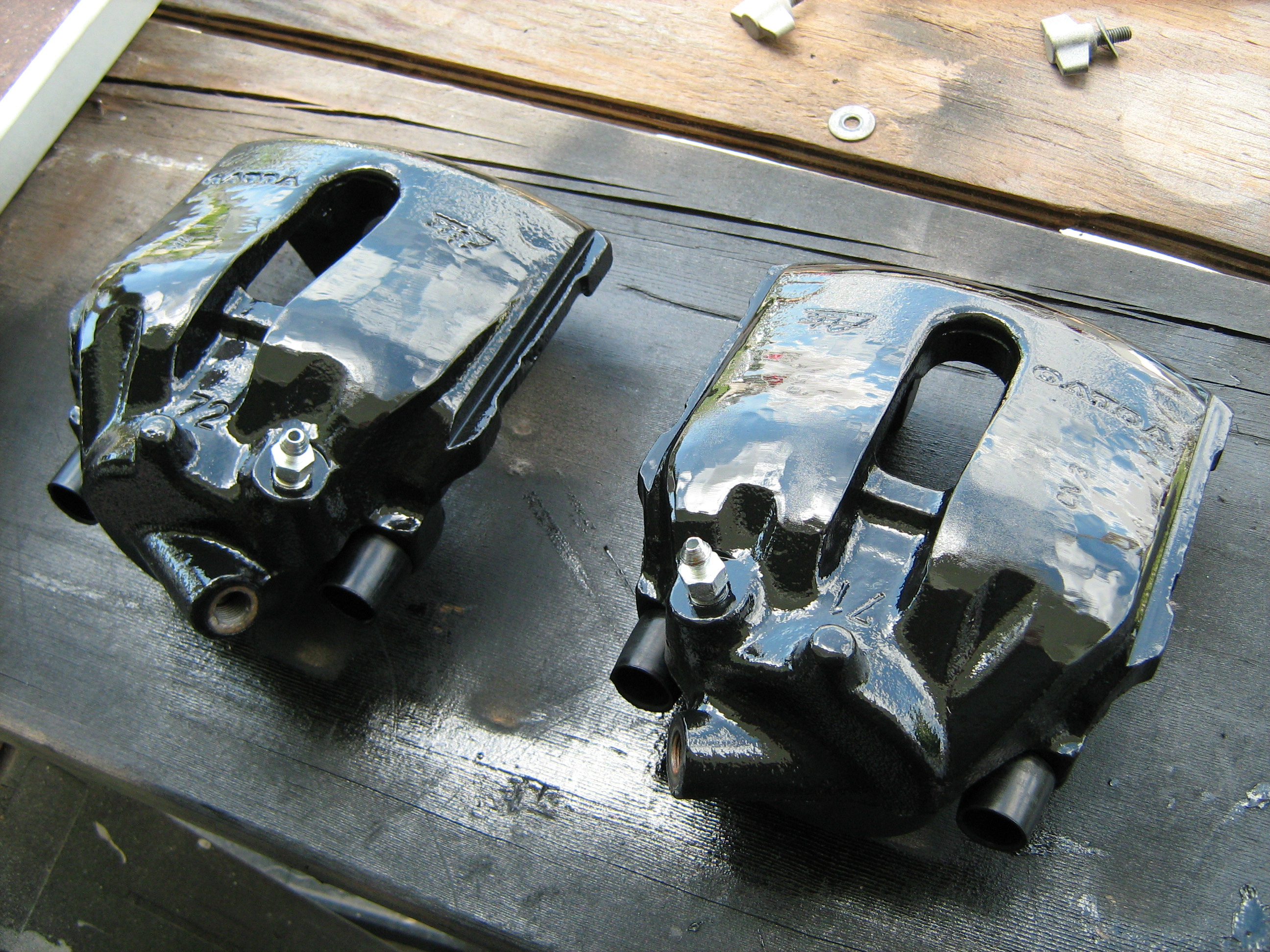

Has anyone repainted their old rusty brake calipers and want to share some tips? I'm currently mining the web for info. I'll post whatever I find here if/when I make a plan.
I would love green calipers to match my green car! G2 epoxy paint comes in a nice dark green!
However...
Yes, I ground the ribs off the stock calipers to clear the wheels. No, I probably wasn't supposed to do that.
What I can tell you is that this modification's worked for over 60,000 miles with no warping of the calipers. None whatsoever. I'm not nice to my brakes either. The car's always stopped hard and confidently since I did this. The calipers are ridiculously overbuilt and can handle this mod. And I can't speak highly enough of Zimmermann rotors and Akebono pads - those original kit parts are still on this car.
Back to your question. I used VHT high-heat engine primer and high-heat engine paint.
THE PRIMER IS KEY, AS IS SURFACE PREP.
First, use some sort of rust destroyer or naval jelly to get the rust off. Then, buy a cleap plastic scrubber brush and scrub the hell out of the parts with hot water and Palmolive. Next, blast them with brake cleaner to get the moisture off. Let the parts air dry, but make sure you don't touch the freshly-cleaned surfaces with bare fingertips or you'll get skin oil on the parts that'll interfere with the primer adhesion.
Mask things like boots and piston bores so you don't get paint in them.
Finally, go outside and use wire to hang the parts from something, then prime with at least two coats and paint with at least two coats. Use a gloss paint - it's easier to keep clean - and make sure you don't do this while the wind's blowing, or you could get overspray on somebody's car or something.
Then, let it dry and reassemble everything.
Almost forgot to mention - These are reman calipers I bought at AutoZone.

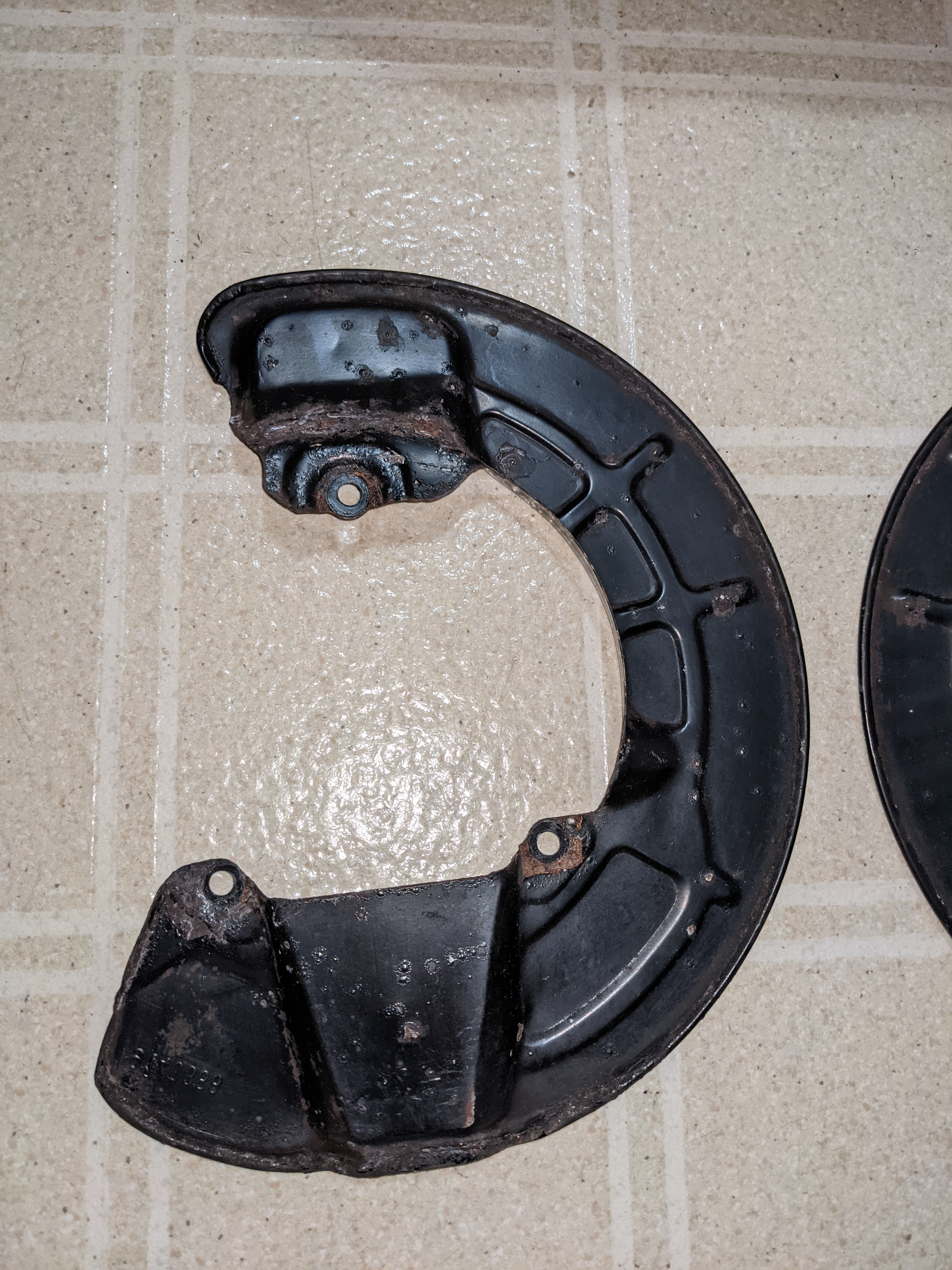

The third rear caliper I received had only minimal rust straight from the Volvo contracted rebuilder. One of the Volvo branded front calipers I received also had slight rust. Upon closer inspection, that front caliper's inlet hole and bleed screw hole had been shaved down significantly, probably because of rust. I'm so disappointed in the bad quality of these expensive Volvo branded rebuilt calipers.
I had planned to send my existing rusty front caliper brackets to the powder coating company, letting them do the cleaning. I even pulled a second set from a junkyard to see if they might be better. The ridges which hold the pad ears are less than perfect. I'm going to buy newly rebuilt brackets to maintain the goal of starting with the best possible materials.

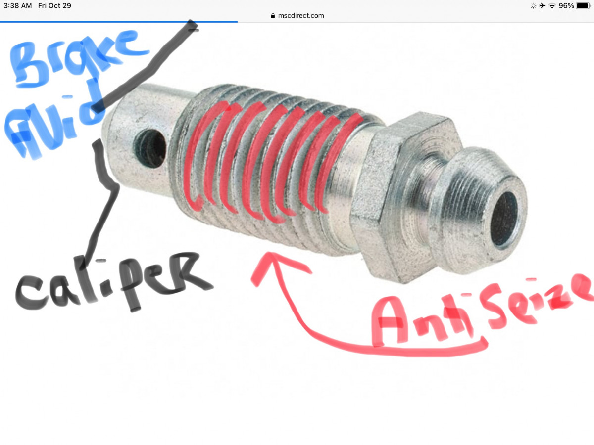

Here’s why it’s ok to antiseize bleeders on calipers.
Even the bit you get on the angled tapered sealing surface is ok, because you push 250 ml of fresh fluid through each caliper!
Drawn with a fat finger at 0343 after a bottle of Glenfidfich and a night of debauchery, Aye!

Wow, the spouse and kids are out of town and look at you!abscate wrote: 29 Oct 2021, 01:44 Drawn with a fat finger at 0343 after a bottle of Glenfidfich and a night of debauchery, Aye!
(but nice drawing!)

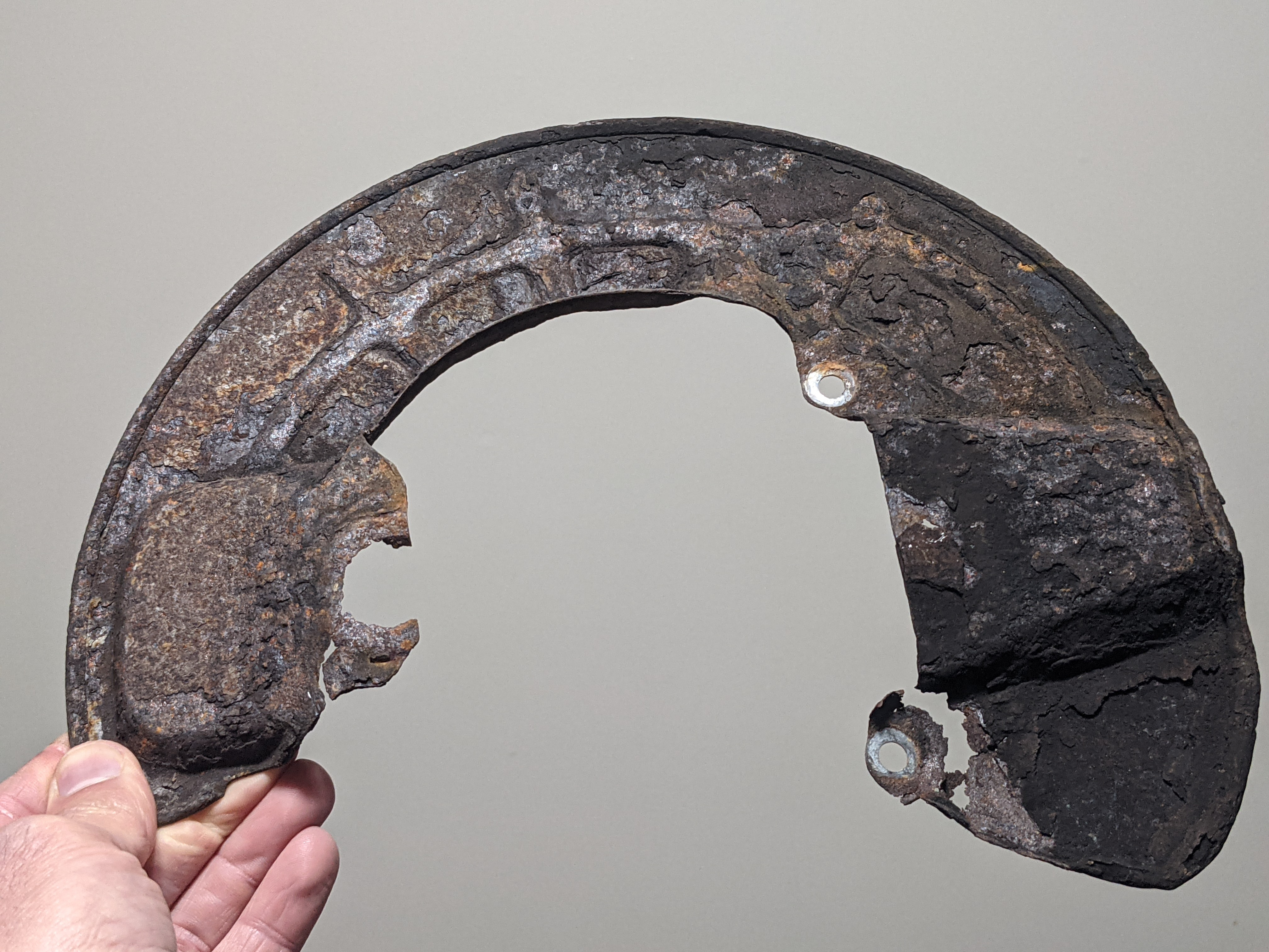

Front and rear dust shields were added to the powder coating job. In 2000, dust shields were bare silvery metal which rusts away to nothing. This is how they come today when you buy new Volvo branded replacements. In 1999, dust shields had a nice black coating which seriously inhibited rust. I'm not sure if these black ones are available new. Here's my 2000 rusty dust shield and the 1999 I pulled from a junkyard car which sat for the last seven years. I am having the used black fronts and new silvery rears stripped and powder coated.
