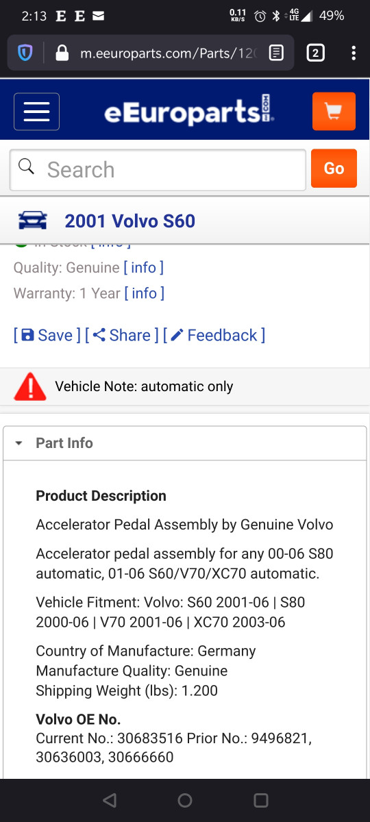

I don't have an eBay account, and the closest pedal to me from a junk yard is 80 miles away for $35, and it's from a turbo model which isn't the same as the naturally aspirated model.

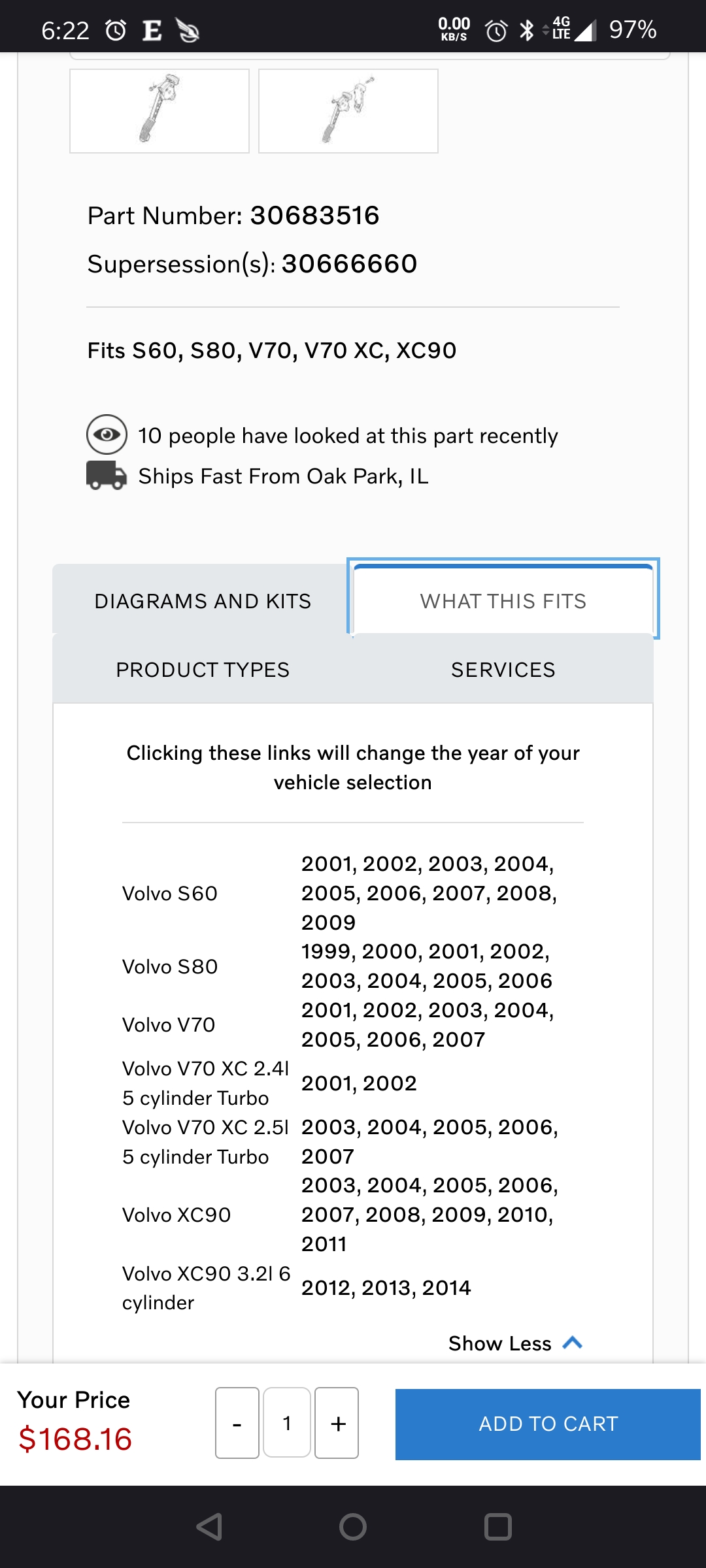

Maybe I am wrong but a quick search shows that the same gas pedal is for NA and Turbo models?
https://www.tascaparts.com/oem-parts/vo ... r-30683516

This is what I found, using the part number 30683516 from FCPEuro. I don't know which part number my pedal is without removing it to see the sticker.

https://www.volvopartswebstore.com/show ... evel=24650
Seems to be several different pedals. I wonder what the differences are between them.

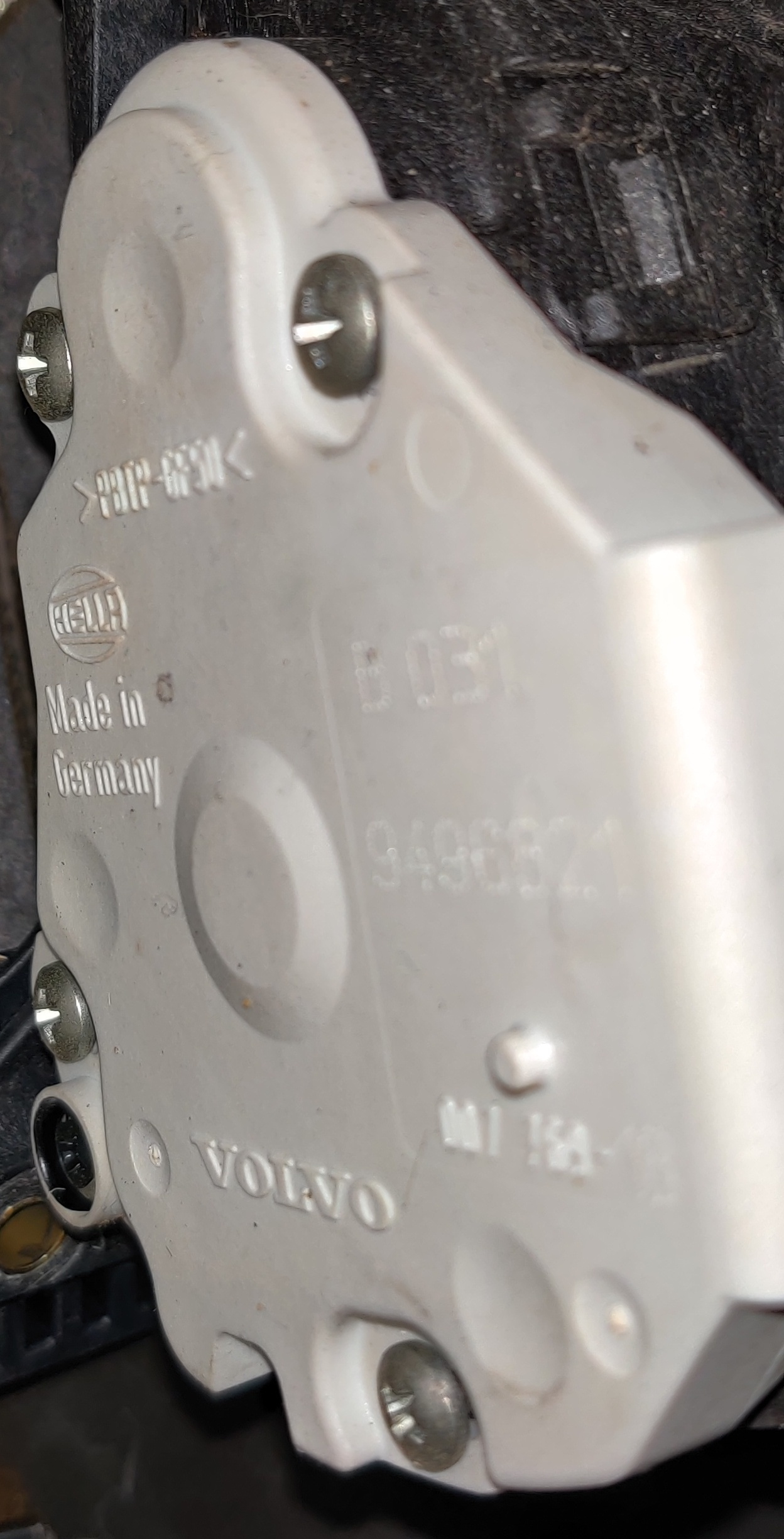

How hard is it to remove the gas pedal?
I did that in my P80 1998 V70, but have never done it in the P2.
Just wondering...
PS: Best is to hit the dome switch so the lights are off while you remove the gas pedal.
I think there are 3 10-mm bolts.
Ebay random photos show me that the PN sits on the inner side, between the gas pedal and the inner carpet side.
Remove it and showed us the PN.
Just wondering...
