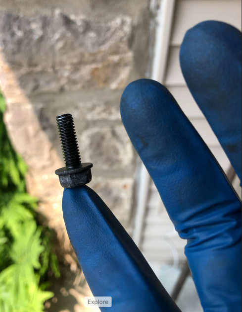

This weekend I tackled an AC clutch re-shim on my 1999 s70.
I had the classic symptoms of AC being cold for a few moments and then it would get warm. I measured the gap and it was greater than my larger gauge which was .866 mm.
The job wasn't too bad. I basically followed many of the online videos for removing the alternator .
Some of the videos I watched have people remove the fan shroud and removing the alternator by moving it across the front of the engine and out where this is more space. On my 99 s70 I didn't have to do that. It just comes out near the ECM. Pretty darn easy.
For the puller, I follow the template here;
https://www.matthewsvolvosite.com/downl ... AC-Fix.pdf
However, I just made it out of plywood. Worked like a charm. I did hot melt glue a fender washer onto plywood where it would make contact with the bolt screwed into the clutch so it wouldn't just sink into the plywood as I tightened the 3 5mm bolts. Popped the clutch right off. I threw the tool out by accident and never took a picture of it. Stupid me. Just a square of plywood with 3 holes drilled into it based on the template in the link above.
it turns out that someone had already been in there and had removed the medium sized shim . That's probably the one I needed as using any of the remaining shims would have left me in a Goldilocks scenario: Thick shim would have left the gap too big and the thin shim would have left the gap too small.
So I made one out of some aluminum gutter flashing.
Gap is now .4 mm and AC is cold.
Two tips.
1) Watch out for holes in the frame. There is a hole in the subframe just below the center bolt for the AC clutch. I dropped the bolt and of course it fell into the frame almost to be lost forever. So tape over the holes first.
2) I was able to feel the bolt inside the frame but I couldn't grab it. So I stuck a rare earth magnet inside my glove. Worked well
(edited for spelling)
