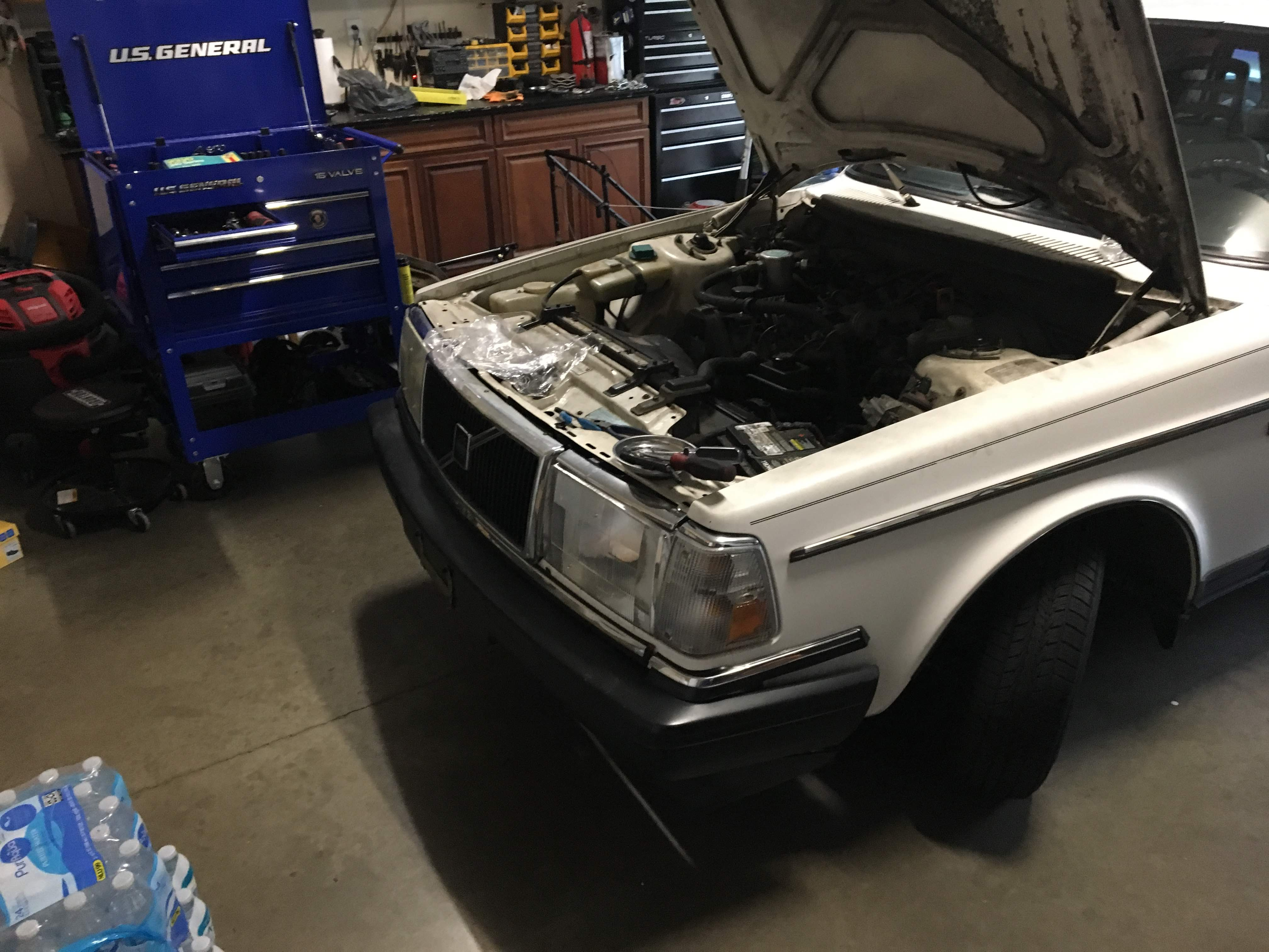

Did the PCV on my cousin's '91 240 today. Holy crap... it makes the white block PCV look harder than a VW W8 timing job! Two screws, two hoses, and an o-ring. New flame trap to finish it off.
