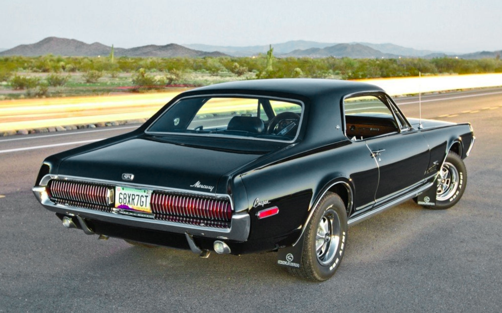

MoVolvos wrote: 24 Sep 2019, 12:58 ... I remember the BW Shift Kit in the family 78 Cougar XR7. Second gear chirps at 50mph on wide BFG's. Lowered with Dual Exhaust No CATS.
http://www.scottlewisonline.com/images/ ... lack_2.jpg
10 years too young!!
https://www.hemmings.com/blog/2017/11/2 ... id=1&pid=2

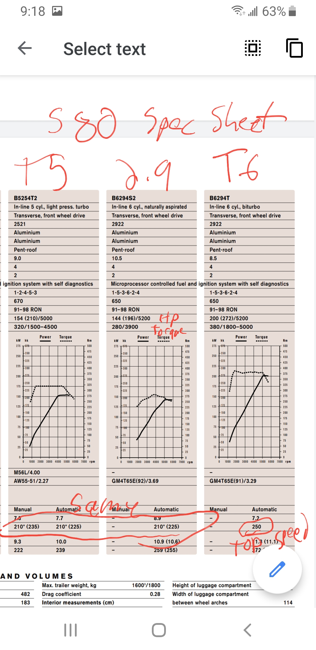

Hmm... not quite. The 2.5T is pretty good in the S80s, a friend of mine has one. It's not going to be as quick as the T6, but it's definitely faster than the 2.9 NA (couldn't tell you how those are, but I assume they're pretty slow).
The 4T65 in the T6 is the bad transmission. By 2006, the AW55-50 had been improved. The shifting issues are with the older ones. My 2003 suffered a pretty bad flare from 2-3, but the B4 servo cover update and a couple ATF changes has mostly fixed that. After several more drive cycles, it should be completely normal again... I'm too cheap to go and pay the dealer to update the software.

bmdubya1198 wrote: 24 Sep 2019, 18:32 Hmm... not quite. The 2.5T is pretty good in the S80s, a friend of mine has one. It's not going to be as quick as the T6, but it's definitely faster than the 2.9 NA (couldn't tell you how those are, but I assume they're pretty slow).
That said, that S80 looks pretty nice! Not too bad of a deal either.
Don't assume. I've driven all three versions and can speak from experience. If you think you're friends T5 is quick, then slip behind the wheel of a T6 and prepare to gain a permanent smile! The 2.9 NA and the T5 are both electronically limited to 210KMH. The T6 250KMH. The T5 has 10 more HP than the 2.9 NA notice the factory data sheet I have attached. As far as the 4T65 being a bad transmission are you just repeating tripe? Or have you owned one??? June

I have not owned one, I’m just going off of what I’ve heard. I’m sure if it’s well maintained in stock form it will last, but I like power and I push my cars. I’m sure that transmission couldn’t hold any more than stock power.
I’d really like an XC90 T6, but I’d have to figure out how to beef up that transmission.
Anyway, I haven’t driven any S80, so I can’t say much about the actually driving experience, but just look at the torque curve. Around town, the 2.5T looks like a much better engine than the 2.9... way more low end torque. Also it’s over a second faster to 60!
