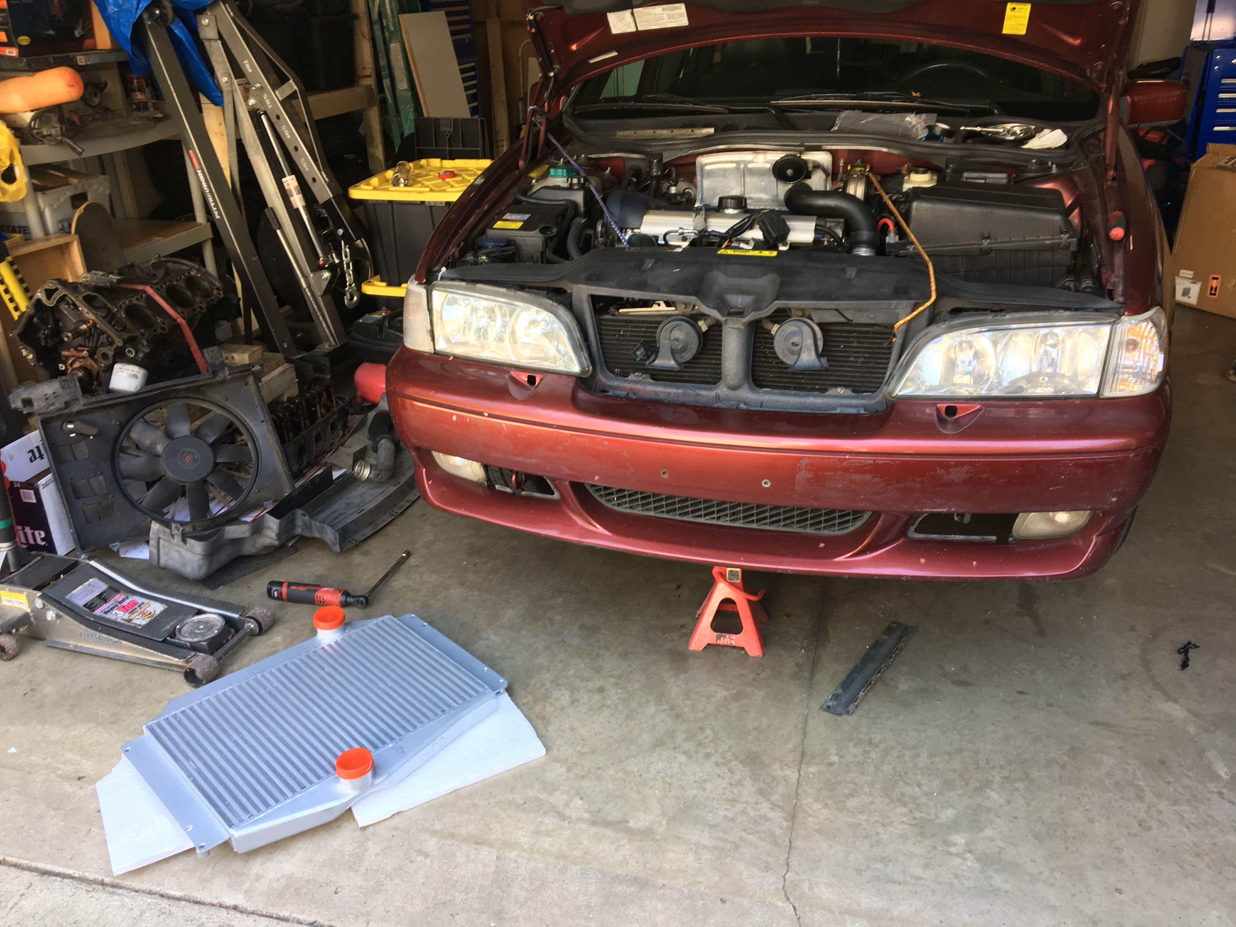

Dropped in my do88 intercooler today as well as replaced the battery cable to the starter. Unfortunately it didn't fix the boost leak (I have no idea how... I was almost certain the IC was the problem) but at least it'll help once I get it boosting properly. I think it may be time for a turbo... I don't know what else it could be.

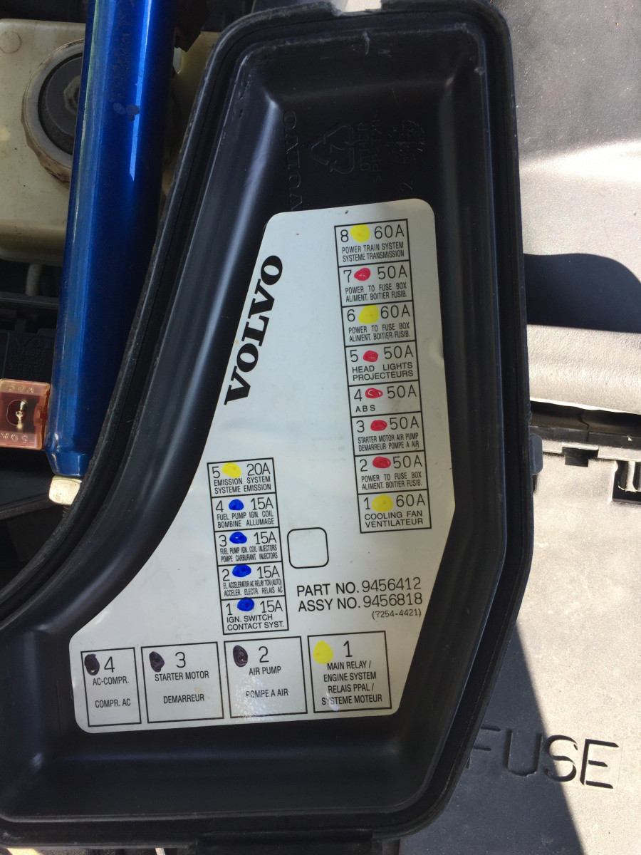

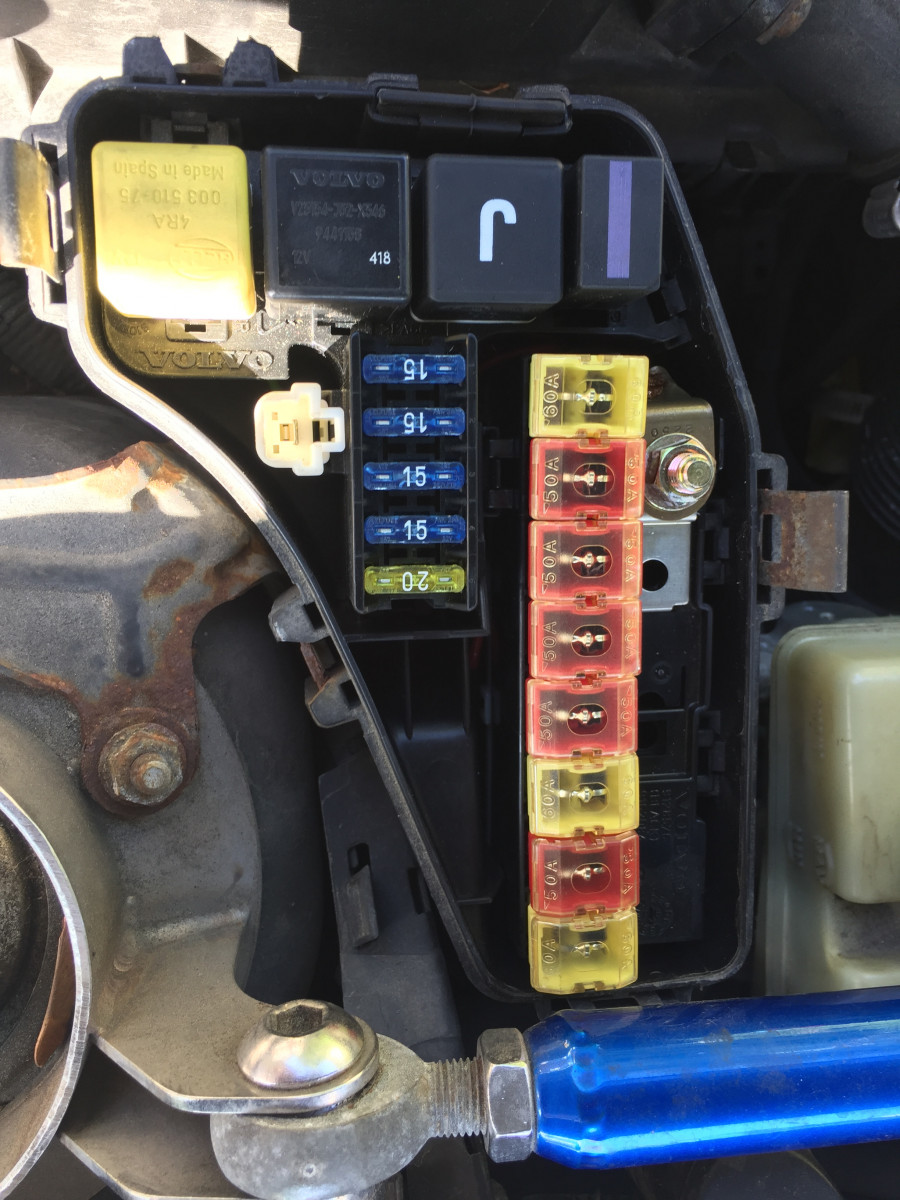

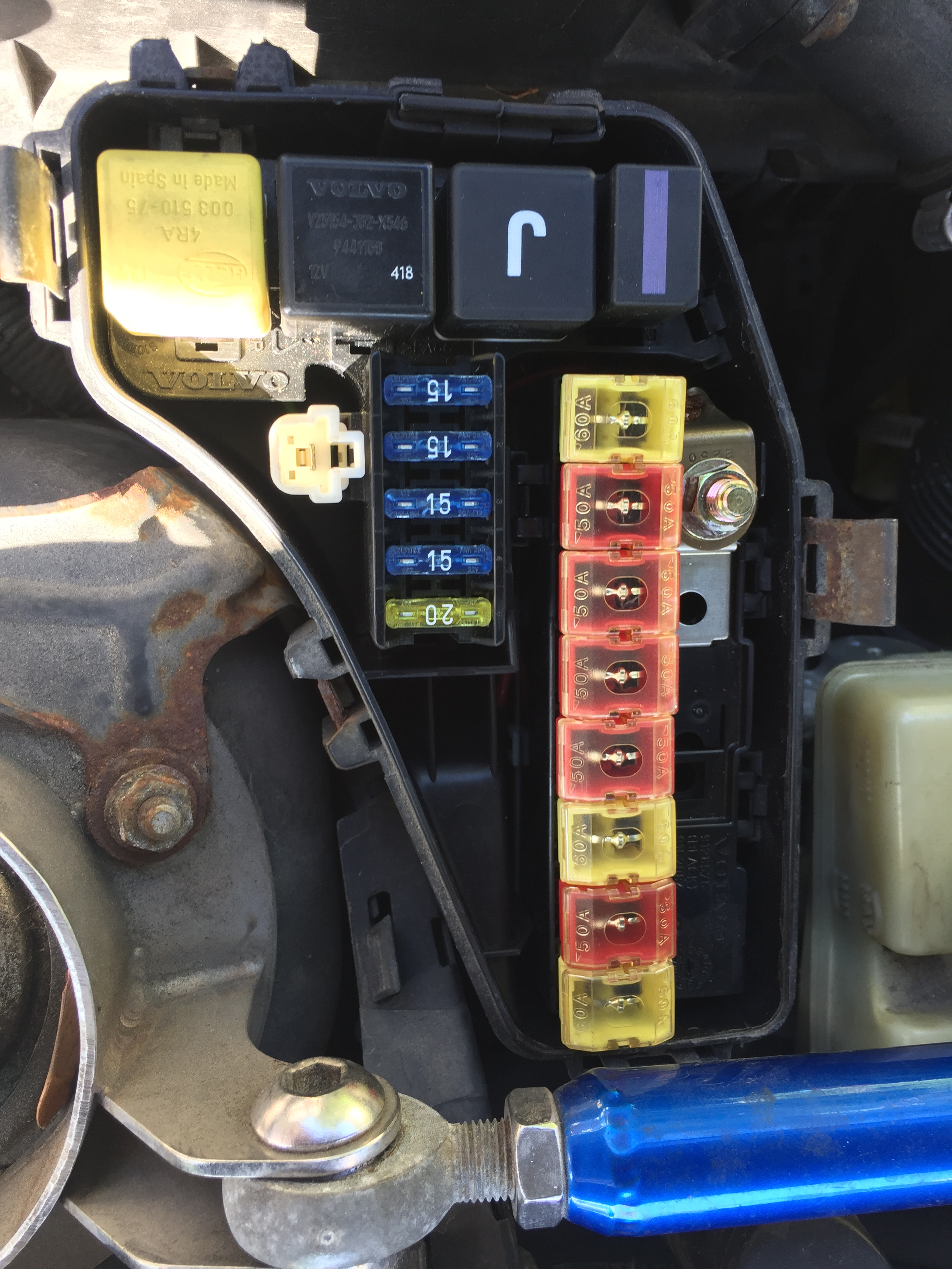

Inspected my B+ cable to fuse box motivated by recent experiences here
Colour coded my fuses on the fuse box cover diagram

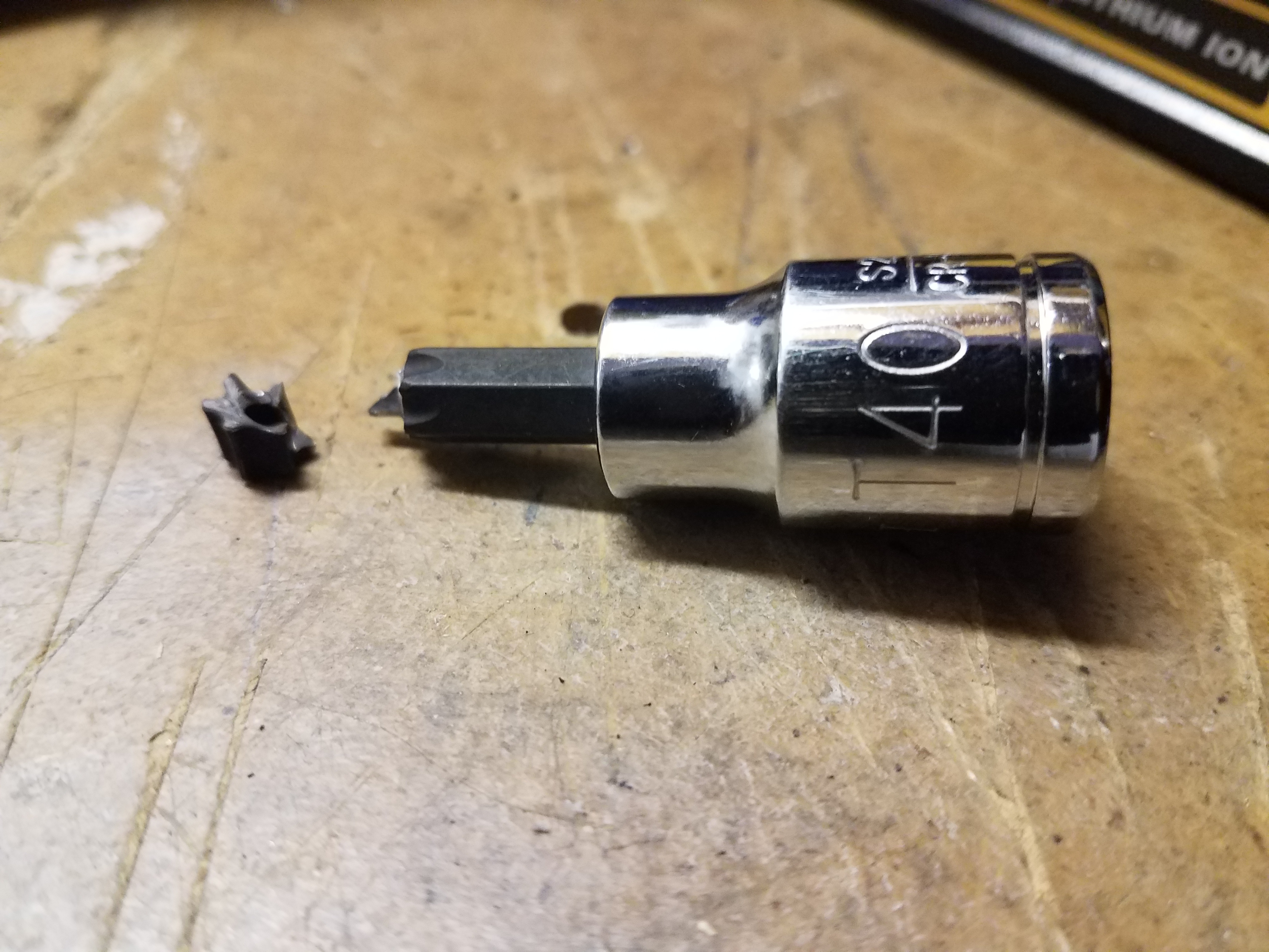

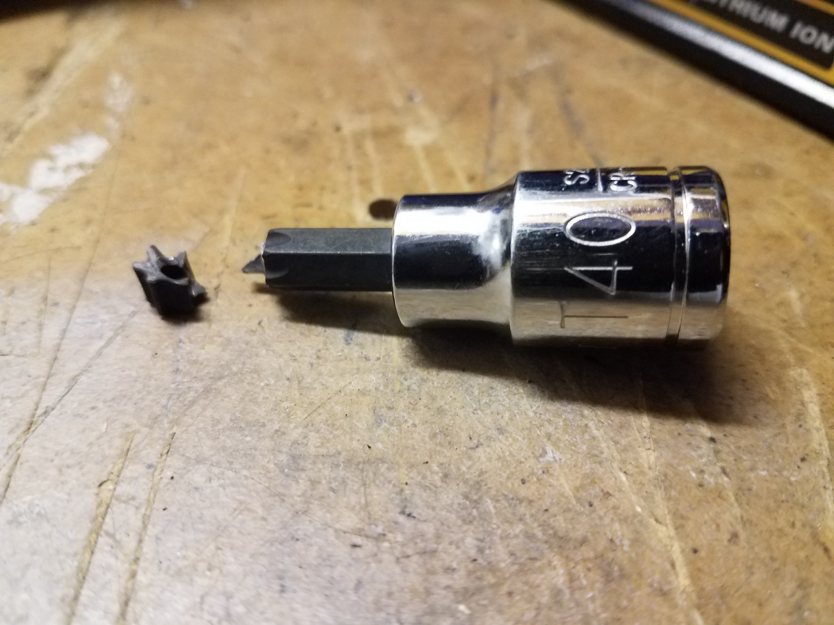

So I took a crack at the thermostat replacement. I have been periodically spray penetrating oil for the last few day. I hate tha
t I have to disconnect the fuel line to reach one of the bolts. I incidentally discovered no fuel pressure in that line but it has been sitting for 36 hours, so maybe I dont need to investigate?
Anyway, I took my T40 and a breaker bar and just gently tried working the bolt back and forth. I could hear abs see the bolt turning a small amount, like 15 degrees or so.
I have a backup vehicle.
I have the weekend off.
And the wife is out having a girls weekend.
The risk was acceptable.
I decided to go for it.
Broke my only T40 bit
Thermostat bolt: 1
Me: 0
If the head snaps off, the housing should just lift off right?
