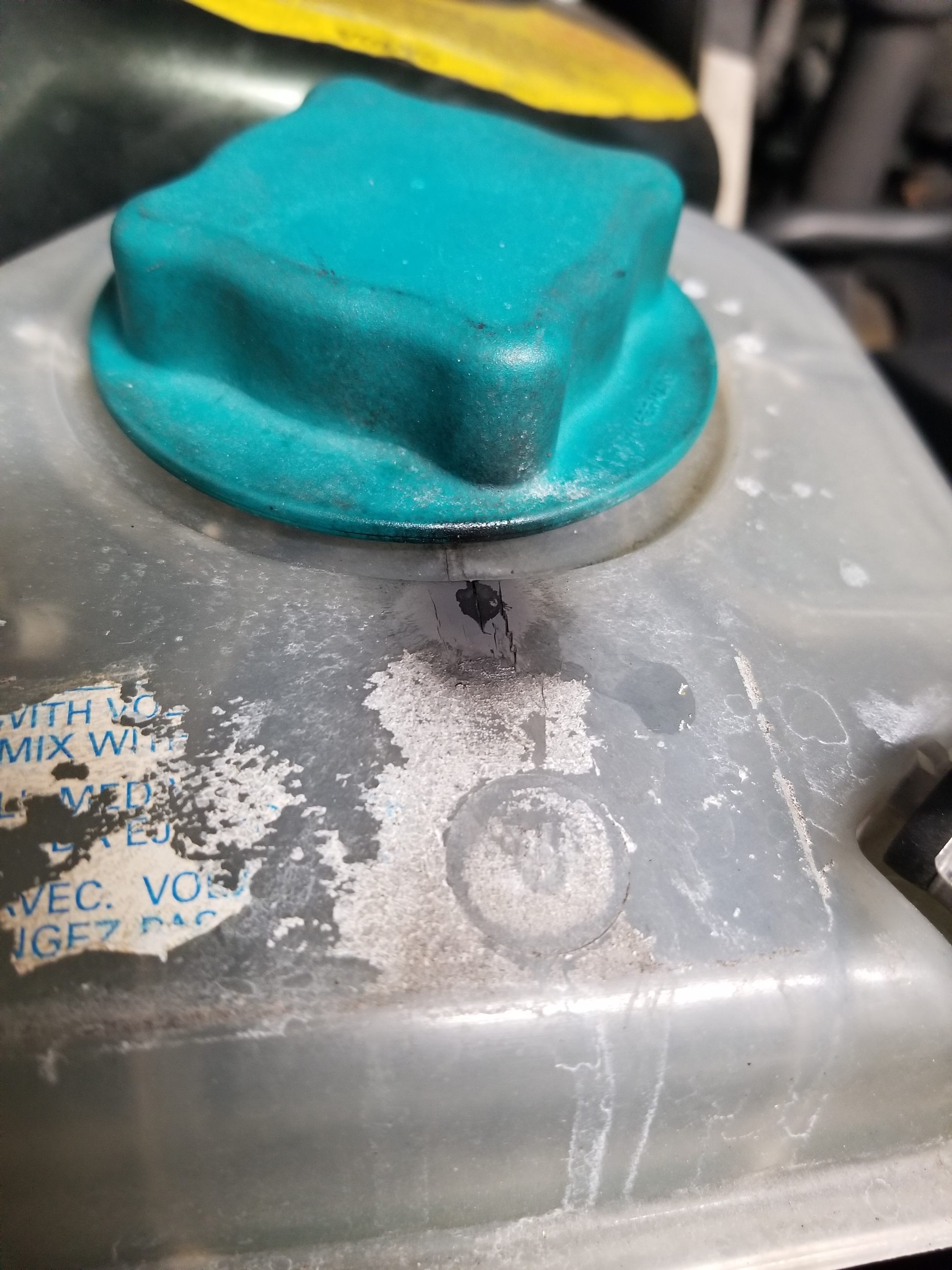

Herman has developed a few new issues. An exhaust leak somewhere between the catalytic converter and the header. The rear right emergency brake cable seized last week. And now the coolant expansion tank has developed a crack with dirt around it and I'm wondering if the head isn't failing.
It wouldn't be 15 degrees out if Herman didn't break!!!
What do you guys think? Just replace the tank or do a more thorough investigation?

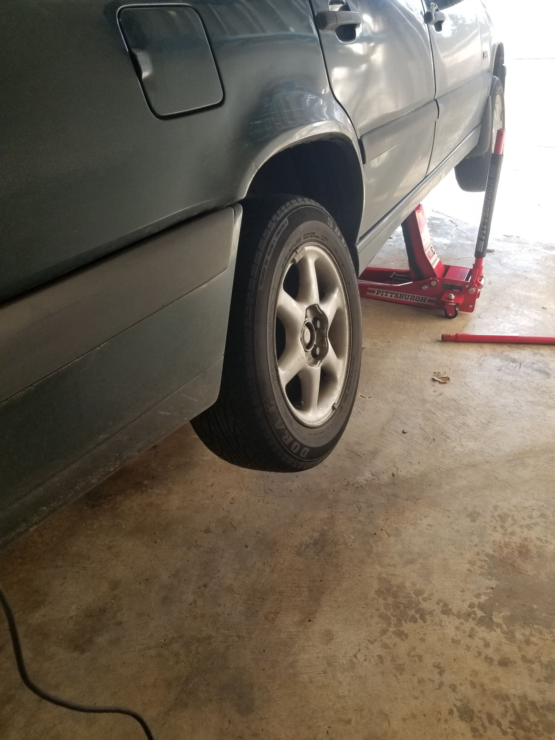

Obligatory picture of Herman jacked up.

Unless there are any other signs pointing to a bad head gasket, I'd suggest it is just old car issues. You obviously work your car hard and at it's age it is complaining. The header tanks are a known issue with age of the cars so would not necessarily mean a bad head gasket. Could have got dinged when you were working on the steering or anything else. If you have no bubbling in the header tank, or brown sludge in the header tank or engine oil then you are probably fine.

Thanks Neil, that makes me feel a little better. For some reason I'm always waiting for the engine to pop on these cars, but never actually does!scot850 wrote: 27 Jan 2020, 16:24 Unless there are any other signs pointing to a bad head gasket, I'd suggest it is just old car issues. You obviously work your car hard and at it's age it is complaining. The header tanks are a known issue with age of the cars so would not necessarily mean a bad head gasket. Could have got dinged when you were working on the steering or anything else. If you have no bubbling in the header tank, or brown sludge in the header tank or engine oil then you are probably fine.

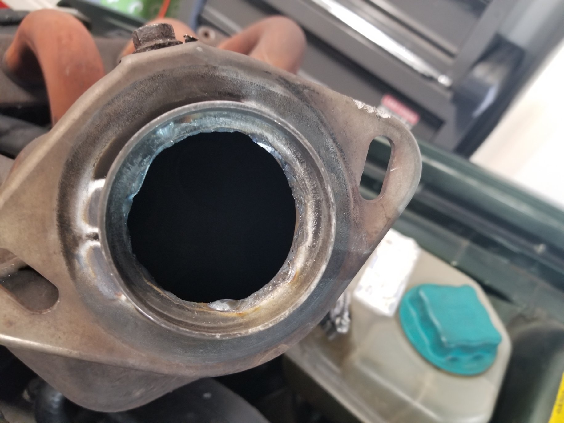

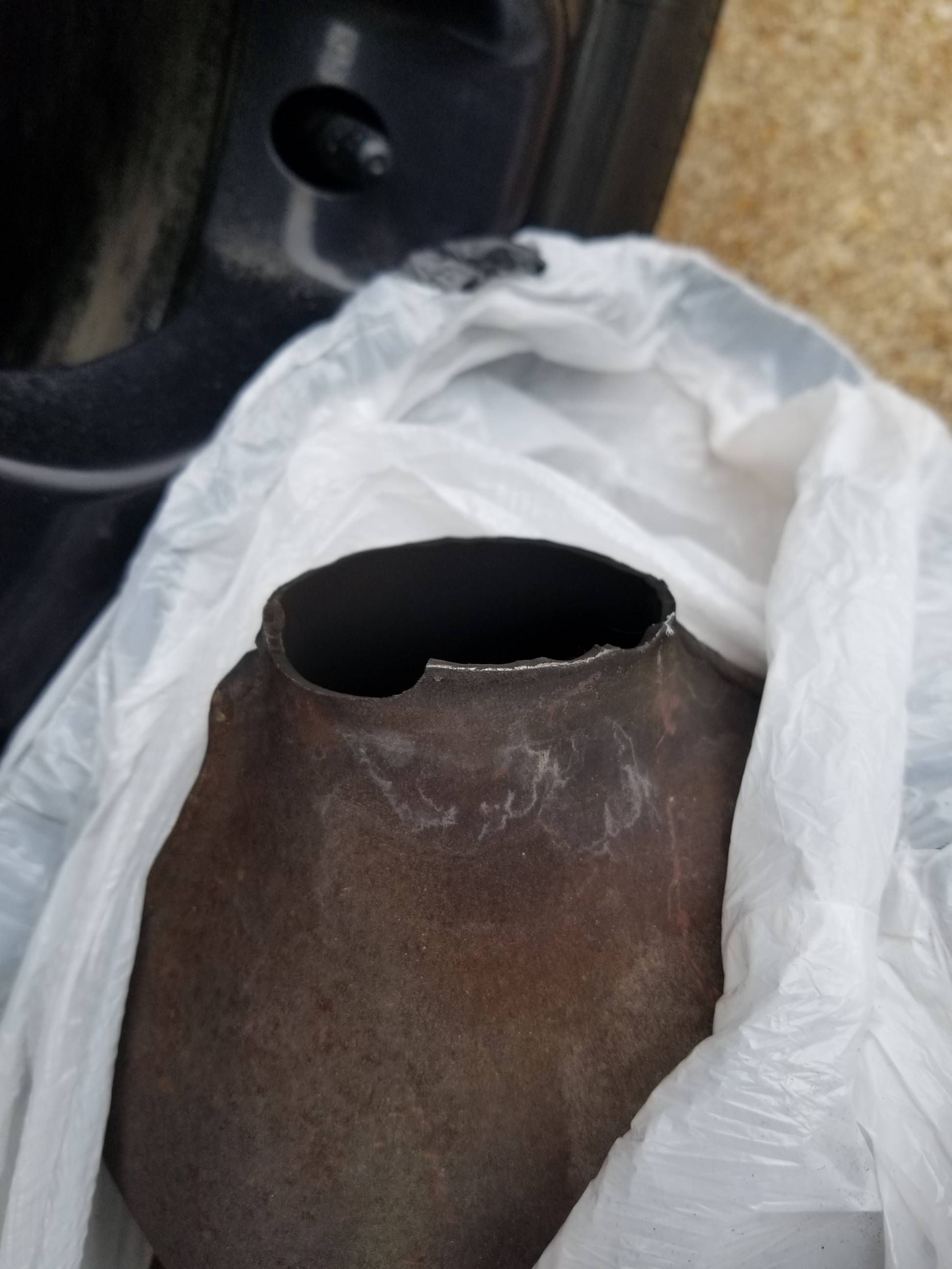

I took Herman out of service this week and rented a car while I tracked down the exhaust issue.
Turns out that the exhaust flange cracked at the welds with the collector and had actually disconnected! Turns out no one makes new two bolt manifolds anymore. Per Abscate's suggestion I took it to a local fabrication shop and they were able to fix it for $17!

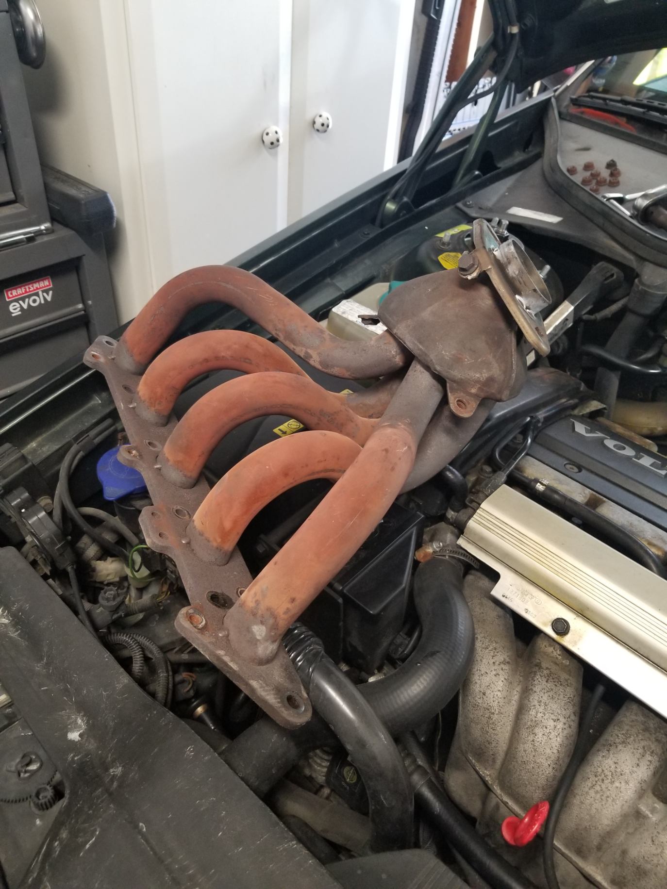

Pics of the repaired manifold: As you can see on these early n/a motors there is no flex pipe and only two bolts on the header.

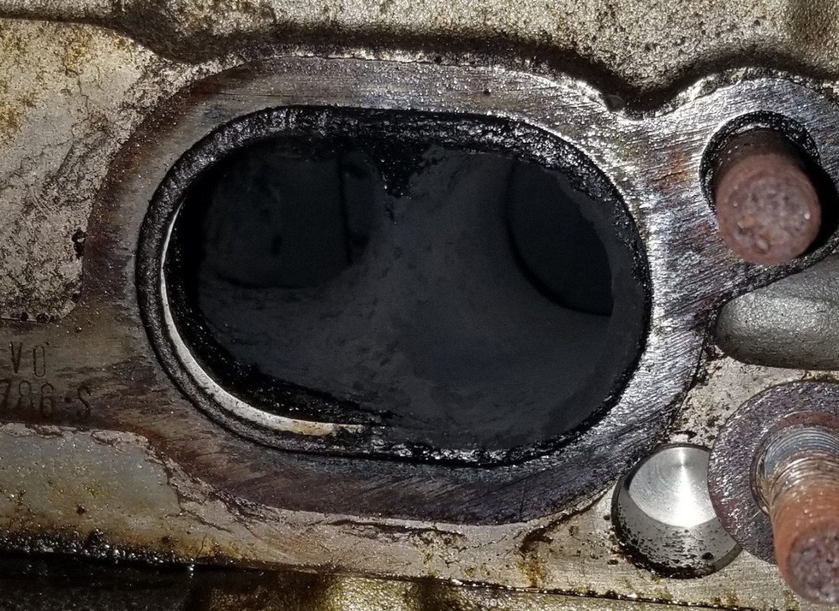

While I had the exhaust apart I inspected the exhaust valves and found that one of my valve stem seals in my exhaust was failing.

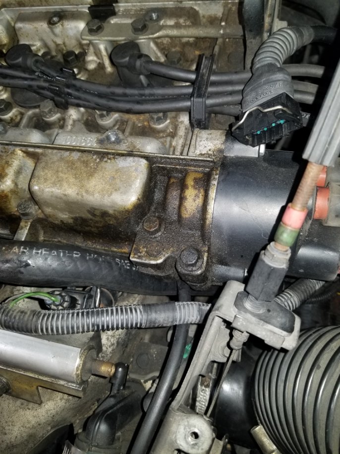

While I was in the engine bay I went ahead and rebuilt my PCV system using the smallest amount of rubber possible, and substituting copper pipe for most of the lengths. One of my rubber hoses had swollen under the intake manifold and had begun to leak oil everywhere. With the Variable intake manifold I couldn't go under the intake manifold or around the bottom without pinching. So I went up and over. Here are some pictures for your viewing pleasure.
