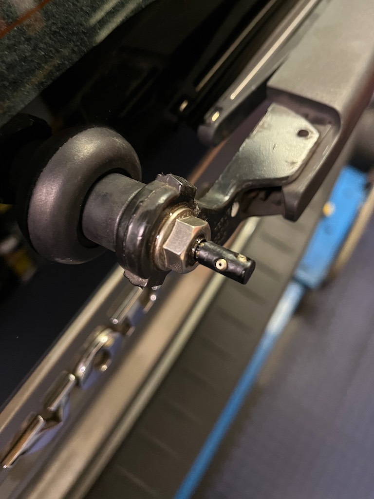

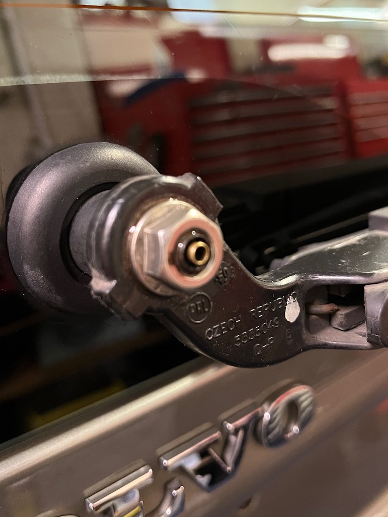

On Saturday I decided to remove the rear wiper arm to reposition it as it was resting on the channel at the bottom edge to the glass. I loosened the nut and put the wiper arm removal tool on and cranked the handle and the arm came off after a bit of persuasion. What I didn't realise was the rear washer jet protruded from the centre spindle and the pressure of the removal tool snapped it. A check online took me to Youtube and a chap removing his broken jet. He put a screw into the plastic remnants that were stuck in the brass tube and he pulled the entire brass tube which goes through the motor to the hose connection. He then had to dismantle the motor to sort it.
I didn't fancy having to dismantle the tailgate and decided to use a 1.5mm drill bit then a 2mm drill bit to open up the aperture and weaken the grip the plastic had on the brass tube. I then used screw of a suitable size to easily pull the remaining part of the jet out.
So today's job is to put the new jet in...

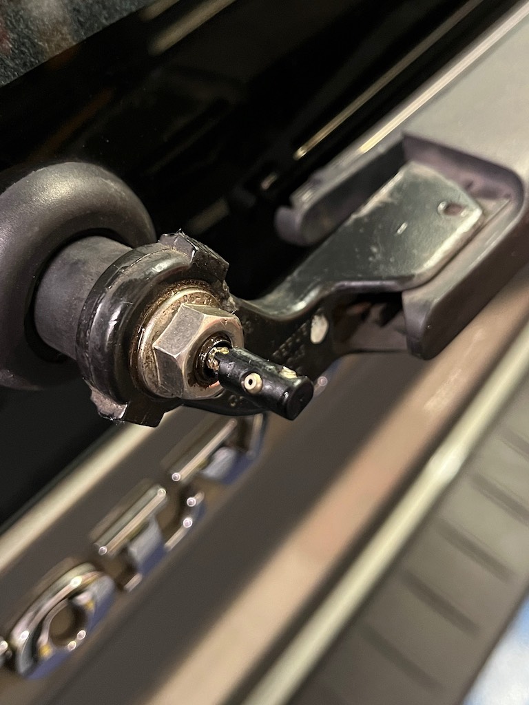

Fitted the rear washer jet which was simple enough as I hadn't damaged the brass tube when removing the old one. One thing to be aware of if anyone is doing this is that once the jet has been pushed in as far as possible it will need pushed further until the brass tube end butts up to the shoulder of the jet body
Brass tube in centre of motor spindle
Jet pressed in by hand. I applied a small dab of silicon grease to the shoulder of the jet body to assist with installation
Jet fully home. I used a soft faced hammer to tap the jet fully home
Jets adjusted, cover fitted and job completed

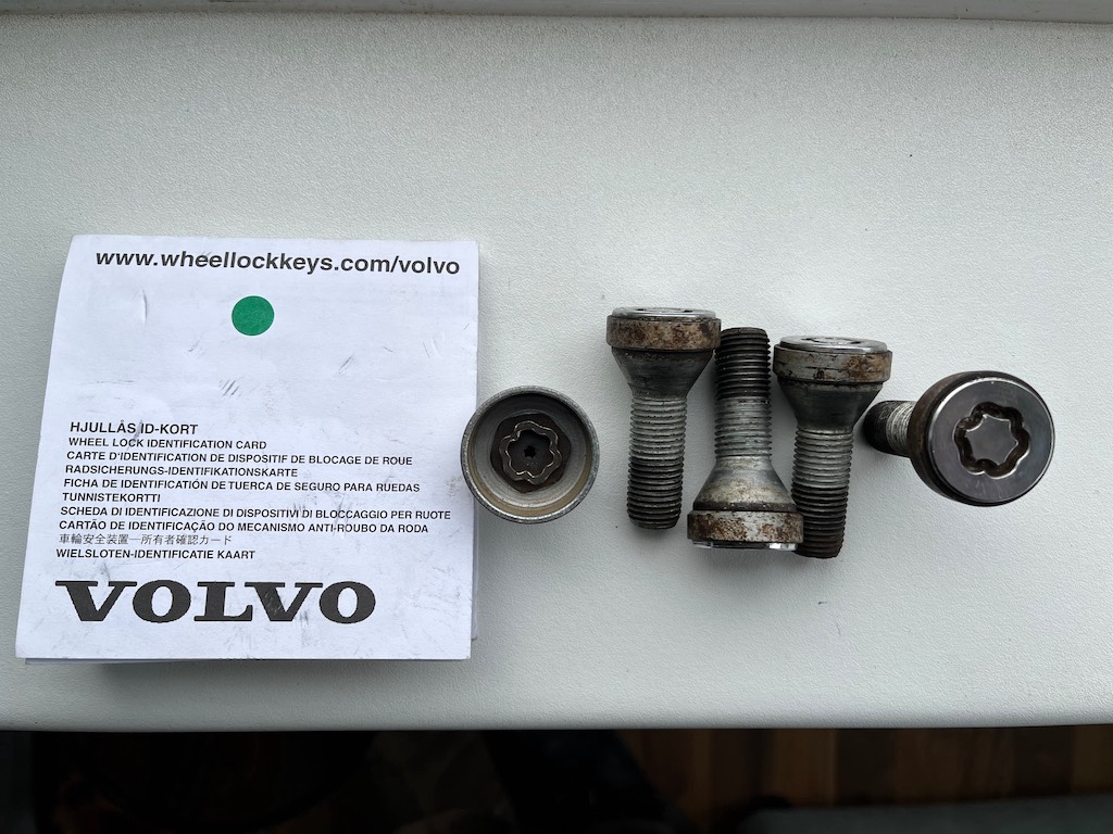

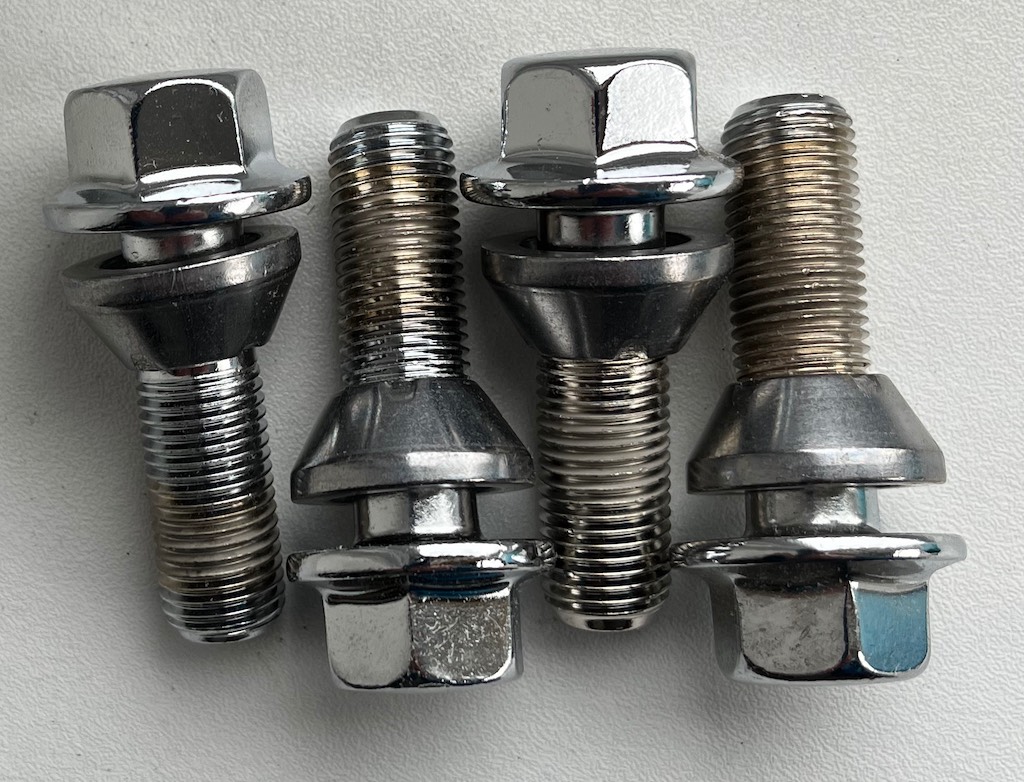

Postman just arrived with 4 new wheel bolts so today I'm going to remove the unreliable locking wheel bolts before they cause untold mayhem

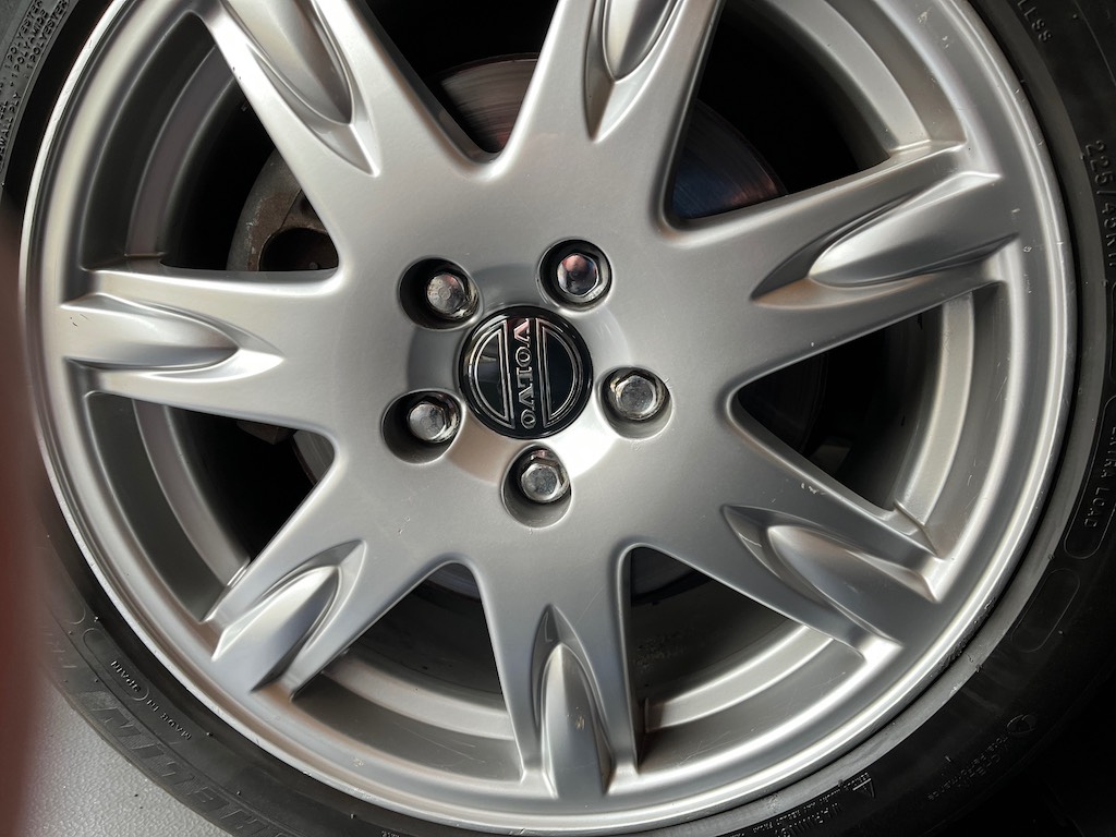

P80GLT
Posts: 397
Joined: 18 Jan 2023, 09:41
Location: Scotland
Has thanked: 154 times
Been thanked: 176 times
Post by P80GLT »
Sorted...
