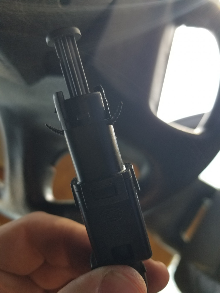

I've been trying to diagnose the cruise control fault for about a year now. I think I have finally figured it out. The brake cut out switch.
Broken Switch
Broken Switch
The mounting tabs were broken on one side causing the switch to always act like it was engaged. Well I guess in this case, unengaged. The switch works but pushing a little rod out when the brake pedal gets engaged. This tells the cruise control to disengage.
I tried to tape it into the resting position by pressing down on the plunger. That unfortunately didn't work. Hahaha. Clutch switch looks good. All the ends of the vacuum lines looked good. The vacuum pump for the accelerator pedal looks good and moves well too. No codes on the ecu so it must be either that switch or a vacuum leak. I've already replaced the cruise control module with a good one. So I think I'll hunt down one of those switches and get my cruise control working again. Golly, wouldn't that be swell?

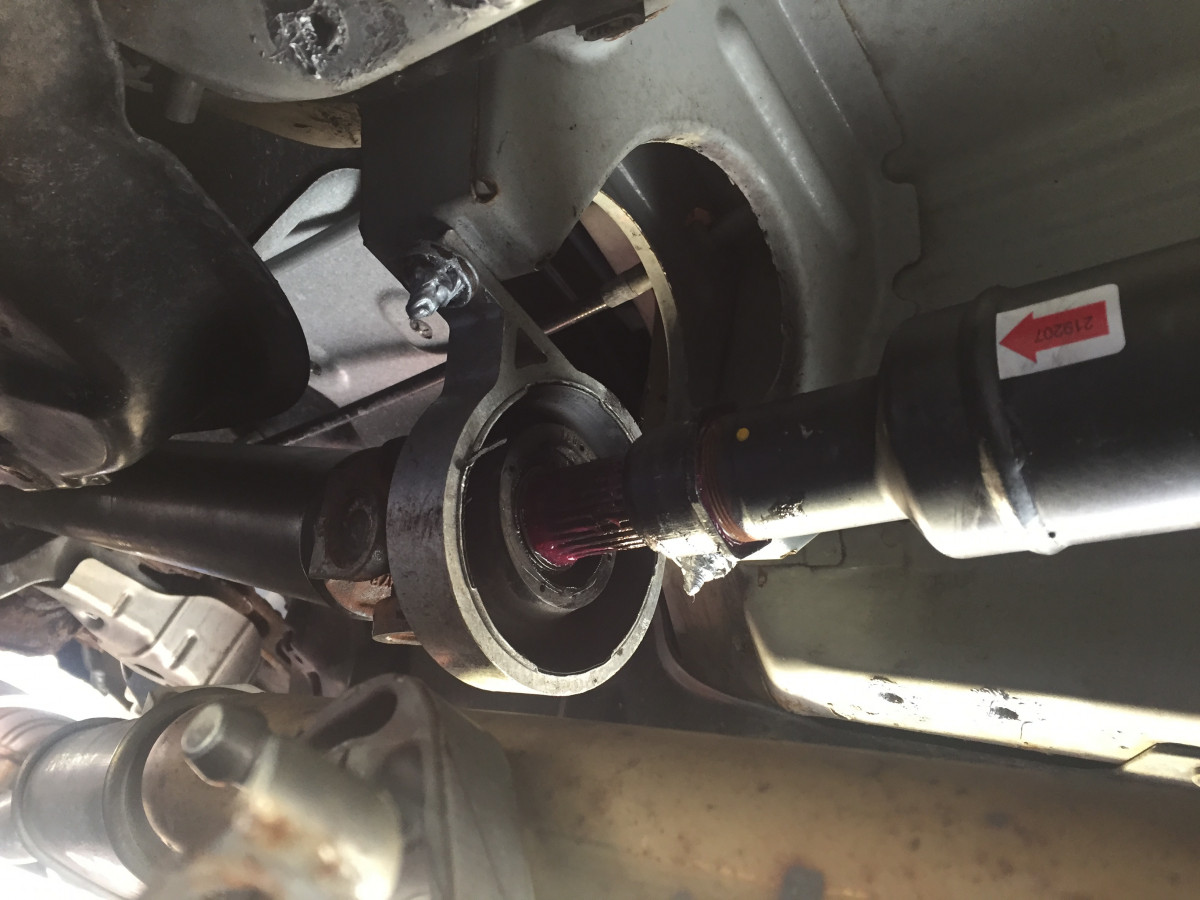

If it’s idiocy you want, let me share my latest on an E83 drivetrain....why won’t the cover fit and why is this driveshaft kinked?

That drive shaft... It looks about right. Just get some wire hanger on that! :lol:
