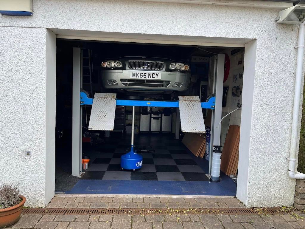

So today was oil and filter change time.

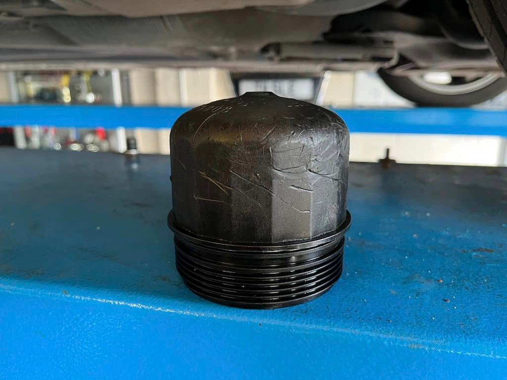

I don't have the correct 86mm-16F tool for removing the filter housing as the XC90 was the 36mm type (I've ordered the correct tool today and will be with me tomorrow) and was unsure how I was going to remove it but just my luck it was finger tight (should be torqued to 25Nm) The car had full Volvo history up until it was laid up in 2012 so I would hazard a guess that a Volvo dealership will have the correct removal tool and the filter housing looks like it's been attacked by the mechanics teeth...
filter cover.jpg (128.38 KiB) Viewed 395 times
5 litres of Castrol 0W-30 A5/B5 and engine run to check for leaks, will let the level sit for a while then re-check
