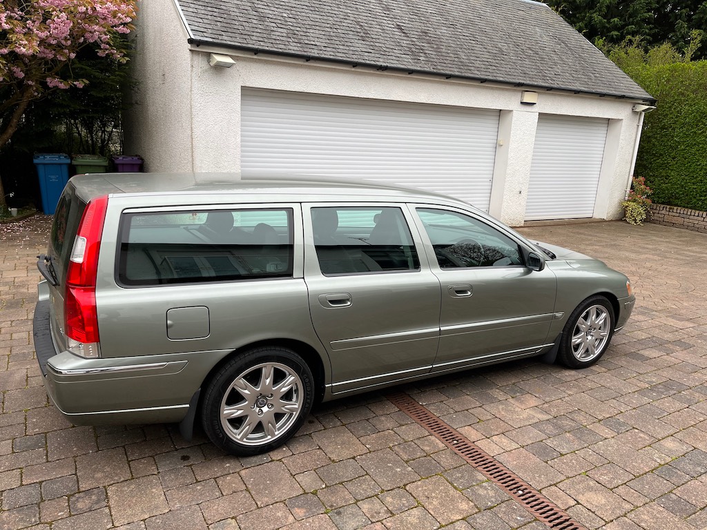

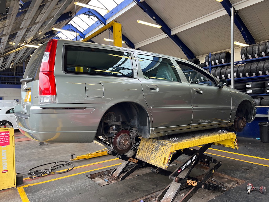

One of the many questions I asked before committing to travel from Glasgow to Slough to view the V70 was are the tyres good. The vendor had provided some lovely pictures in the advert and they looked like matching set of good quality Michelin tyres .
His answer to my question was that he had changed all tyres and me being a bit naive (well I’ve only been round the block a couple of hundred times!!!) assumed he had fitted 4 new Michelins. The car was MOT’d the day before I viewed it and it got an advisory for two back tyre sidewalls having cracks in them, so I knew something was a bit fishy. When I challenged the vendor he admitted he had fitted part worn tyres so one of the many deductions from the price was for a couple of tyres.

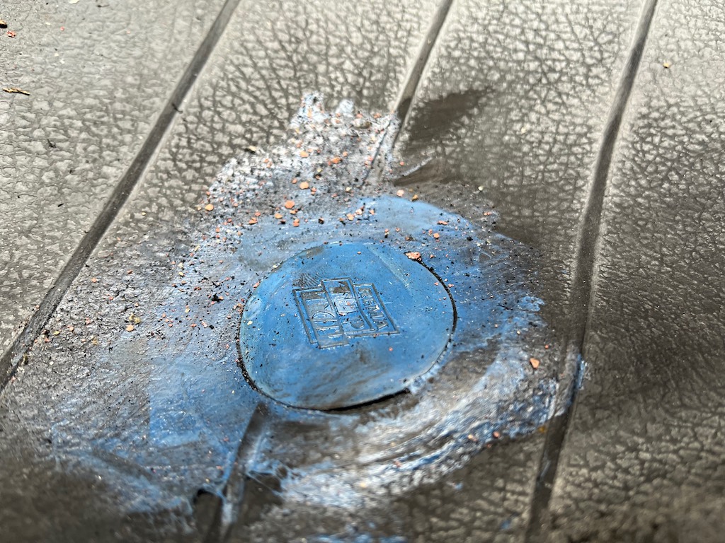

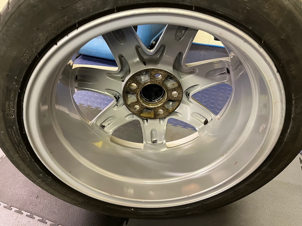

A couple of days ago when I took the wheels off to do the handbrake I had a look at the inside wall of the tyre and it was much worse than just sidewall cracks. Three of the 4 tyres have been run when flat and scrubbed the inner sidewall and delaminated the inner and outer walls, known in the trade as the 'black ring of death'.
3 of the tyres have had poorly repaired punctures where the repair patches were departing the tyres. This could have caused a serious failure at high speed when the tyres heated up
4 new Goodyear EfficientGrip Performance 2 tyres fitted and my local KW which was as expected and they tried to sell me an alignment. A 'free alignment check' is included when you buy tyres so I said "go ahead and check it" only to be told if it did need adjusted it would cost me £64.50. I said just check it and then I'll make up my mind. 10 minutes later I was told the alignment is out, it should be in the green and is in the red. I asked how much it was out and he told me he doesn't really know, they've only had this machine a few weeks and he's not sure how to read it fully. Geez you couldn't make this stuff up... I said I would leave it for now and he said he would adjust it for £50... No thank you, take my car off the ramp and I'll take it away...

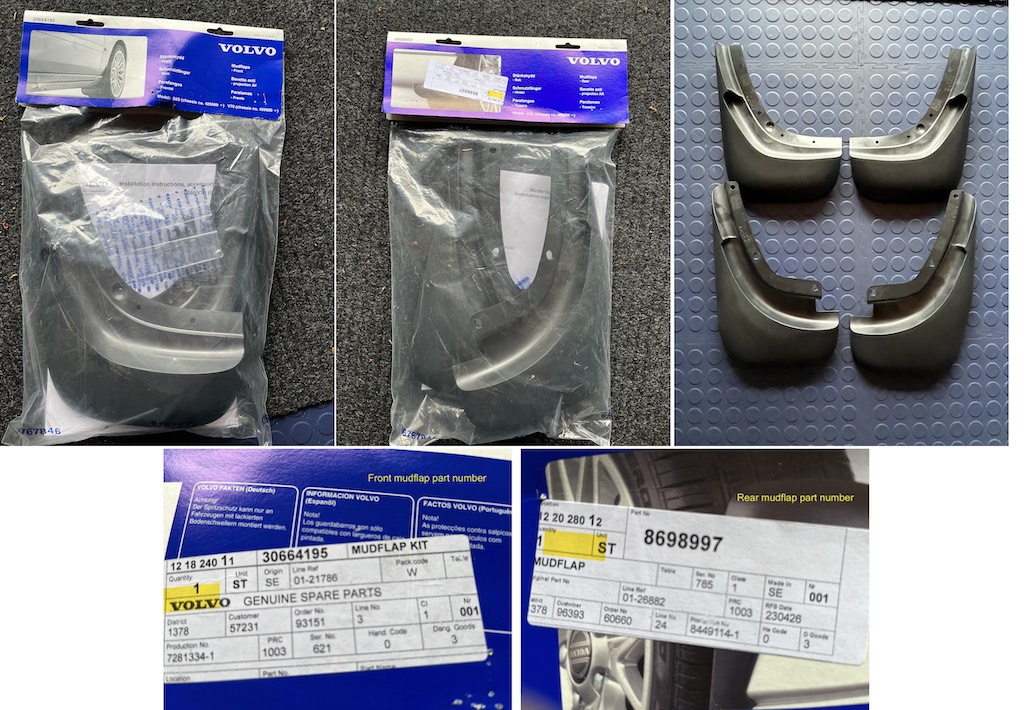

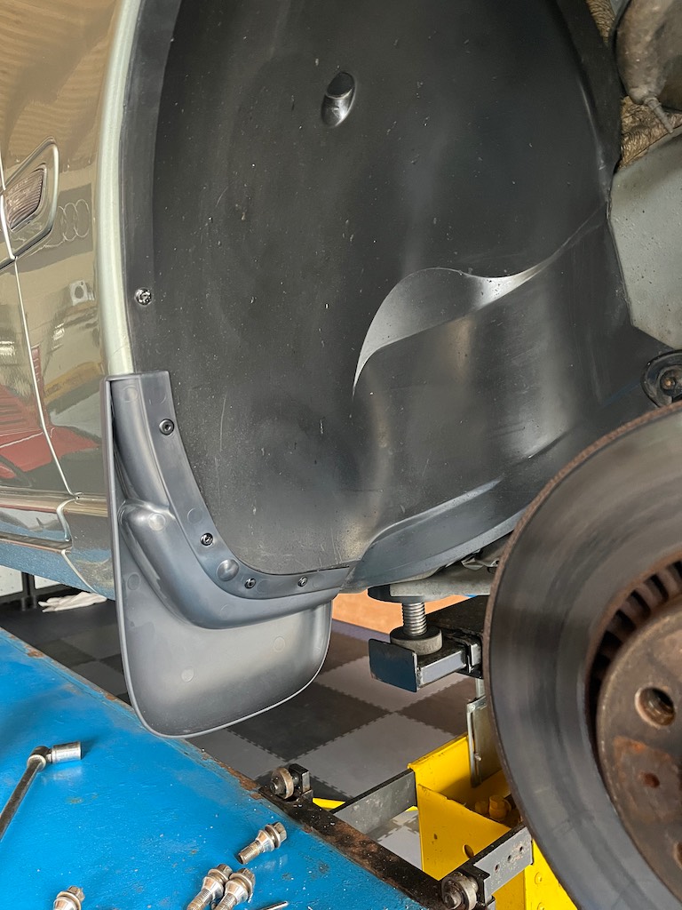

Is seems that the USA are in a better position than the UK & Europe when it comes to supply of certain parts for the P2 cars. Mudflaps are like unicorn horns here in Scotland and after searching for the past two months I had all but given up. I mentioned them to a local parts department manager and he said he thought he had seen a full set tucked away at the back of a shelf last year and was unsure if they were still there, he would have a search for them and let me know. A few days later he called and told me he found them. So yesterday all 4 wheels were removed again to allow fitment While I had the wheels off I cleaned the inside and gave them a coat of wax ...and it would be rude not to clean the wheel arch liners The P2 mudflaps are a better fit than the 850 mudflaps and contour the curves perfectly When I had the new tyres were fitted on Thursday I drove the car straight home which was less than a mile, so yesterday I went for a drive to see how the tyres performed. What a difference from the dangerous illegal rubber that the vendor fitted, the steering vibration/shudder that started around 65-70 and never went away has completely gone. I now need to carefully watch the speedometer or I'll be collecting points.

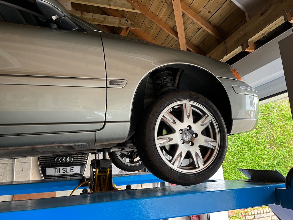

I had planned to check tyre pressures yesterday before going out for my test drive but I had a senior moment and forgot, only remembering once I was about a mile from the house. On the test drive they did feel overinflated but I couldn't check them until they had cooled down. 22 hours later and my trusty calibrated PCL gauge did show consistency between both front and both back tyres, shame they were all around 5psi over inflated. Rear should be 30psi, both read 34.7psi Front should be 31psi they were 35.2psi and 35.3psi.

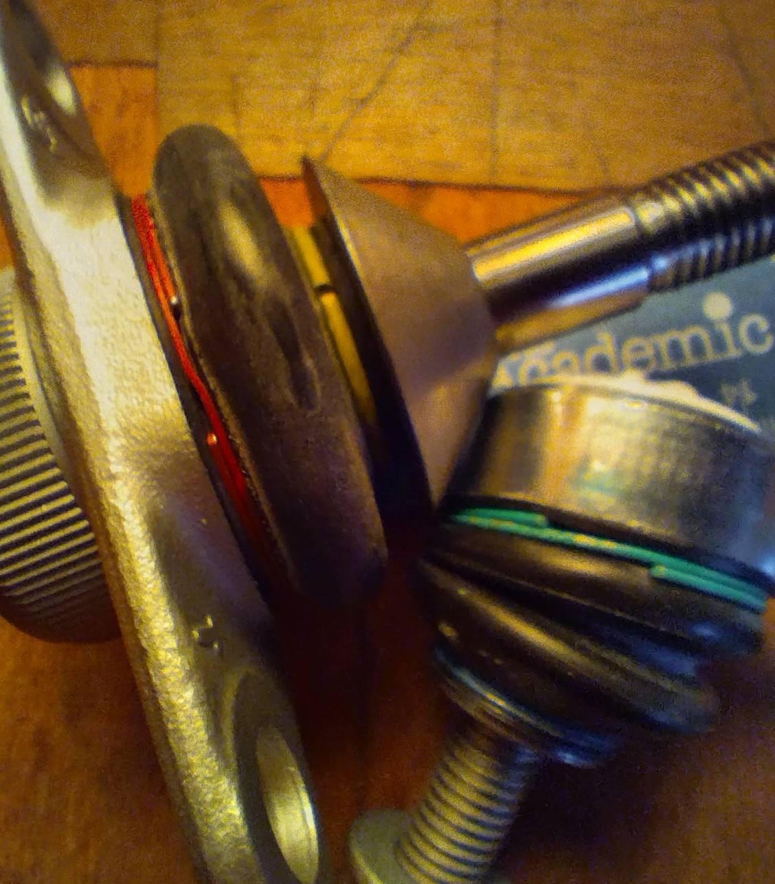

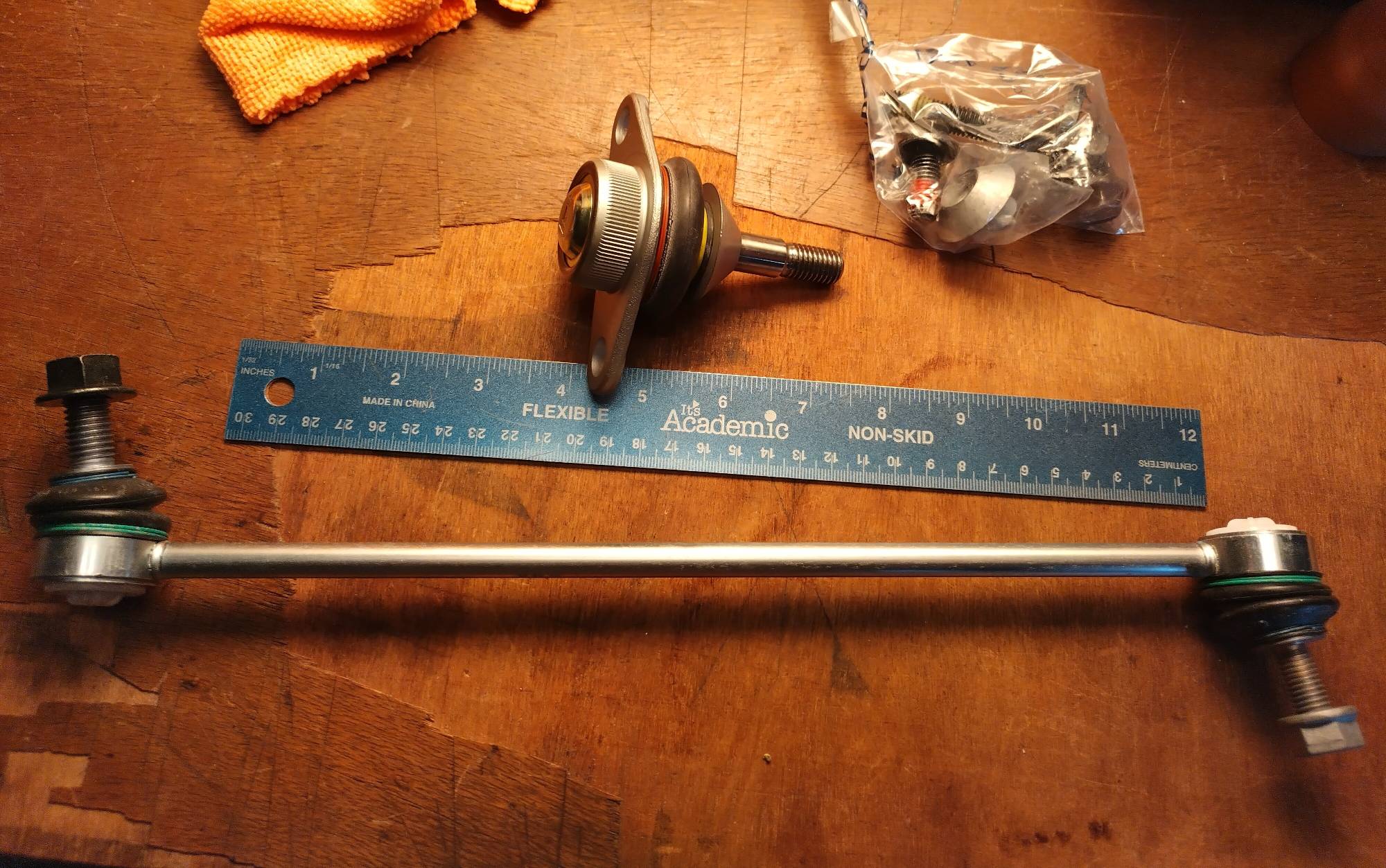

I drove it around a bit to loosen up the suspension in preparation for some new parts.
I use Rock Auto's website to see which brands are popular, and then compare their shipping with other places. These are Lemforders from FCP. They seem well built, but I'm not crazy about the retaining rings for the boots. They look like they could get sharp.
