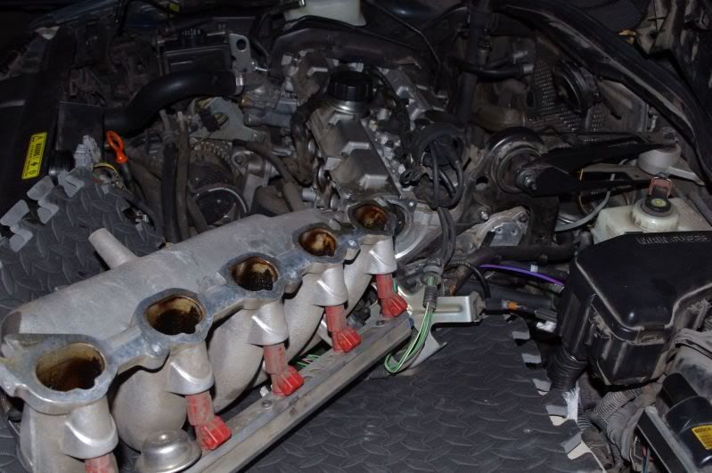

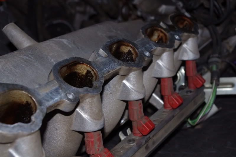

Looks like I should detach the wires and take this manifold out for a thorough Seafoam cleaning. How do you remove the fuel injectors? It didn't seem like a great idea to just pull up on the rail until the gaskets popped out of the manifold. so I didn't do that.

Since you have it apart already, might as well use carb cleaner first, then run seafoam for the rest of the system once its back together.

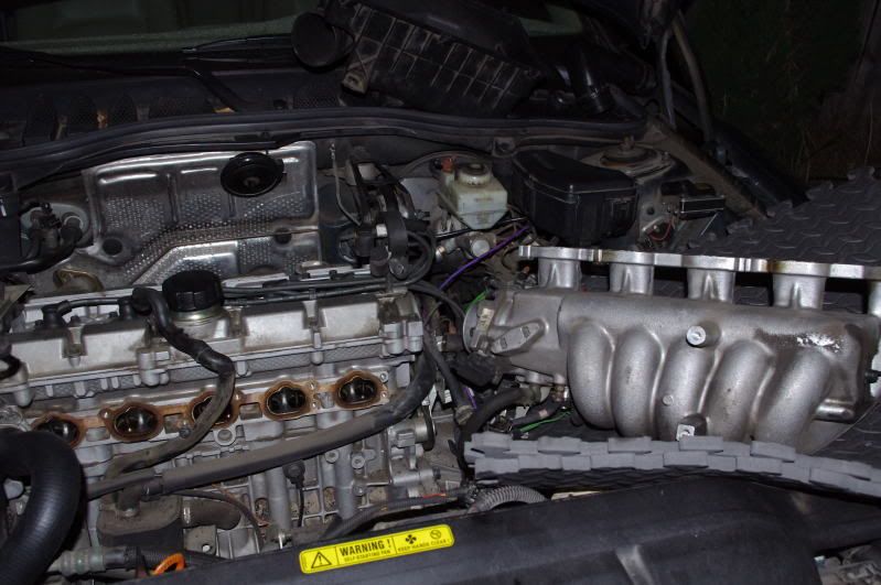

OK I've removed the intake manifold completely from the engine. I put some tape over the electrical connections, then sprayed with carb cleaner and scrubbed with a toothbrush. Drain, spray again, etc...
