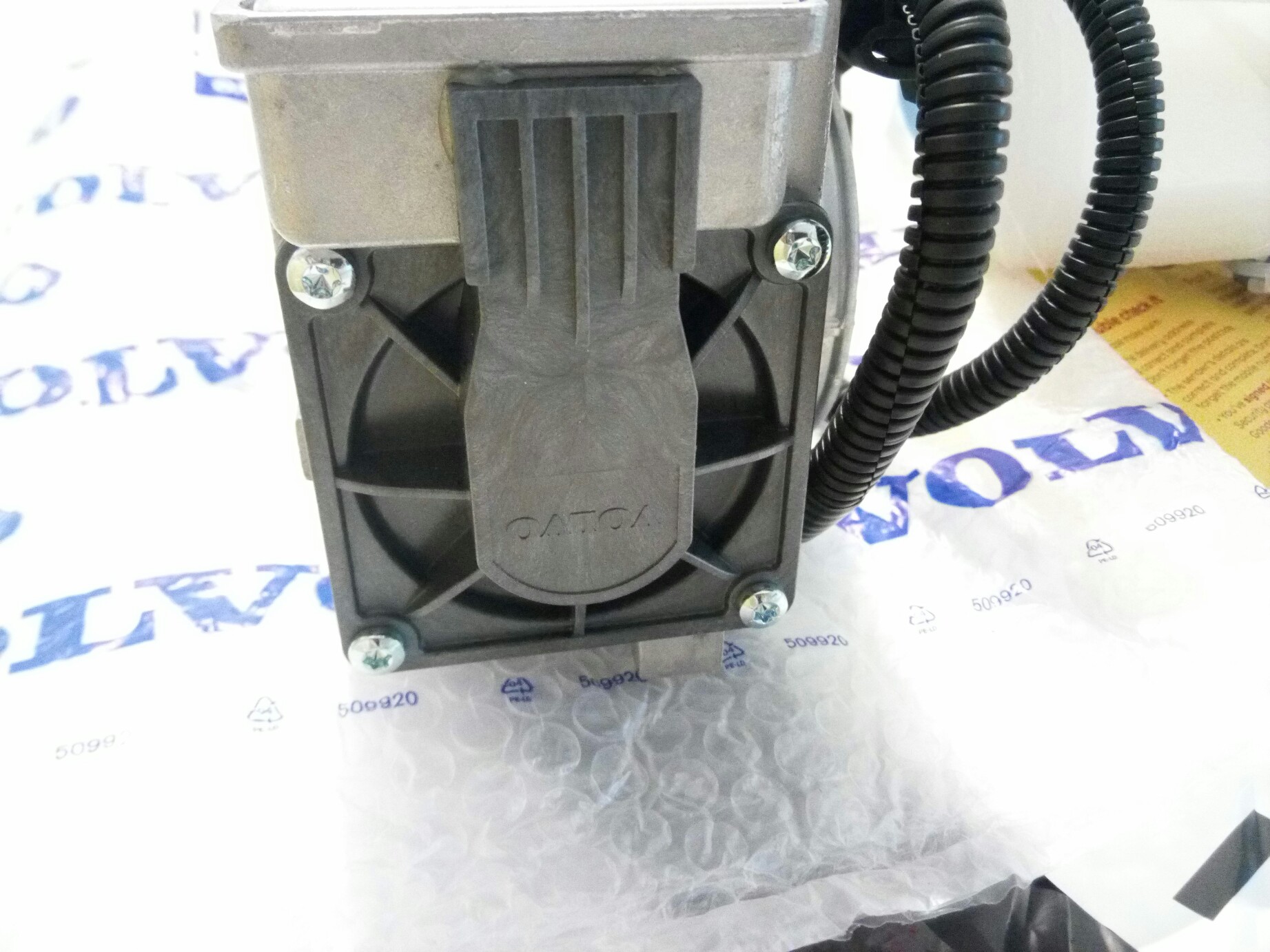

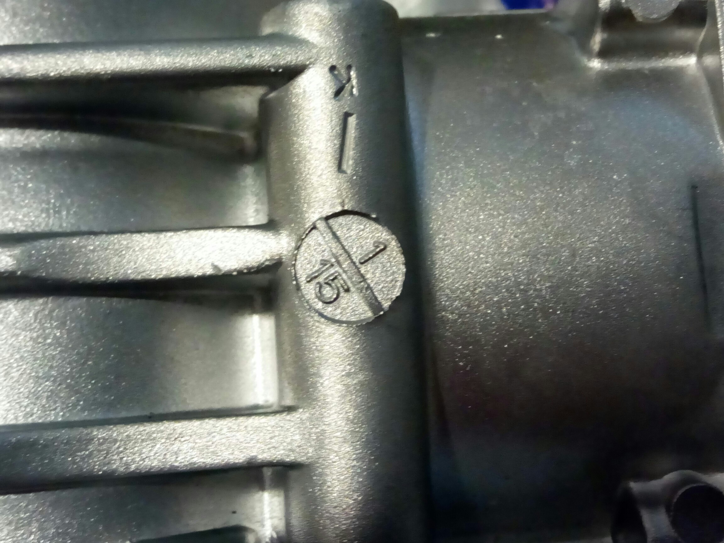

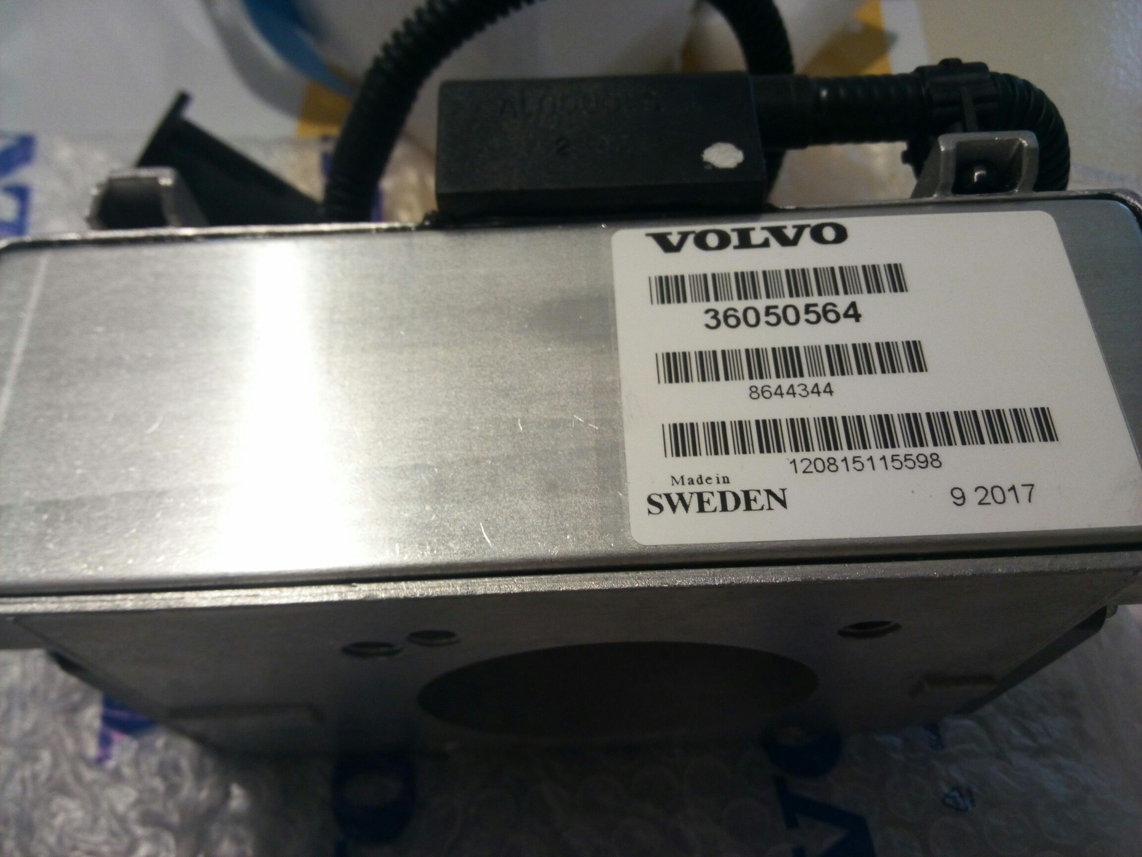

Volvo's latest new non turbo ETM 36050564 preprogrammed with software numbers 8675184 & 30785867 which suits 2002 non turbo V70 and S60.
They are new (example here had 2015) January stamp, are Made In Sweden and have a re-badged contactless sensor.
Unlike the turbo version and pre 2001 version part number 36050563 which are rebuilt in Italy and can be early 1999 builds these ones are BRAND NEW. Also they can be programmed to suit all ETM cars regardless of year or aspiration.

I still think that BRAND NEW Etm has no firmware. Because i've seen ETMs like this with old software uploaded.
So I think that all "NEW" ETMs with working firmware are refurbished ones.
If you have questions about Volvo firmware ask me. I may know an answer
precopster
- Posts: 7543
- Joined: 21 Aug 2010, 00:20
- Year and Model: Lots
- Been thanked: 128 times
Yes that's right Henry, the brand new ones were blank but new ones are no longer available under part number 8644347, 8644344, 36001821 & 36001822 so we have to buy these now or a XeModex.
This is the first 36050564 I've ordered. It was ordered directly from Volvo.
All the other ones under 36050563 have firmware for turbo 2001 cars. One day Volvo will run out of them totally and we will only have XeModex as an option unless I can work out how to rebuild the boards.
