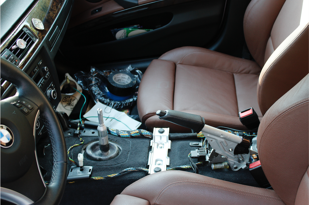

BlackBart wrote: 14 Jan 2020, 11:05 b m dubya - Unrelated to 850s, but I found a very nice 2011 E91 wagon here and sent pics to a few friends. An old friend from Seattle out of the blue said, Oh, could you go look it over and drive it for me? I did - very nice car. He flew out, spent the weekend, we scrambled to get real snow tires on it at Costco - last set of Blizzaks in that size - and he headed back. Pretty insane, and I hope everything continues to work well on it.
E91 3-series wagon. 328iX, AWD. Sport package. 17" wheels. Auto...but they live in heavy traffic. No iDrive or extra gadgets or outdated info screen. 45,000 miles! Interior looks like it was hardly used. Very well put together. Tight steering and great brakes, so solid. Glad I drove it on a dry sunny day before the storm. The last great BMW NA straight 6 engine, the N52 3.0 with magnesium block. The only things that make me nervous are electronic oil level sensors (no dipstick) and an electric water pump.
Screen Shot 2020-01-18 at 5.46.24 PM.png (1.42 MiB) Viewed 699 times
The Sport Package ("ZSP" in Bimmerese) (my E91 above) includes different seats and a different steering wheel, some cosmetic differences and different wheels, and on RWDs included different suspension components. ZSP on the AWD included the cosmetic and interior features, different wheels but not a different suspension.
BMW charged the same $ for the ZSP on both RWD and AWD versions.
