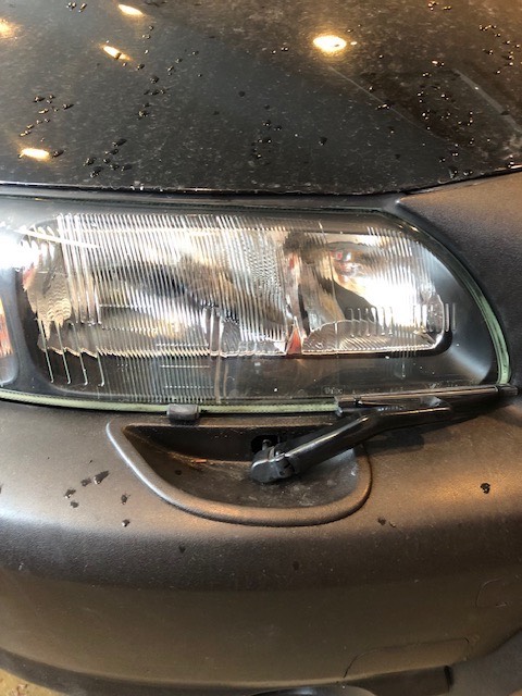

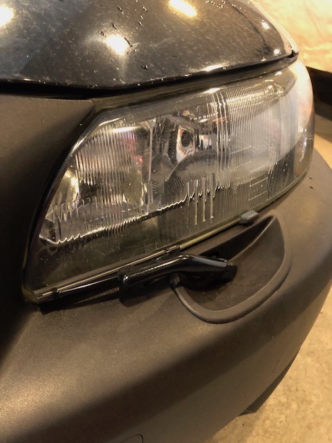

Installed a headlight wiper motor that I rebuilt and new wipers, while the bumper was off I replaced a fog light that had smashed and repainted the wiper arms. Both items are good to have on hand as junkyard spares. The IPD house brand wipers fit well but only last about 6 months. I guess I'll spring for the expensive Volvo ones next time and see how long they last and see if its worth it. Went for a good drive in the fresh snow and marvelled at how well the AWD and Michelin X-ice's handle slick roads!

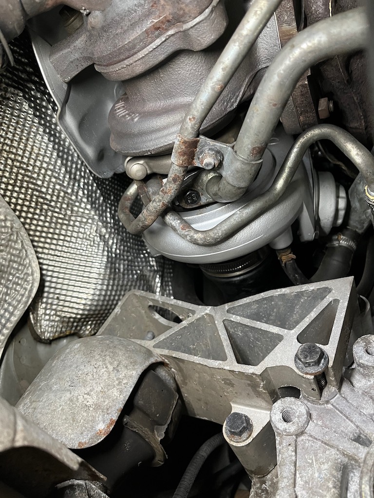

Last night I decided to drop the undertray to check if my leaky turbo was cured and I'm pleased to say it's all nice and dry
View from the top

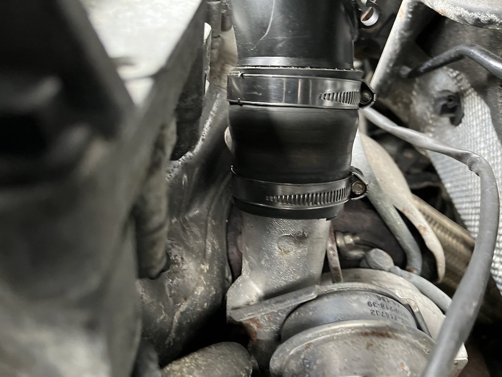

When I reviewed the above image on the computer I thought the hose connecting the turbo to the charge pipe looked a little squint and dug out a picture I had taken earlier in the year when I changed the hose. Sure enough something wasn't right.

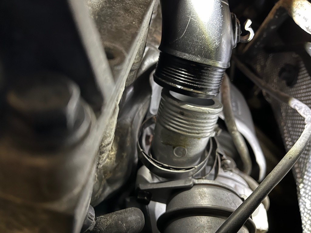

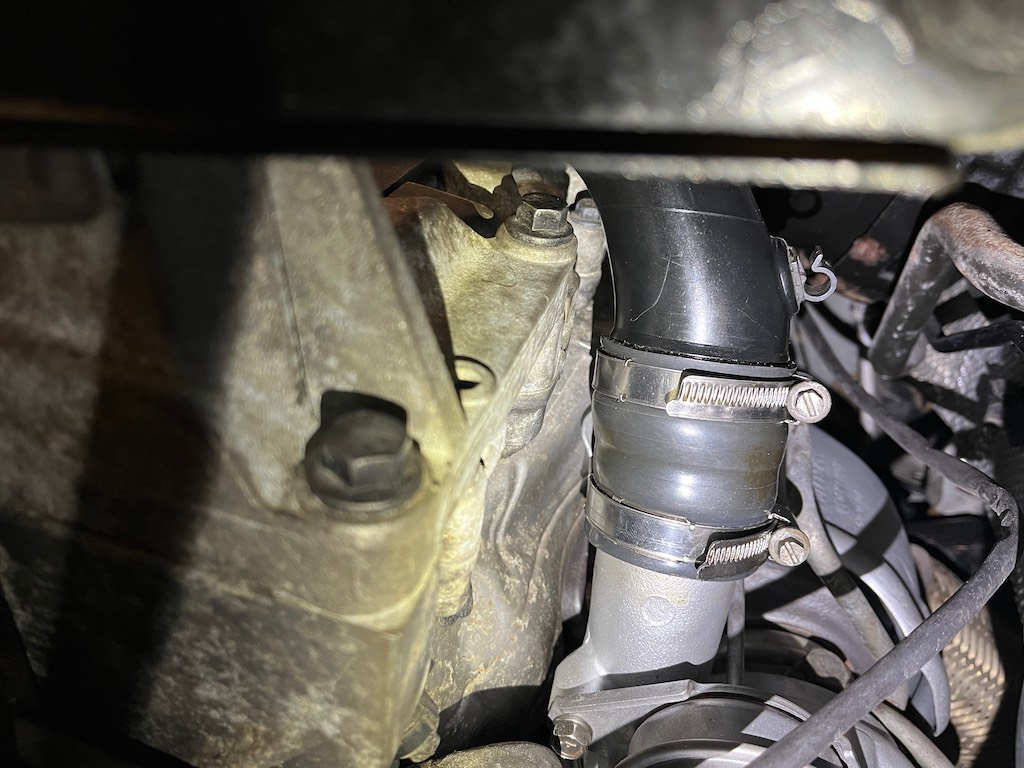

Picture from a few months ago So this morning I decided to have a closer look at it. When I removed the hose it was obvious the charge pipe has went a bit skew-whiff as it wasn't lining up with the turbo. With a gentle heat from a hot air gun being careful not to get it too warm I reshaped it back to its correct position. I'm unsure if the charge pipe will have any 'memory' during heating/cooling cycles so will keep an eye on it over the next few weeks to ensure it doesn't go out of line again.
Back together and much looking better
