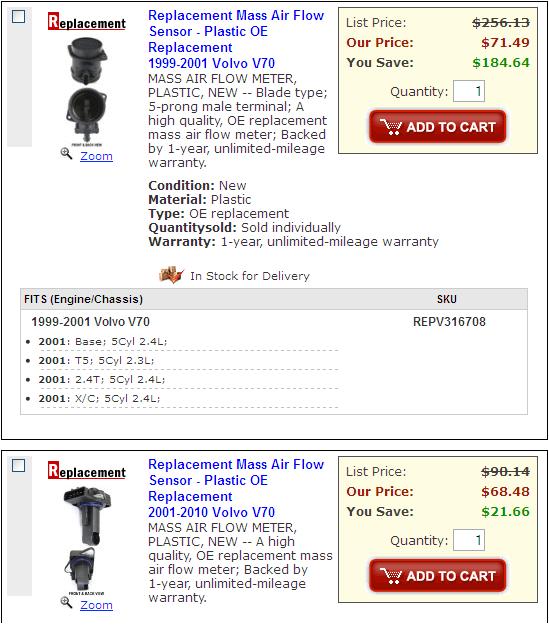

The lowest price for MAF sensor on this website is over $68 now.
- maf sensor price.JPG (70.71 KiB) Viewed 3416 times
