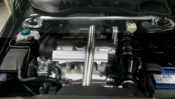

My 2 cents for using an open filter on our engines. I bought one with a massive velocity stack which aids in increasing the incoming air speed.
Volvo S80 2.4T Fitting a Velocity Stack Open Cone Filter by Andy Ramdin, on Flickr
And how it looked in the engine bay without a heat shield.
I removed it again. Even though the compressor whine and blowoff sounds are addictive, I still think the original air box is better. I made a small modification to the intake, by removing the plastic flap and using a piece of bent aluminium for direct air intake.
Volvo S80 2.4T Air Intake Mod by Andy Ramdin, on Flickr
