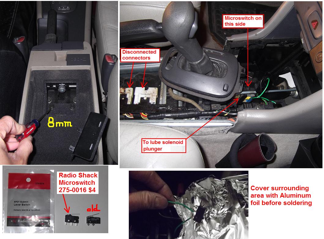

A photo in case people need it (to supplement the excellent DIY already written by others).
1. Remove 8-mm screws in the center console.
2. The trim piece right below parking brake handle: slide it to the LEFT to remove it.
3. Look straight down, you will see 2 connectors (white color), use a long screwdriver to disconnect these.
4. Undo the heater switches, cigarette socket as you move the console rearward.
5. The shifter console itself sits on a few clips (look under and you will see them).
6. Lube the solenoid plunger with WD-40 etc.
7. The microswitch sits on the driver's side.
8. Cover surrounding area with Aluminum foil before soldering in new microswitch.
PS: The shifter illumination bulb is on the driver side. It was Sunday, I used Radio Shack bulb and it worked (instead of spending $10 at dealer). I wrote it up in another thread.
