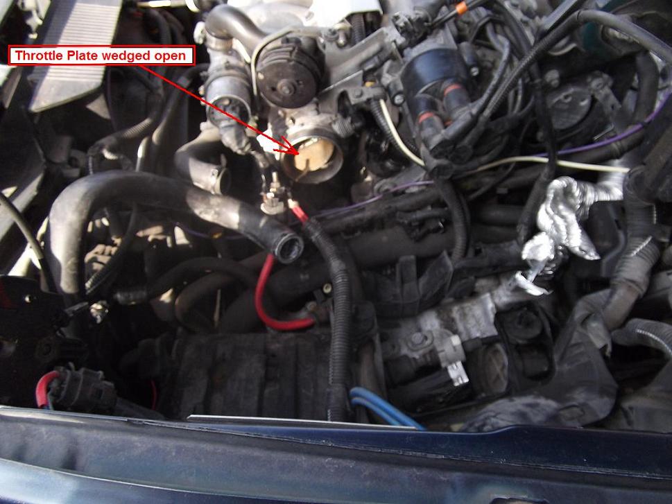

1- Throttle Body was deformed during crash and the throttle plate is wedged wide open, causing engine to surge to 6000 rpm!
