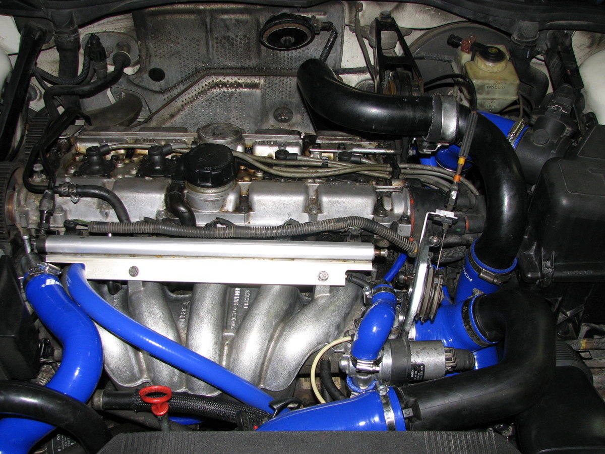

My goal this week is to do the 3'' n/a intake and throttle body.
Silicone turbo and coolant hoses.

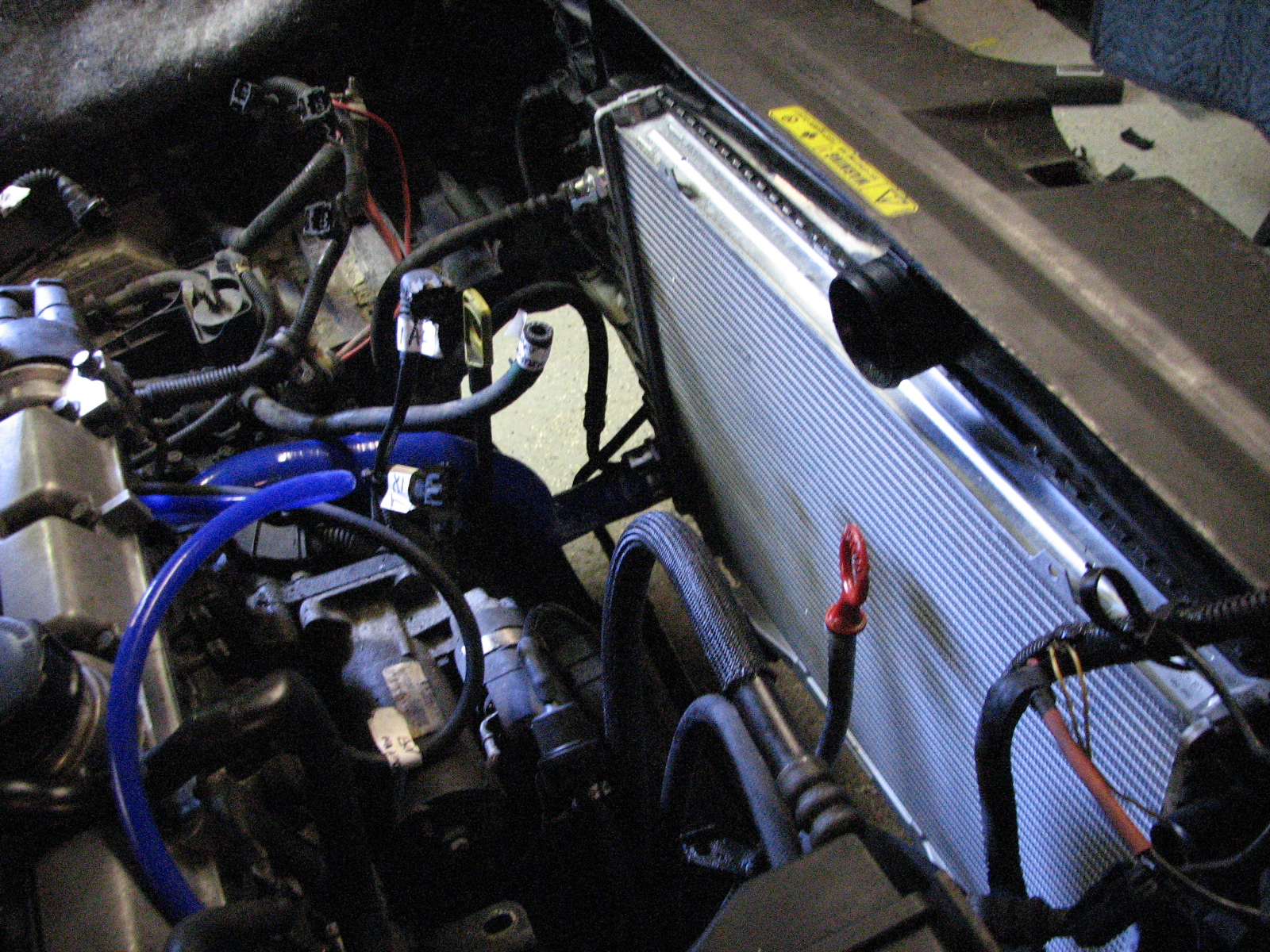

Now a new radiator, since seeing its deterioration. A few drips of antifreeze on the tanks, and the bottom steel strap is fairly rusty.
Timing belt, Gates Blue, Aisin tensioner, INA pulleys, Aisin water pump, Nissens Turbo radiator.
If everything ships on time, I will be done with all this by Friday.
I still have the R exhaust manifold, Drilled and slotted rotors, Akebono pads, e-brake shoes and more.

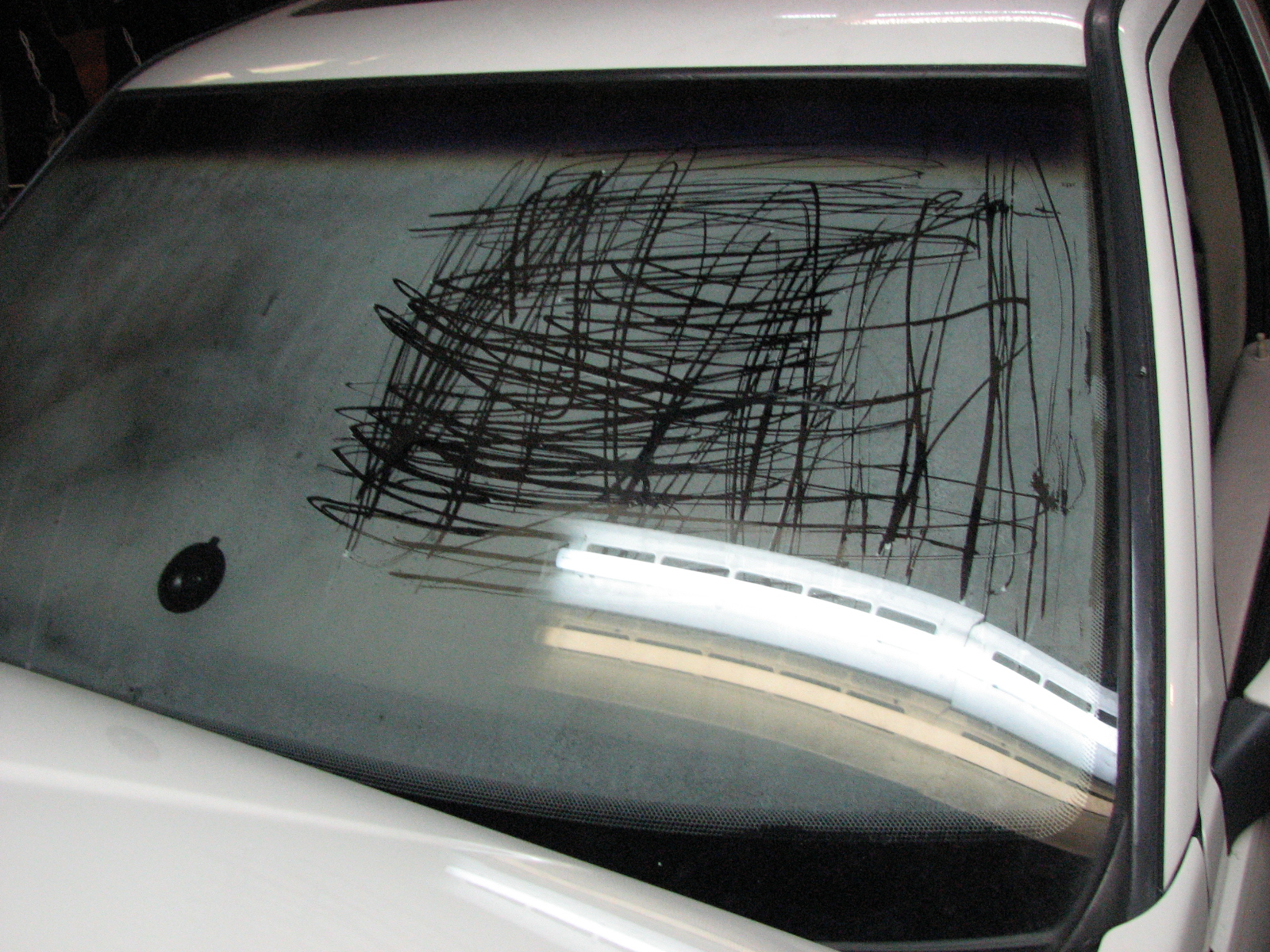

ECC needs to be sorted out. Inside frost.
Thawing out.
Thawing out.

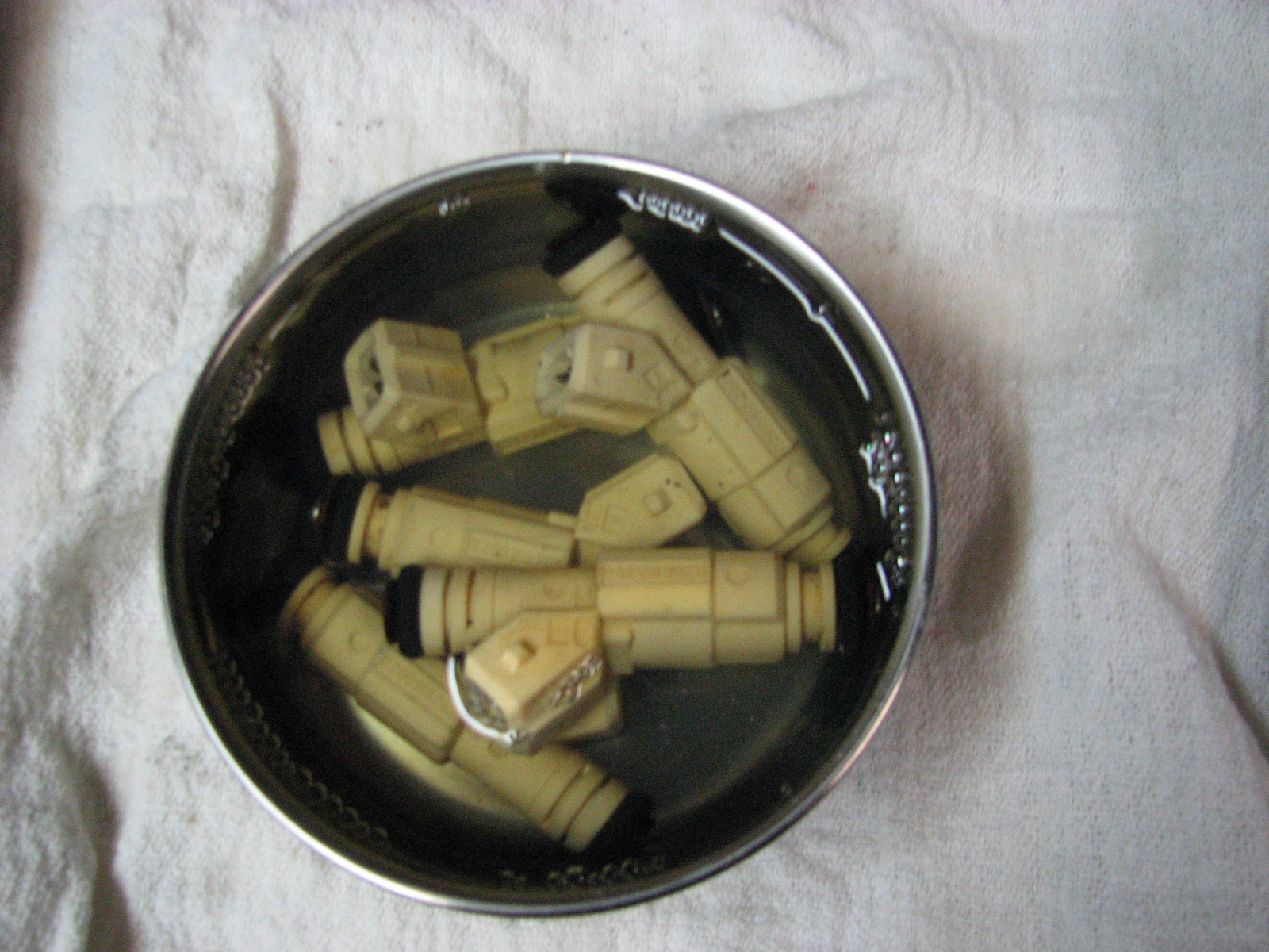

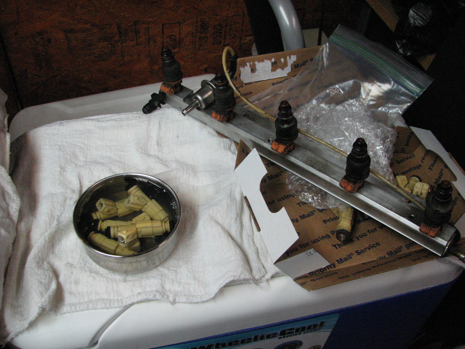

Pampering White injectors in a Seafoam bath.
Fuel rail awaiting.
Fuel rail awaiting.

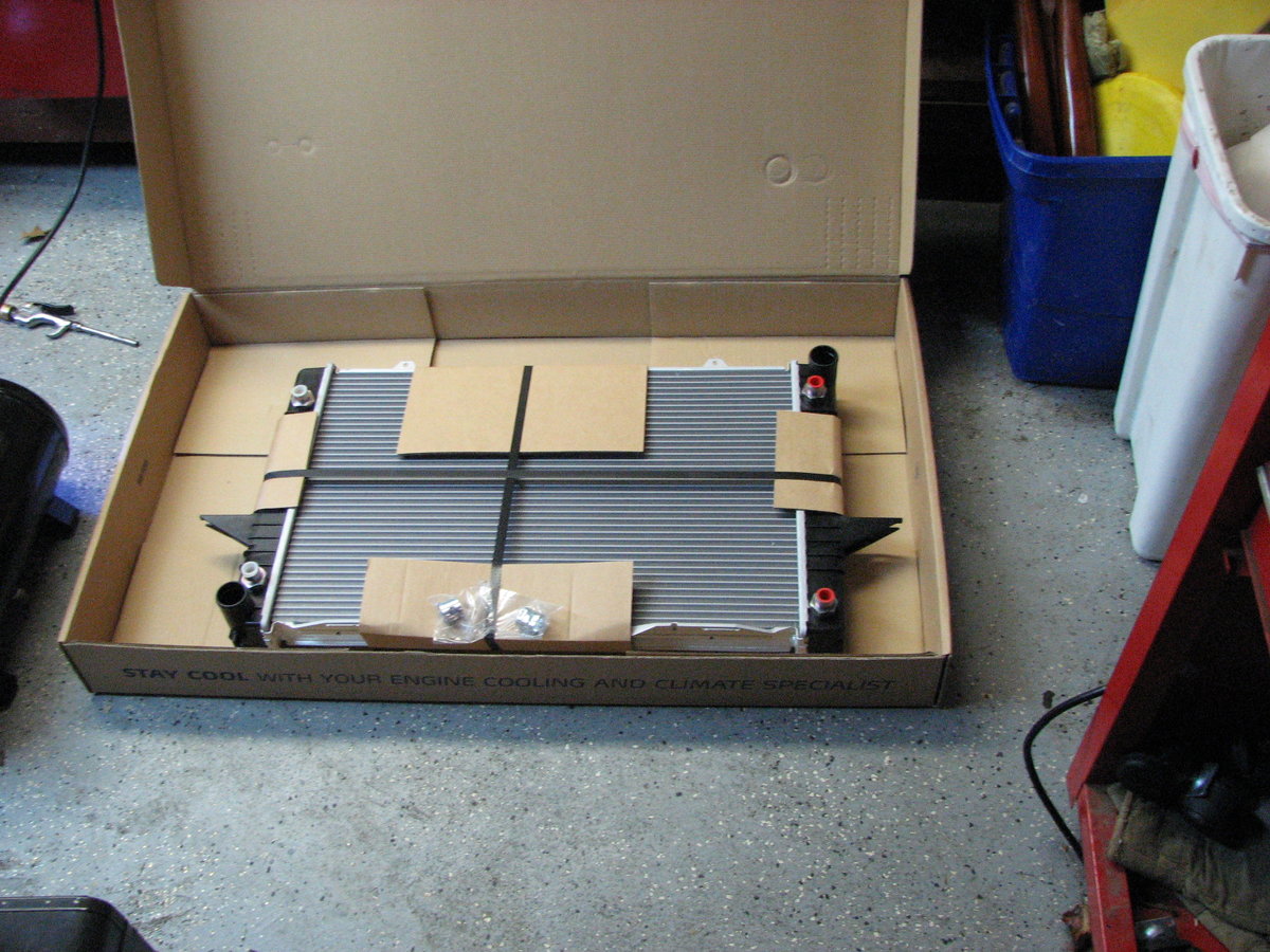

I set up an emergency control center to order a new radiator, and whatever else may come up.
Control Center on an air hockey table.

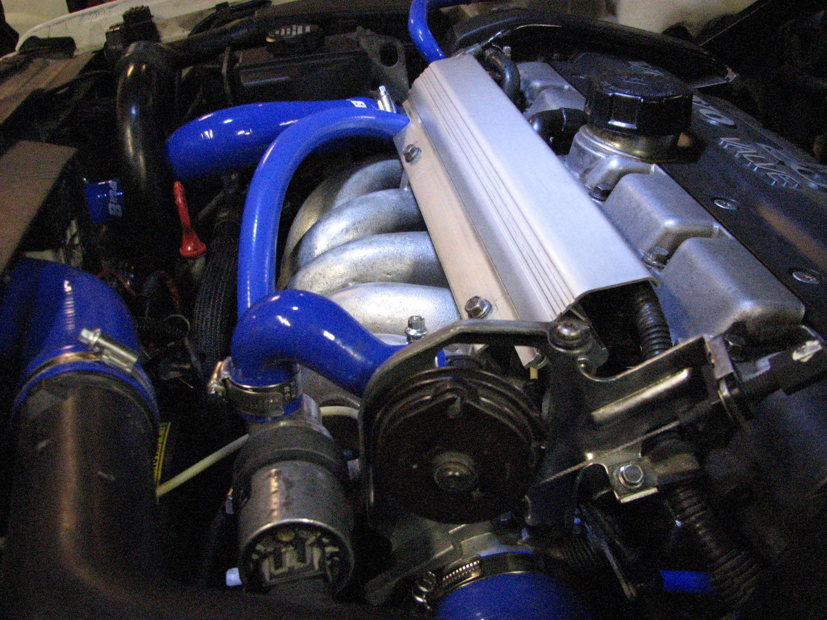

3" air tube, silicone turbo hoses,3" valve body and N/A intake, silicone coolant hoses, thermostat, coolant temperature sensor, installed so far.
Unexpected new radiator as well. There were antifreeze drips on the old radiator and it looked tired.
This was like opening a Christmas present.

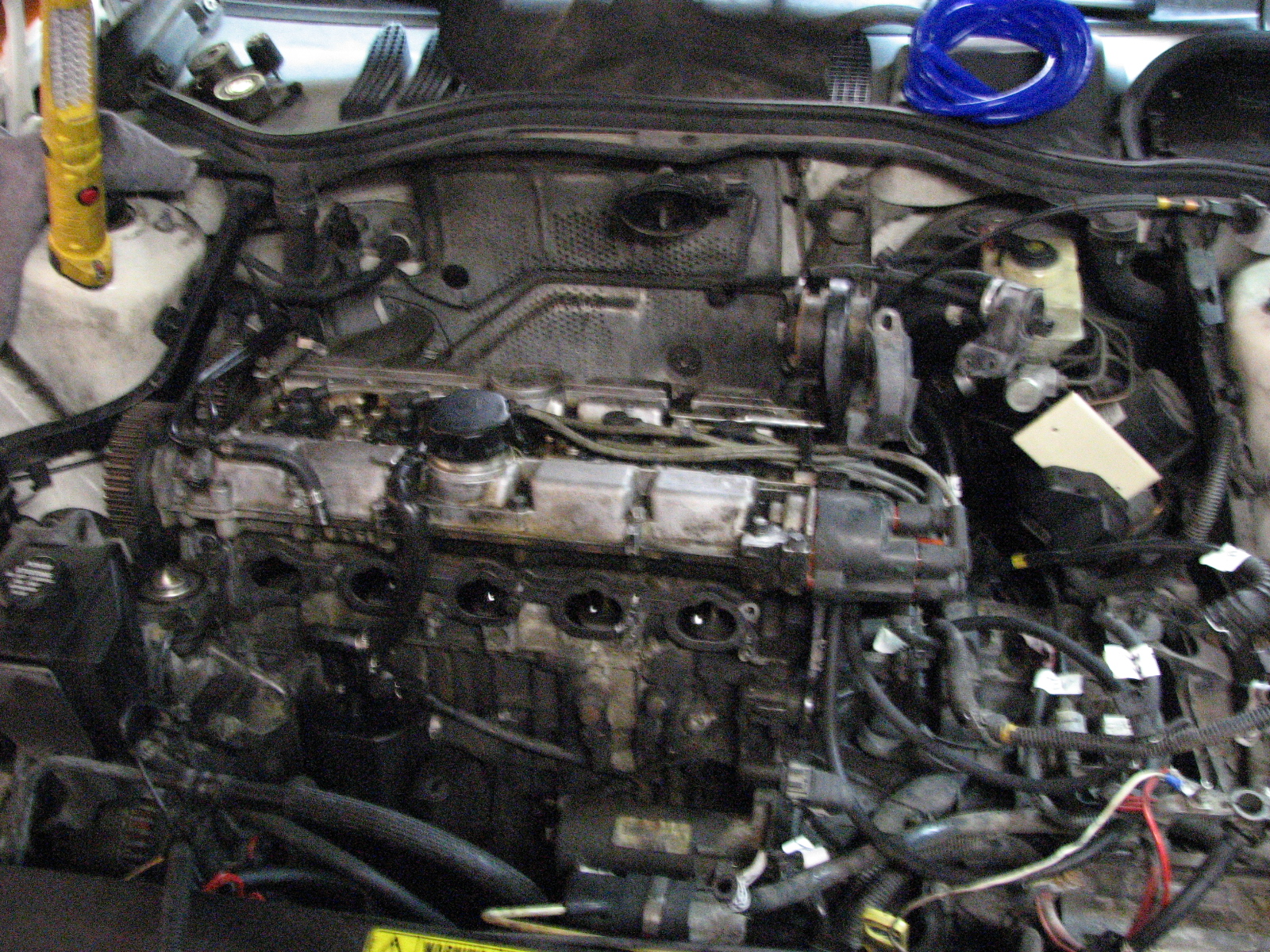

Manifolds on day 1.
Manifolds on day 1.
End of Day 2.
End of Day 2.

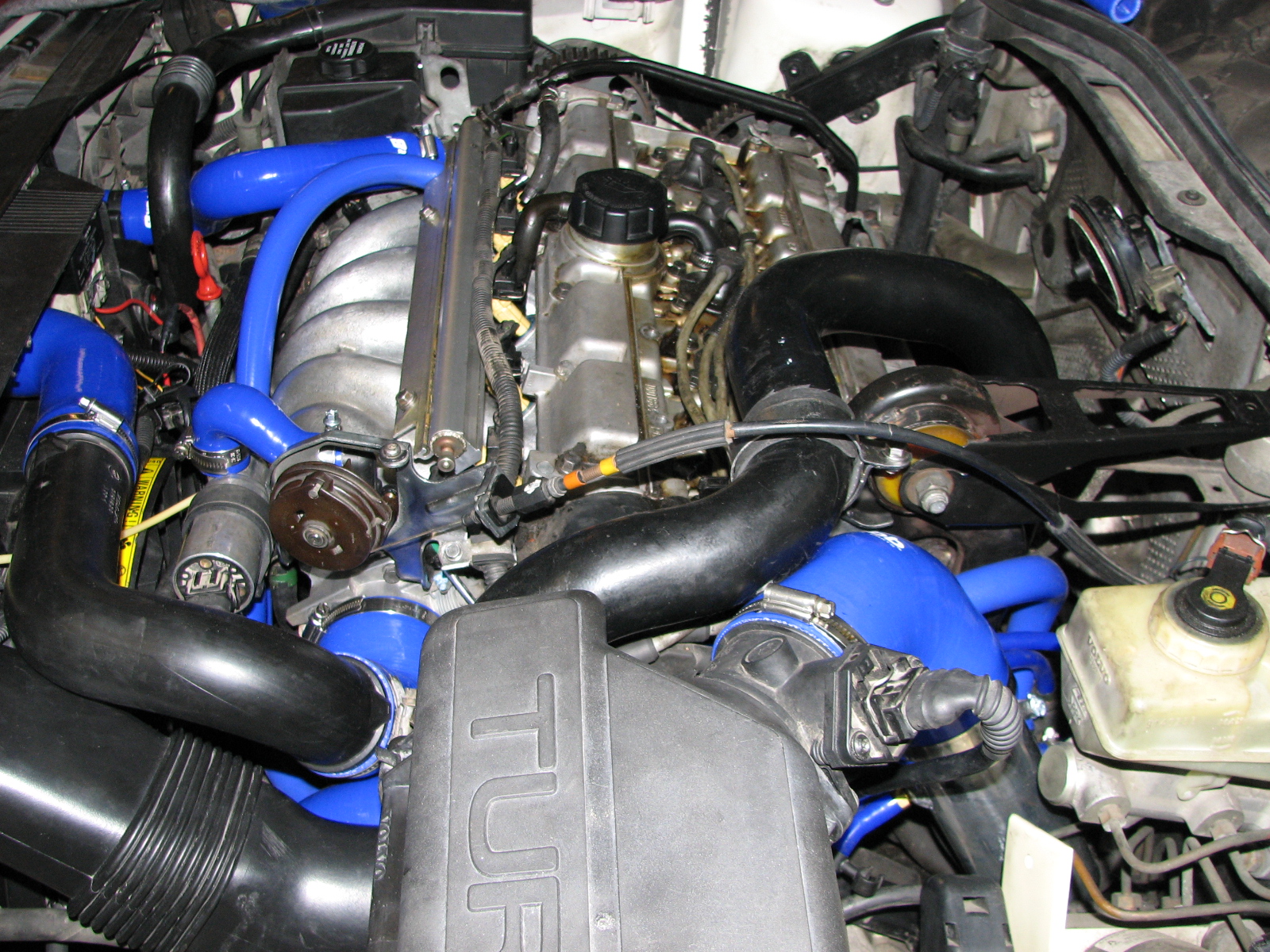

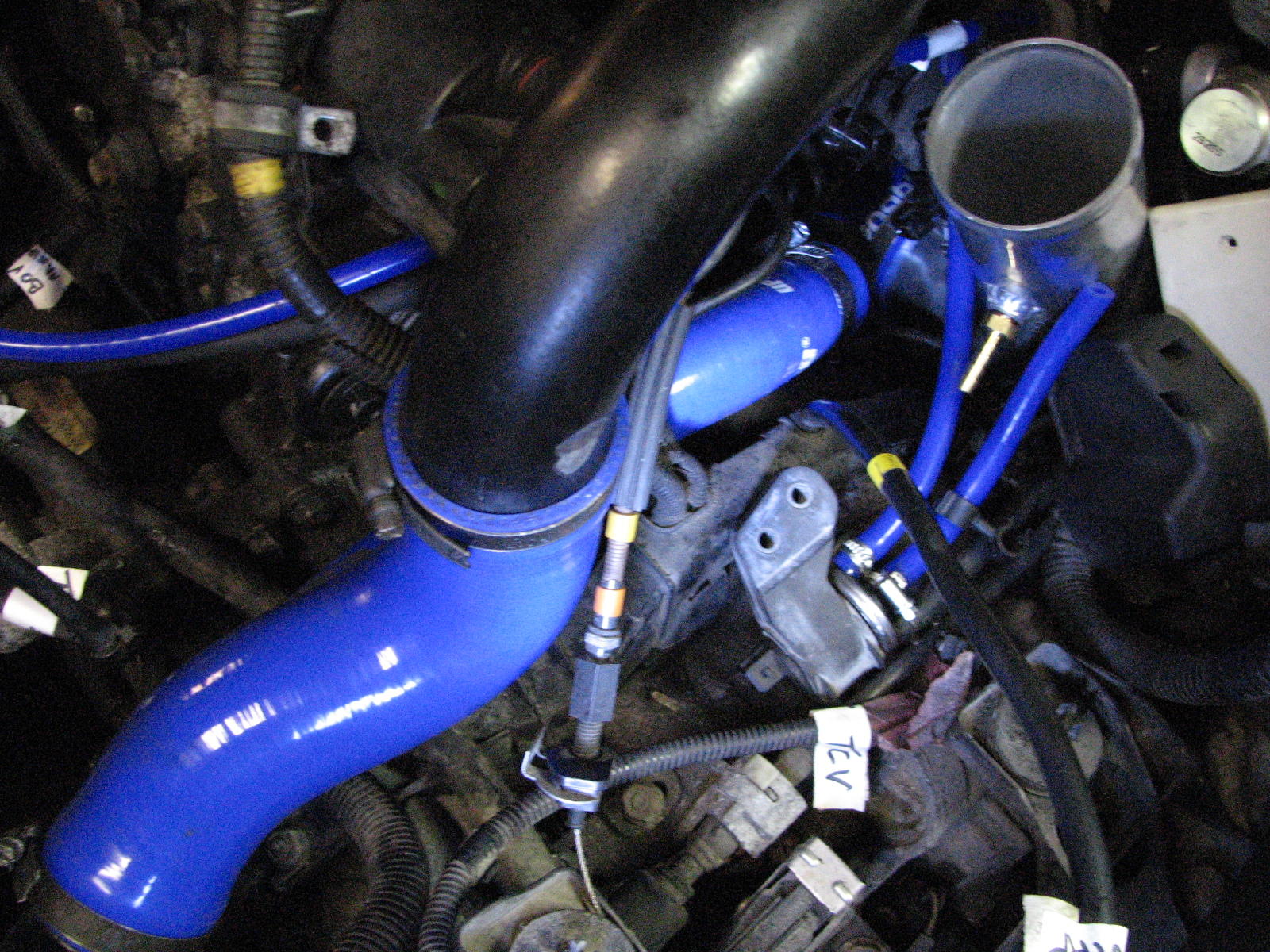

3" intake tube Day 3.
End of Day 3.
End of Day 3.

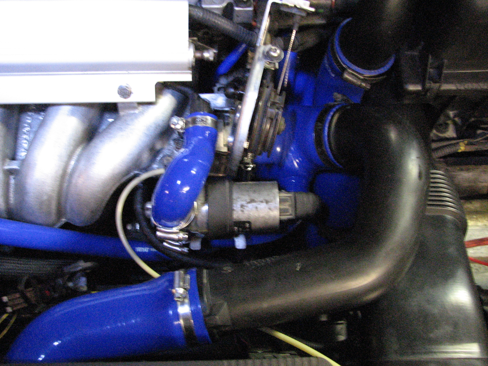

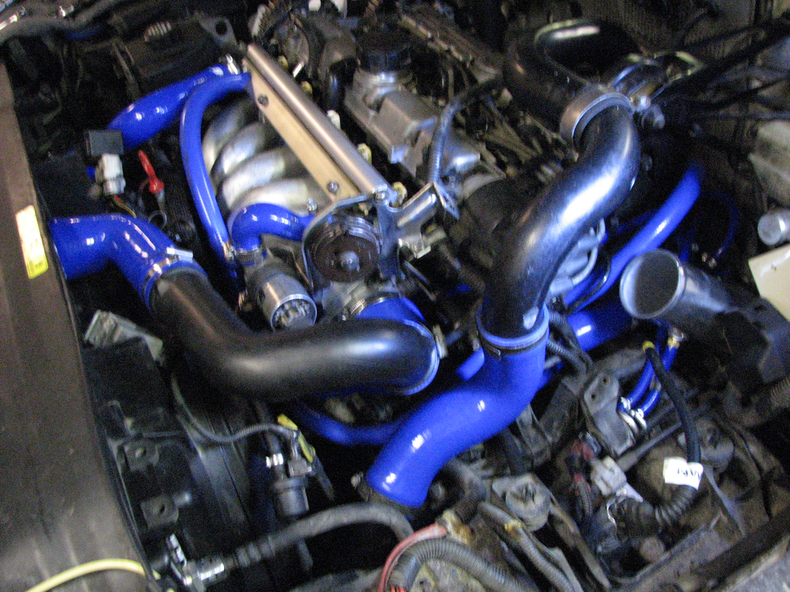

Turbo and coolant lines, manifold Day 4.

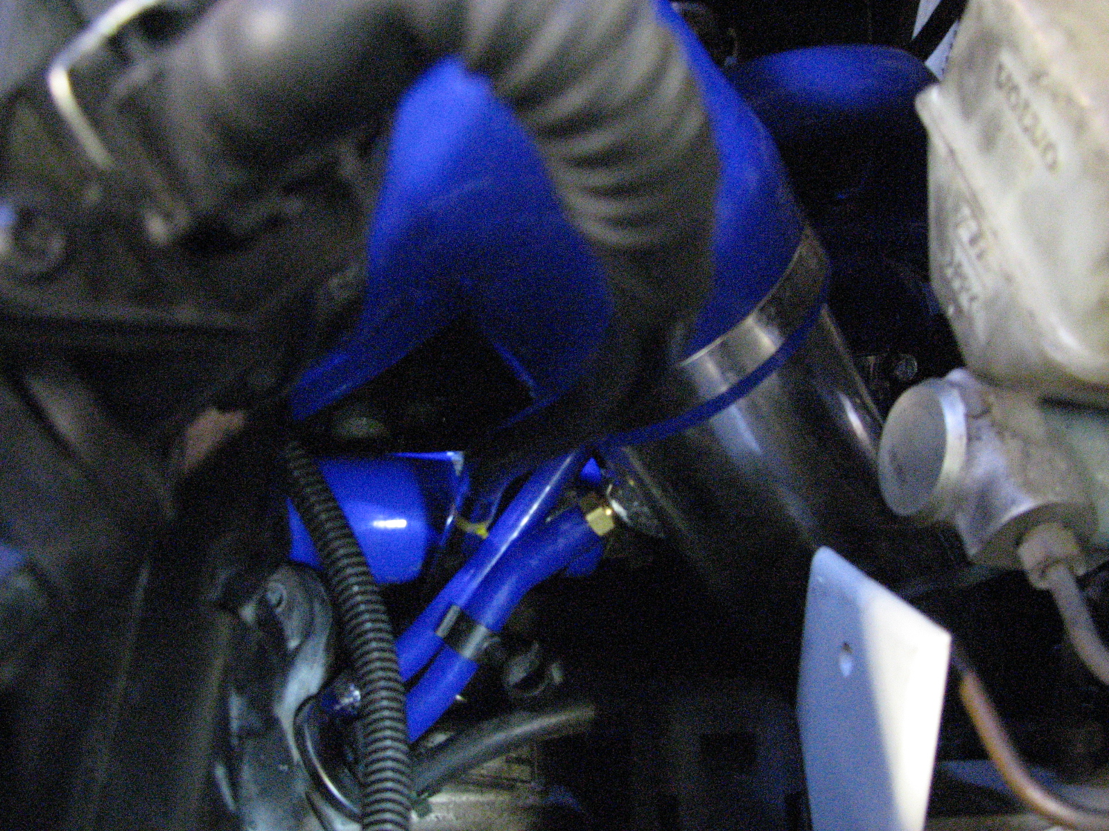

Air intake to Turbo with PTC and hoses.

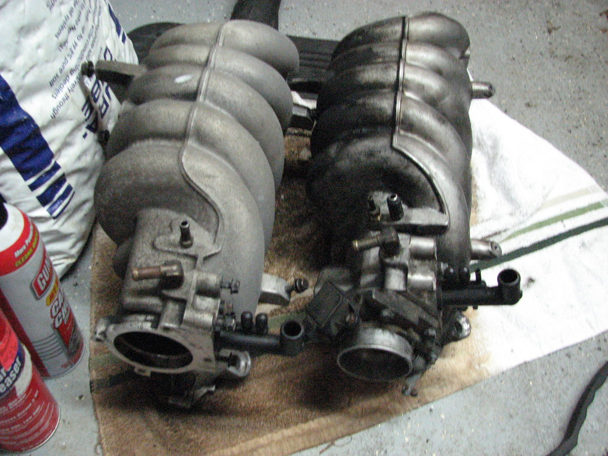

The N/A manifold is larger and things became tight with 3" hoses.
One more day to go.
One more day to go.

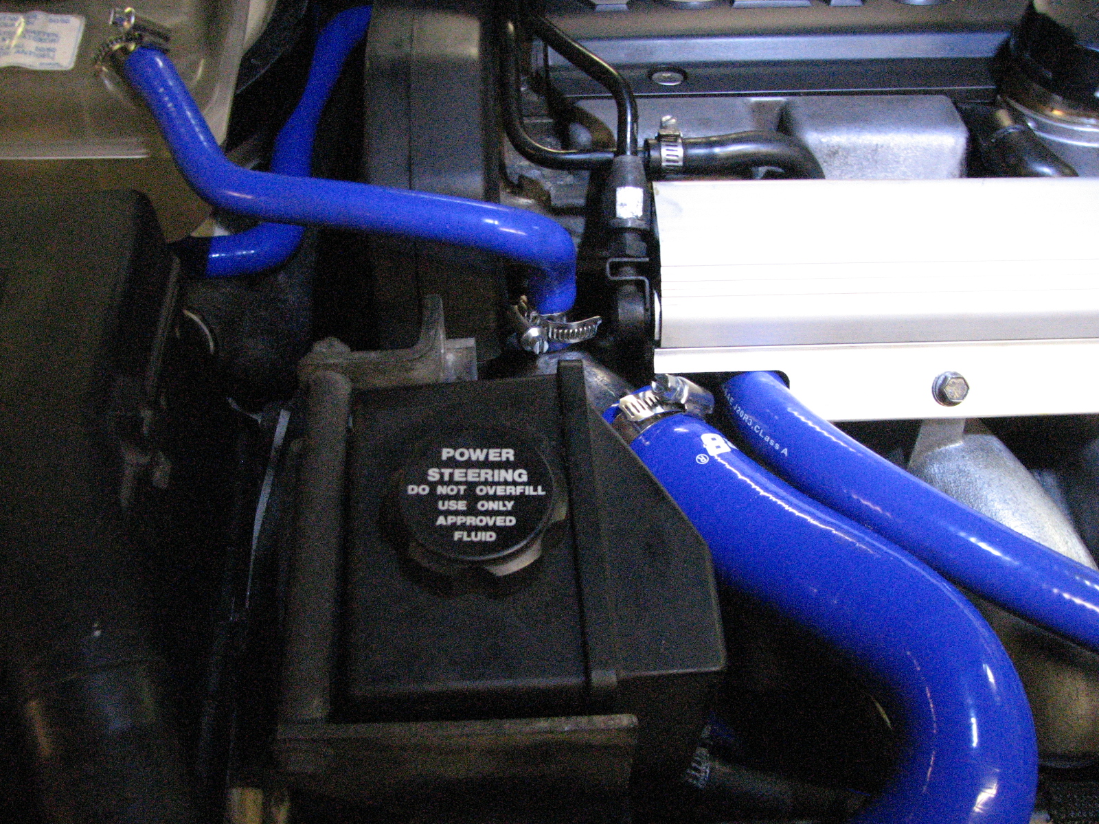

While I was buying silicone line and hoses, I did the PCV 5/8" to PTC in blue silicone heater hose as well.
The water pump is late in coming. It will be here tomorrow and I can finish installing the timing belt, pulleys and tensioner.
Also waiting are the serpentine belt and its pulleys for the water pump to get here. Lastly will be the expansion tank silicone hoses.

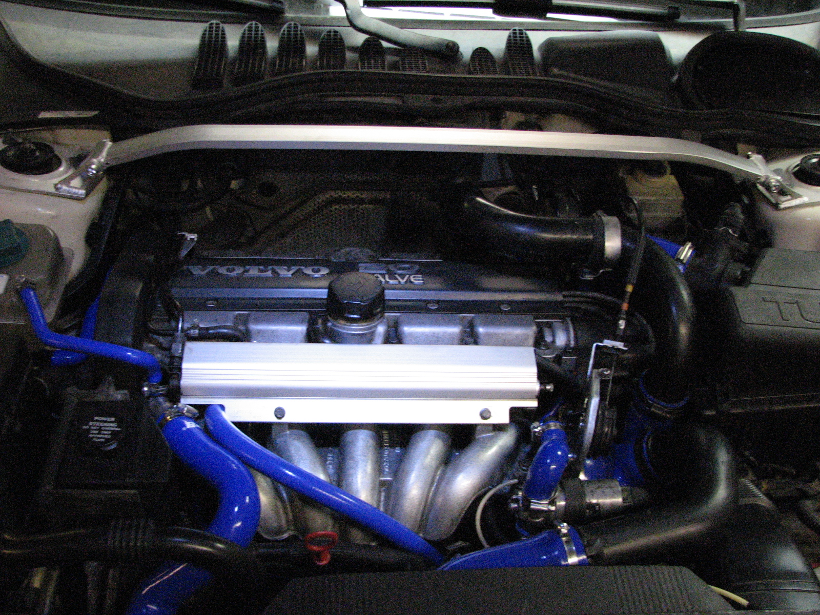

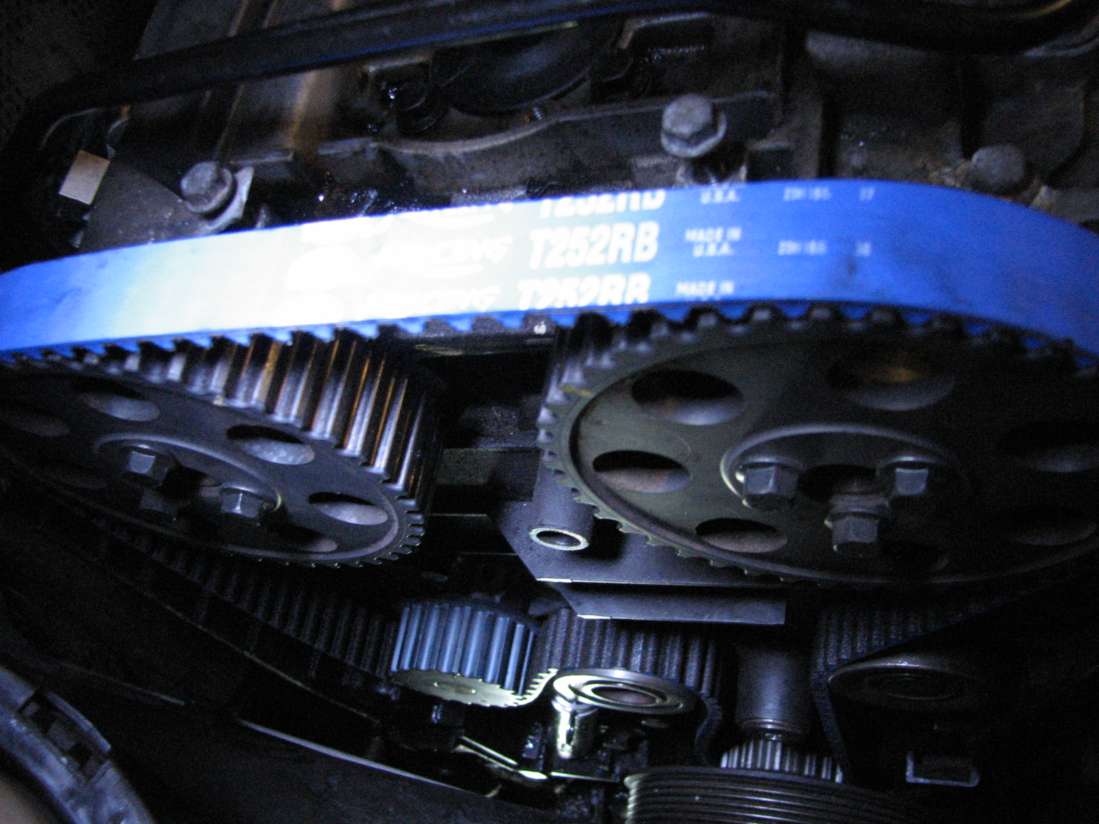

I received the water pump today, so I finally was able to install the new Gates Blue Racing belt, the new Continental serpentine belt with new idler and tensioner pulleys.
Gates blue.
Gates blue.
The previous owner only had the car for a year. He was moving and lost all the maintenance documents. He said the owner before him had the timing belt done but did not know what was actually done.
I found a new belt and INA pulleys. The INA pulleys are what I had also bought so I sent them back. The hydraulic tensioner was not new and appeared to be leaking so I used the new Aisin tensioner that I had bought.
The water pump appeared to be new but I had seen stains at the weep hole. Again, I replaced that with a new Aisin and new bolts with thread sealer.
With everything bolted up, I changed the oil and filled the cooling system with straight distilled water mixed with about 5 ounces of Cascade dishwasher fluid for an initial flush.
Dropped in the battery. Turned the key to position II. Waited about four seconds. Turned the key, and it started right up.
I was happy.
I did another coolant flush with distilled water only, and refilled with Zerex G-05 mixed 50/50 with distilled water.

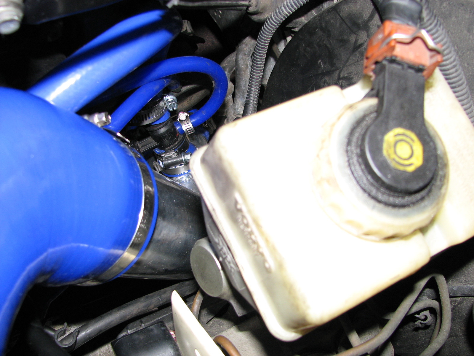

Swedish Expansion Tank Hoses. Silicone 5/8" heater hose, Oil trap to PTC.
3" Intake to turbo tube.
Everything is playing nice together.
3" throttle body Silicone IAC hoses.
All Buttoned up with an inexpensive OBX strut bar.
Don't make fun of the strut bar. It is functional until I decide to be a track terror.

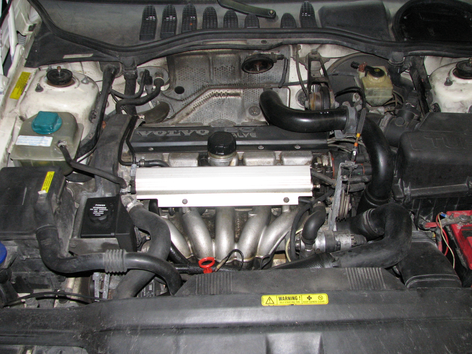

Test drive went well today. Weather is going to be in the teens this week, so next week will be favorable for transferring the Wagon back to the daily driver.
The ECU took only a few seconds to realize the new injectors and airflow.
The R ECU will have to wait until next week.
Before.
Before.
After.
After.

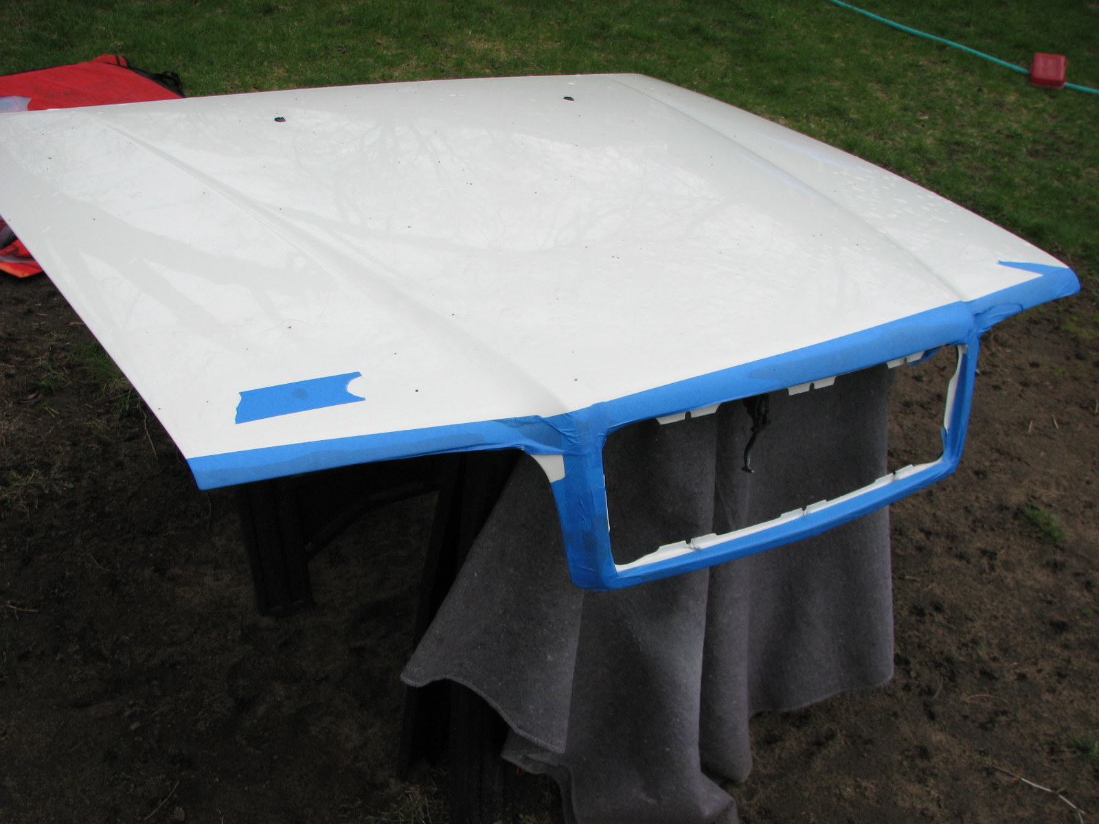

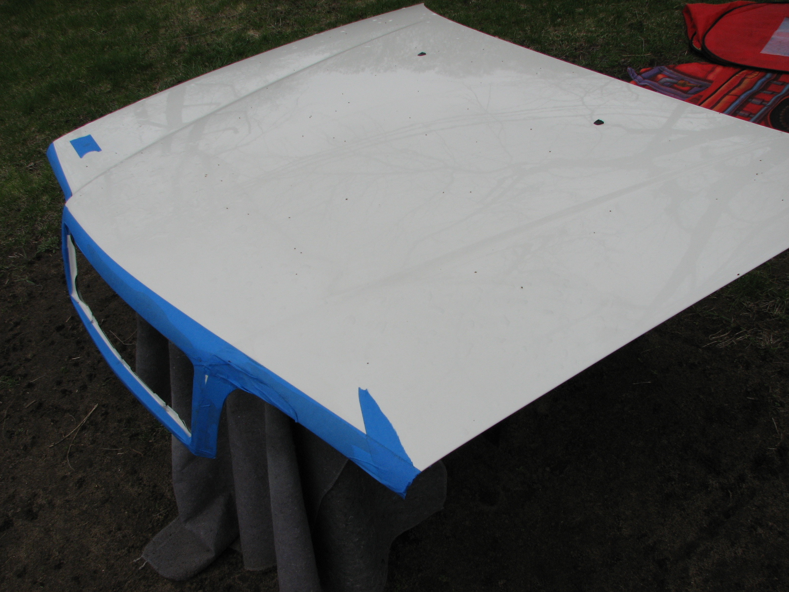

The weather is not cooperating for body and paint work. I've had the hood in the backyard throughout the winter. I would like three temperate days to let the paint cure. When I see them in the forecast, it will be done.
In the meantime, I have the prepared areas sealed with painters tape.
I did sand the areas a few weeks ago.
It sat on these saw horses all winter. Visual Michigan snow gauge.

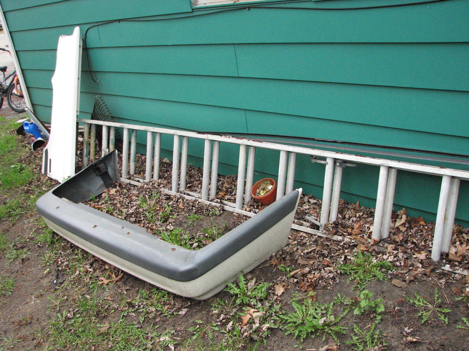

Updated bumper for the sedan. Fender as well though there is only a small dent in the Sedan.

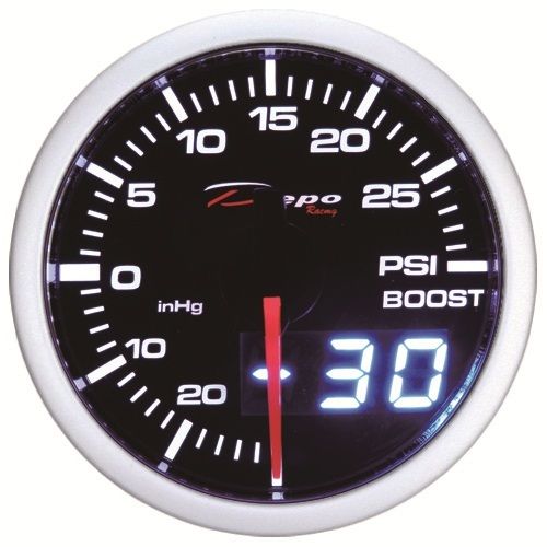

The car has been running beyond my expectations. It seems very dependable, by my design, and is not letting me down when I put my foot into it.
I have a decent electronic/mechanical boost gauge to hook up on the A pillar when I feel motivated, but it is fun watching the factory needle diving hard into the white at only about half pedal in the mean time.
It has arrived, and seems to be of quality.
Boost gauge.jpg (35.39 KiB) Viewed 6020 times
I do have the Bluetooth Android torque app on the small galaxy tablet that lets me monitor things in real time, but I now use the video function to record telemetry when I want to see what happened after the fact.
