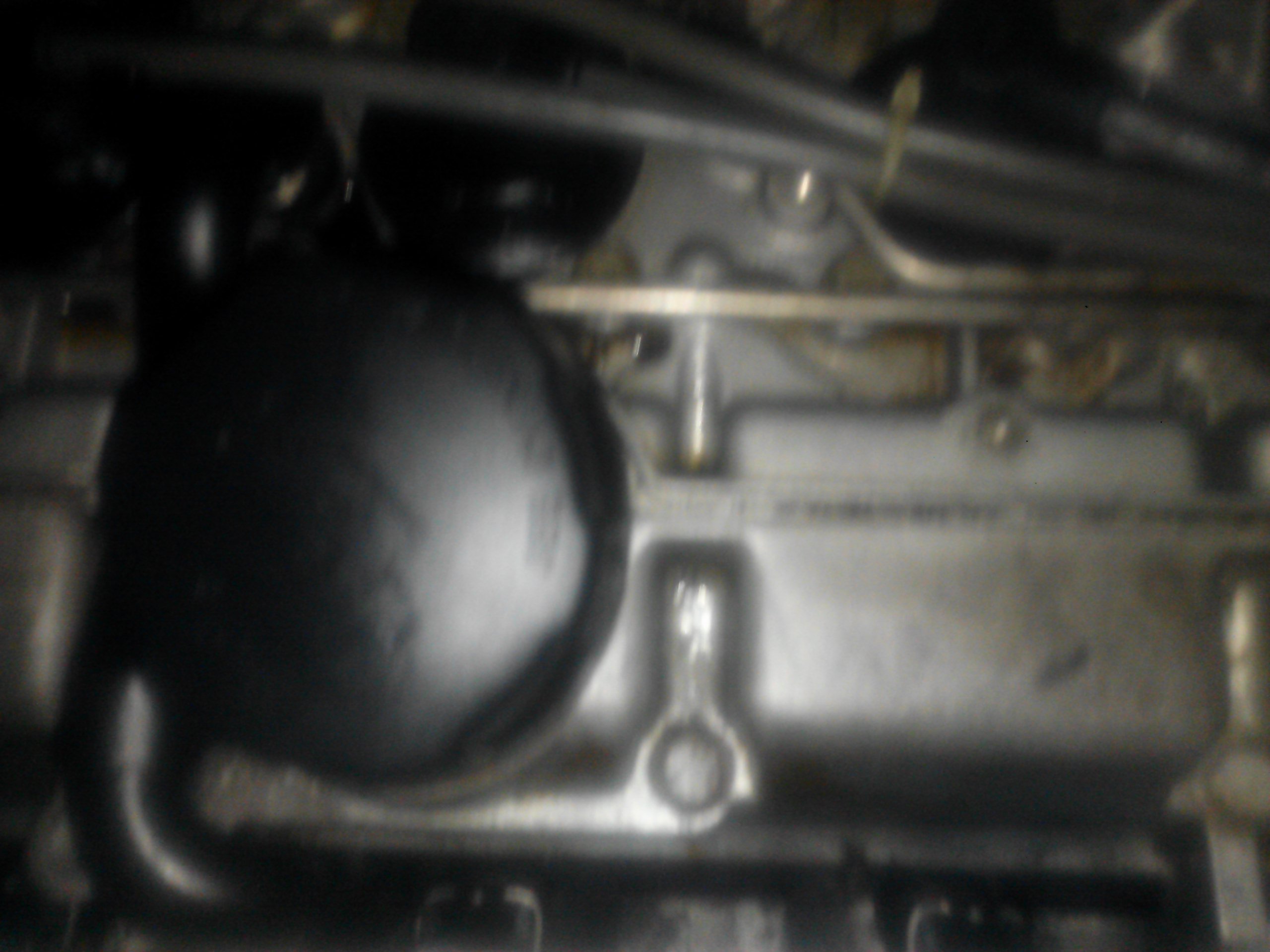

Hmm. Is that skinny metal tube still in the system? It is best just to take it out and bypass the whole thing with some vacuum hose.

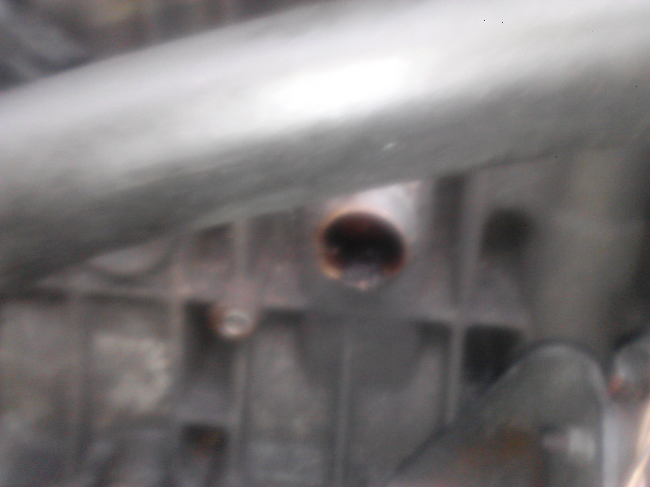

Bottom ports were completely clear?

Are you referring to this
This is how the ports looked
