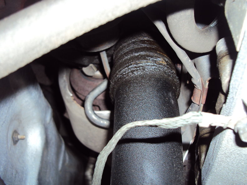

I did notice a ton of crud on the back end of the turbo intake? and back down past the air inlet, doesn't look like a good thing.
