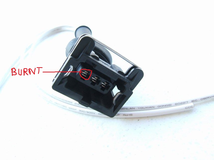

I did notice however something on the plug part that plugs into the ignition coil. On one of the pins, it seems like the silver part was missing or burnt. It is hard to explain but I have attached a photo here as an example.
The plug in the photo is a 3 pin one but the ignition coil one is 4 pin i believe and one of the pins (second one seems to be burnt, or I cant see the silver part of the connector. I will try to get a photo of the actual connector in the morning.

Well scratch that idea of the connector pin being burnt,since I just checked on my S70 and the connector on it look the same.
