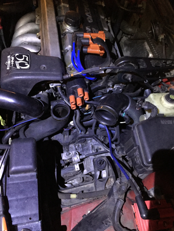

i was using an LED light and doing this at night. Odd how it affected all the colors. The new blue wires I had installed really got all whacked out. They almost look fluorescent. It's time to explore the injector now...

So my local parts shop had a cap and rotor that was compatible with my car. I went ahead and changed these items in my car as a preventative measure. Well, after doing this work in the dark, I can say that my misfire was definitely not because of the cap and rotor.
