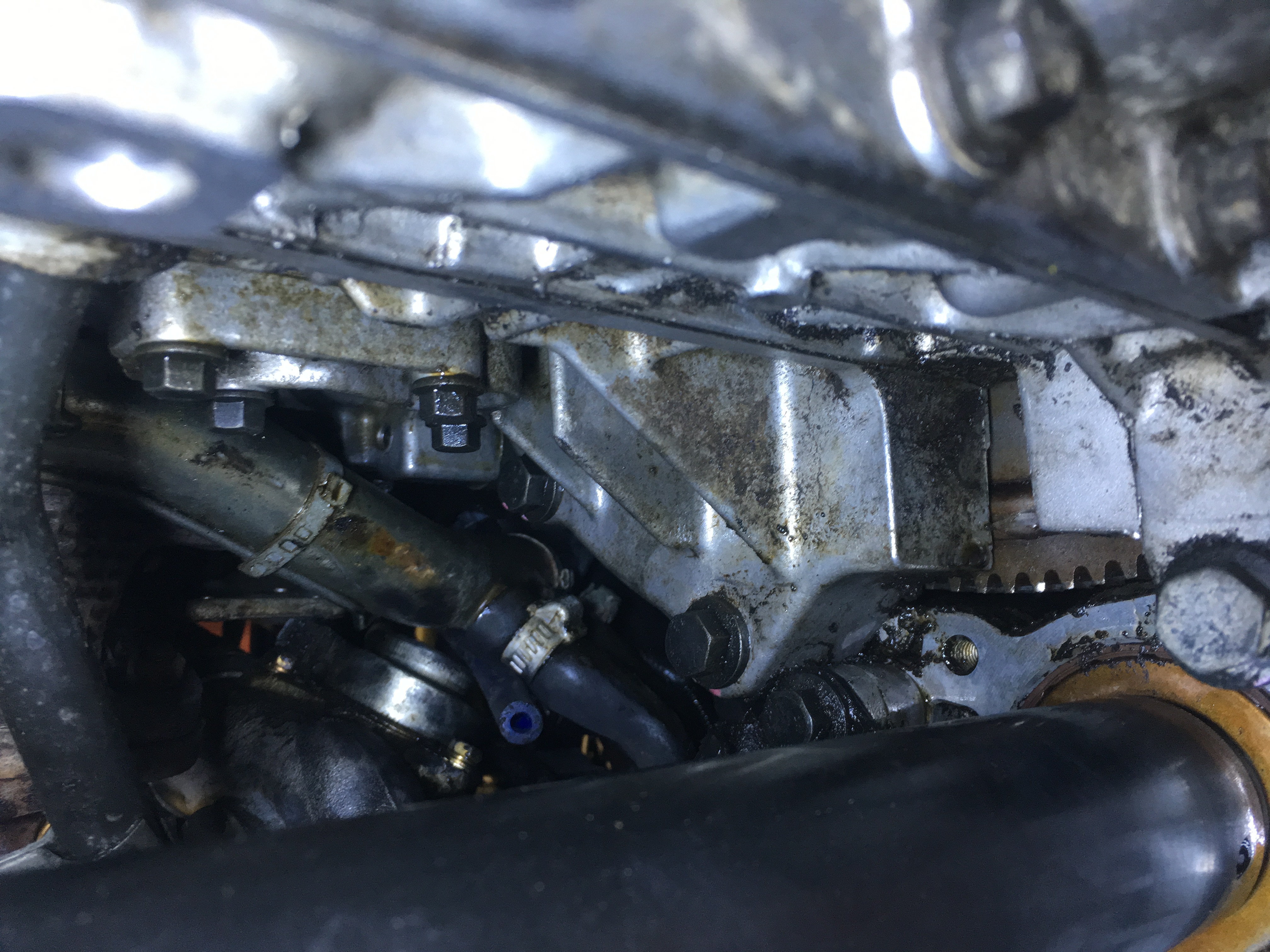

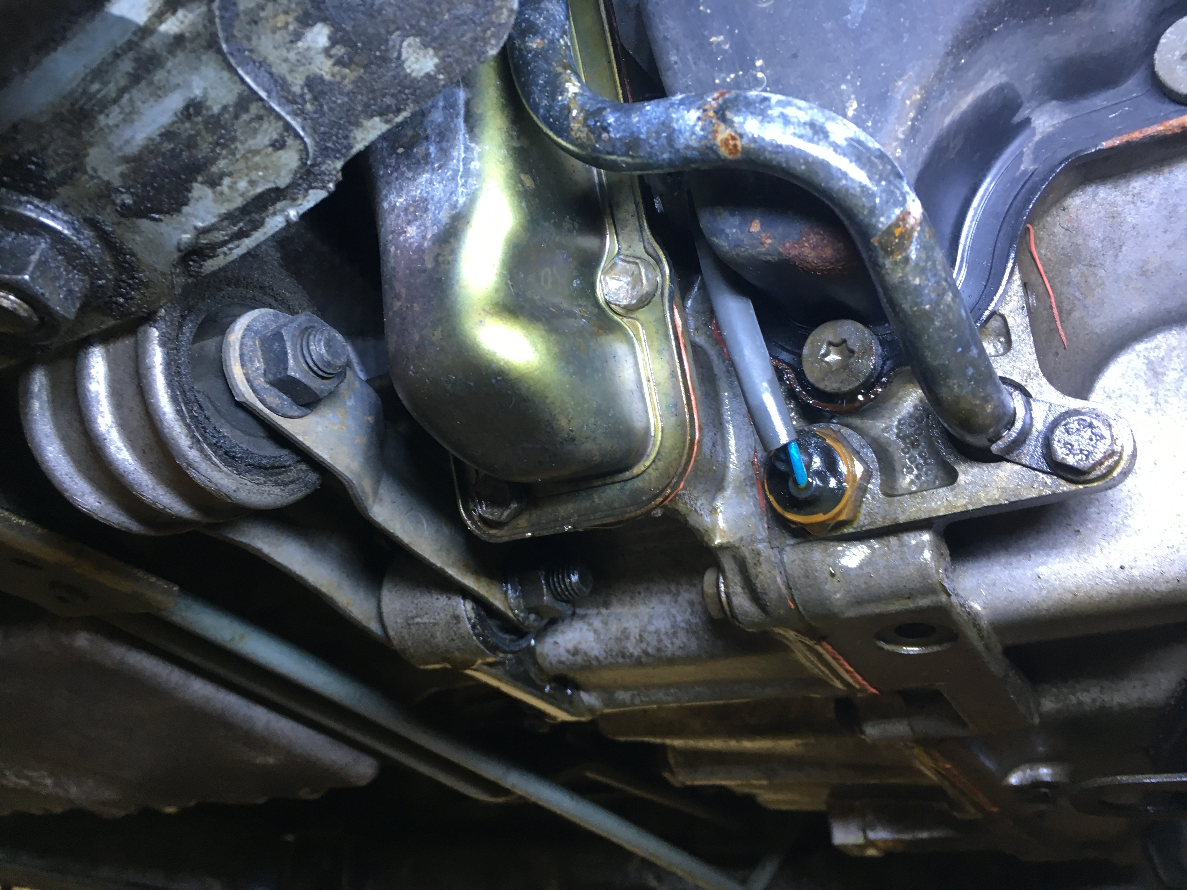

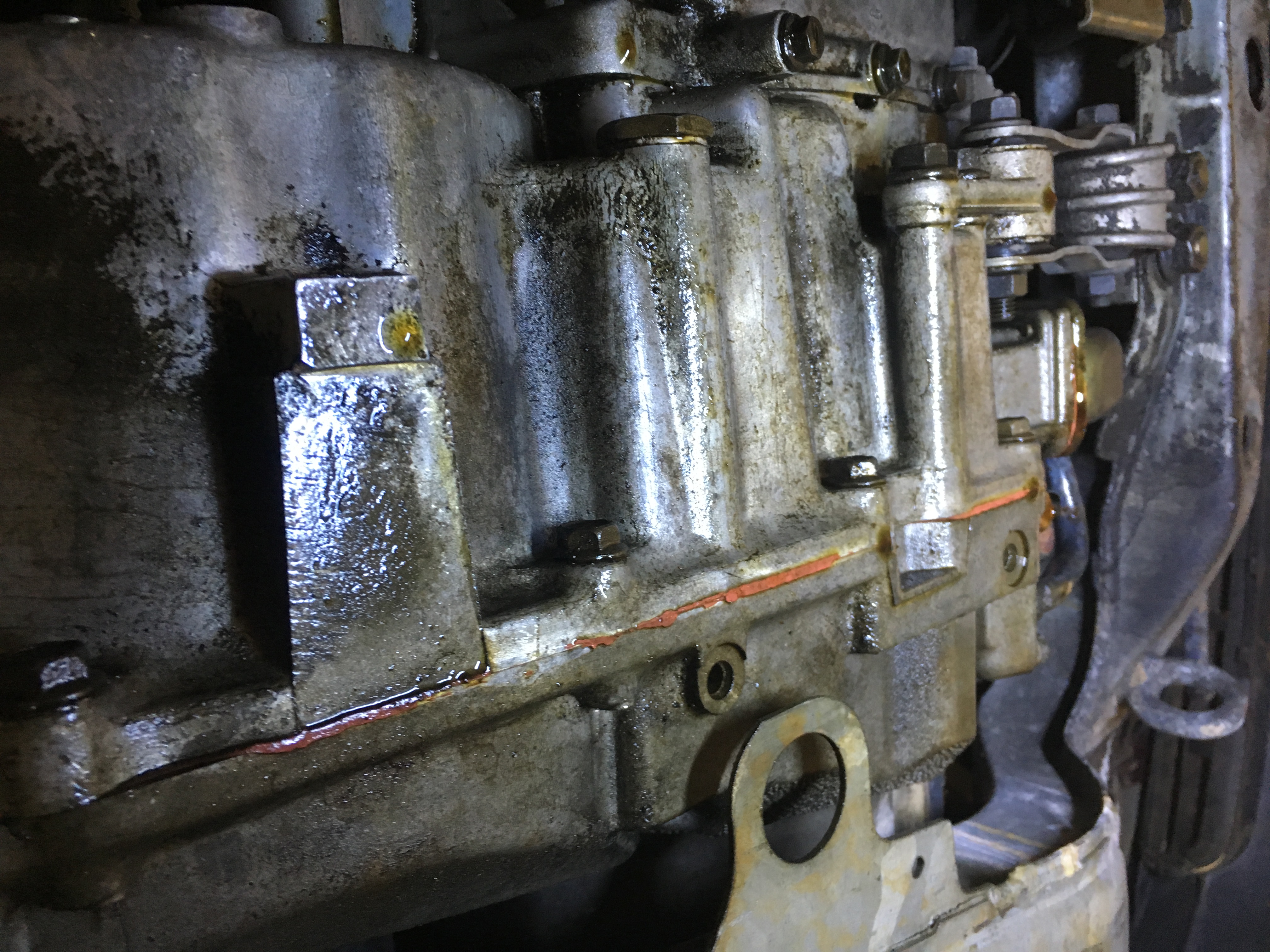

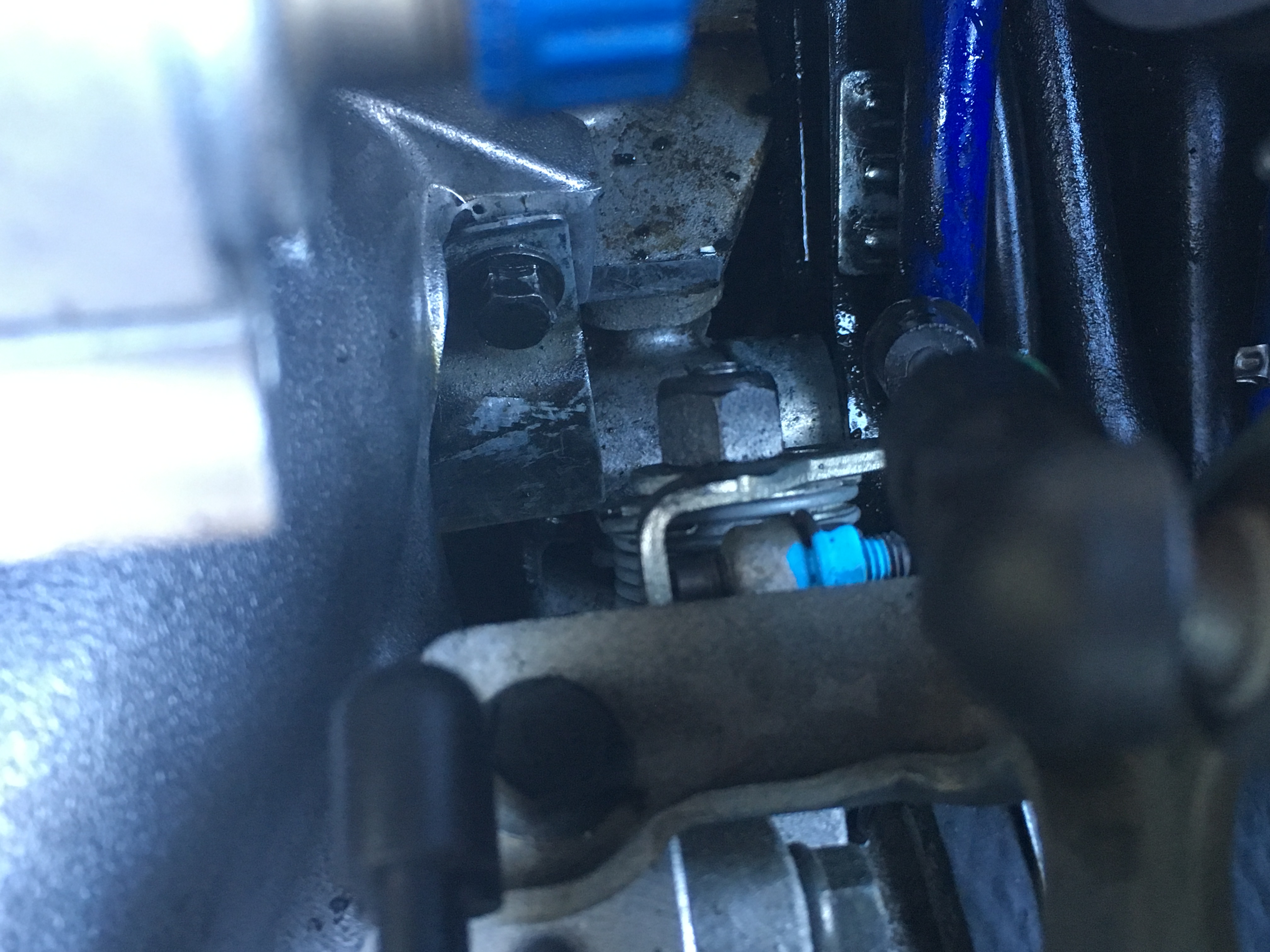

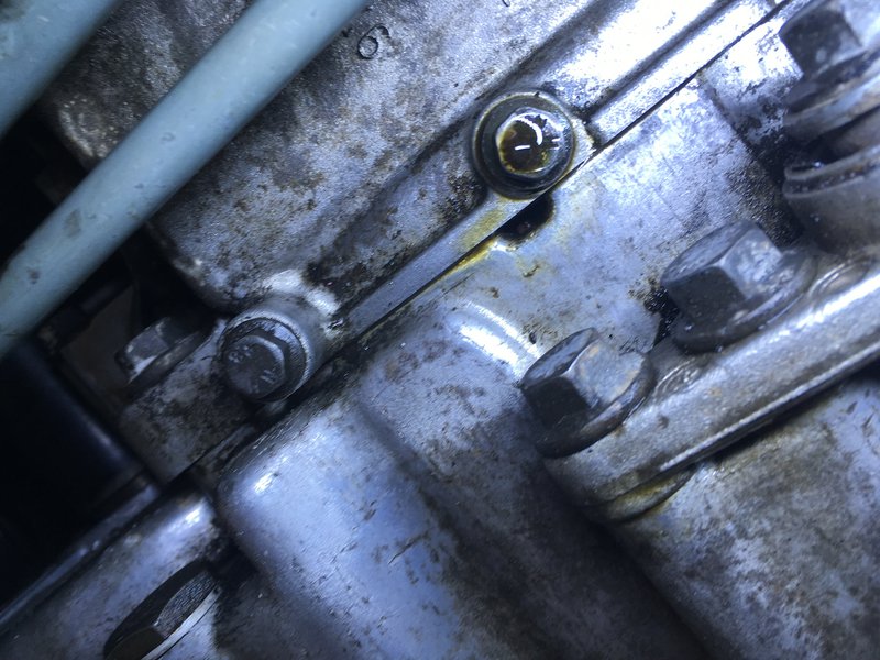

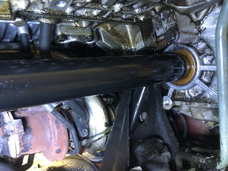

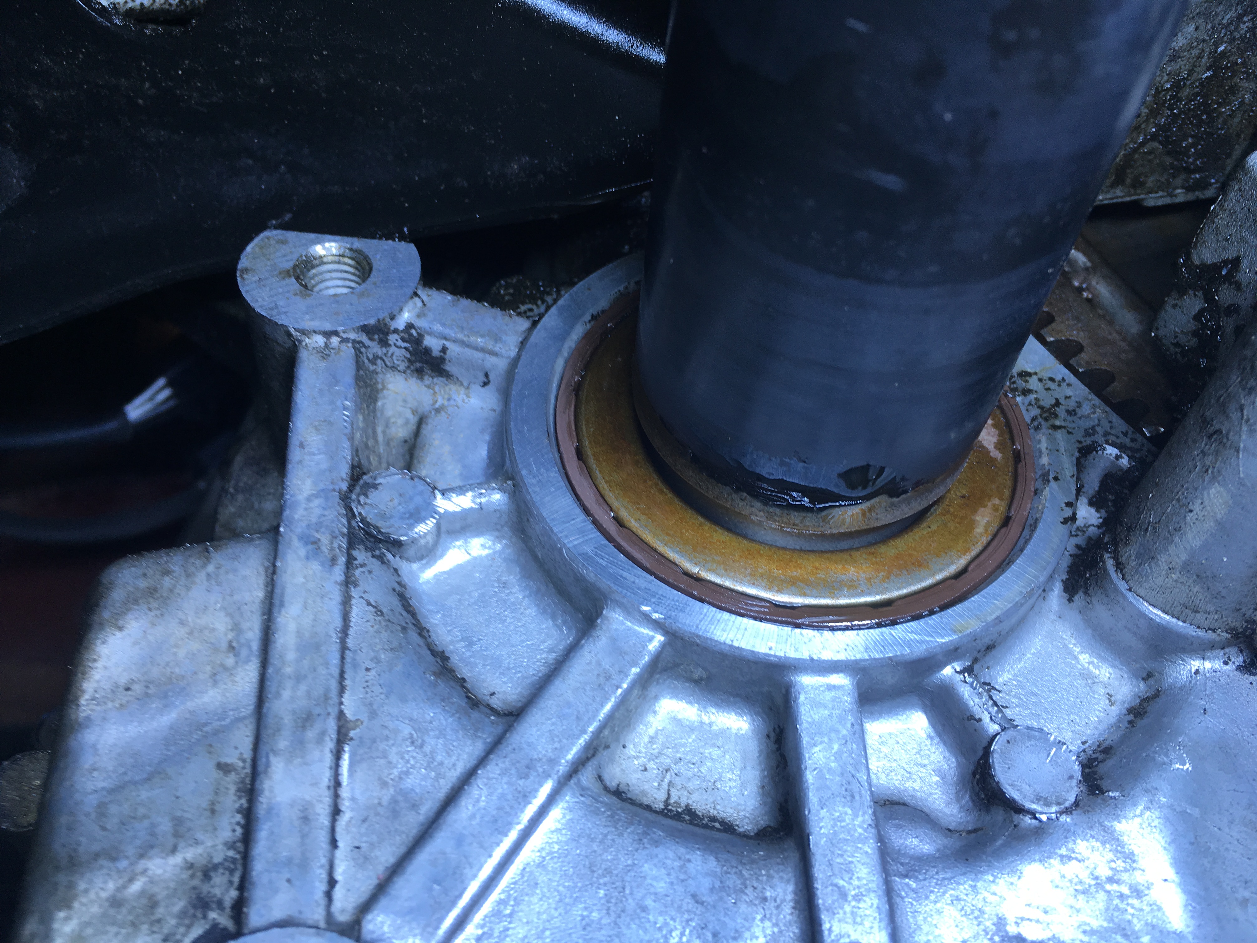

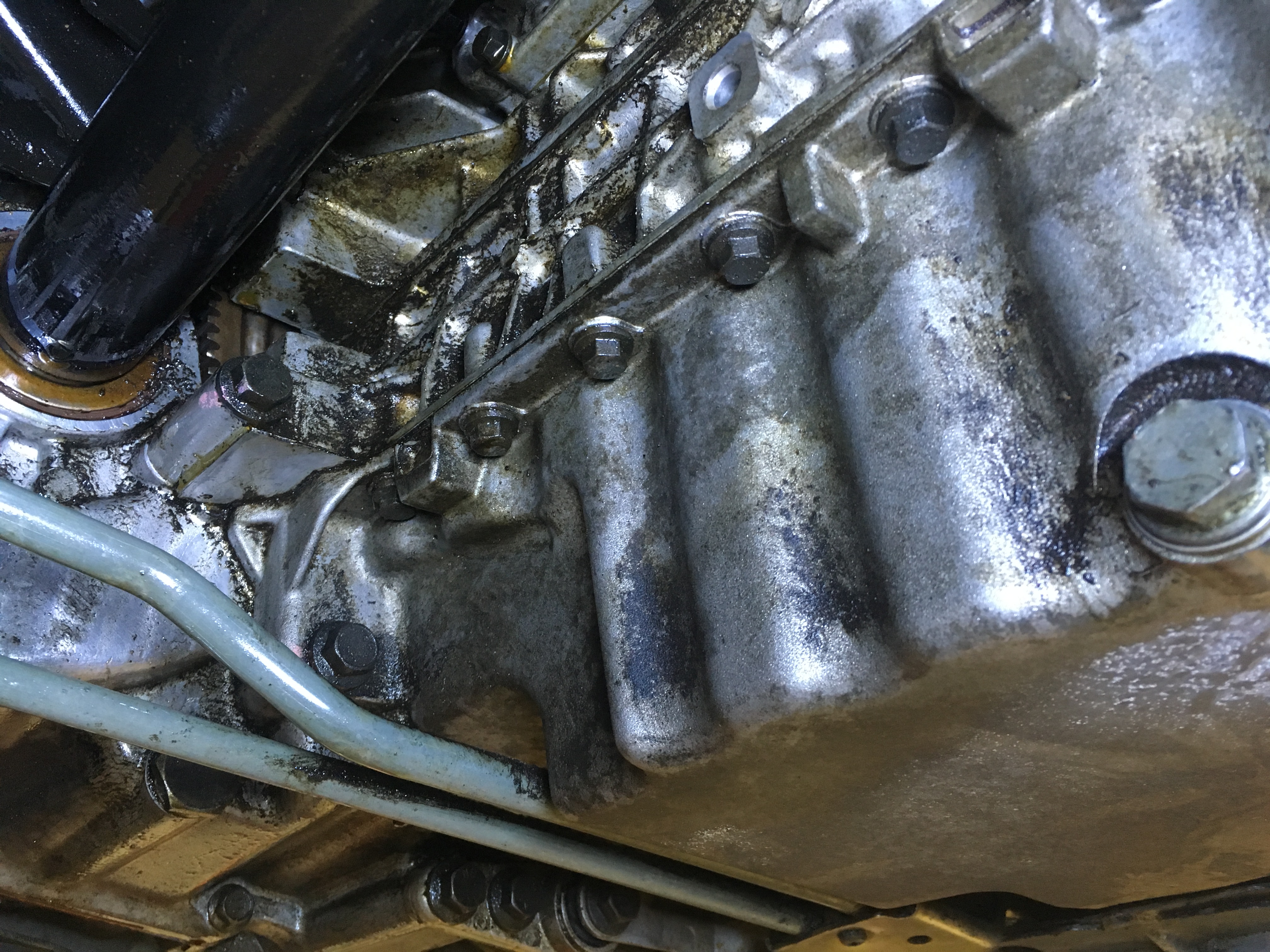

Now on to the oil leaks (yes, plural). Last night I put the car up on the lift and did a thorough inspection of the leak area. I took before photos, cleaned it off very well, looked again, ran the car in drive on the lift for about 15 minutes and kept checking. I took after photos as well. From what I can see, there is oil coming from the drive axle seal (maybe above it, too), the weephole around the RMS, and the bottom front side of the transmission pan.

Transmission pan leak after 15 minutes run time.
Drive axle seal leak after 15 minutes run time.

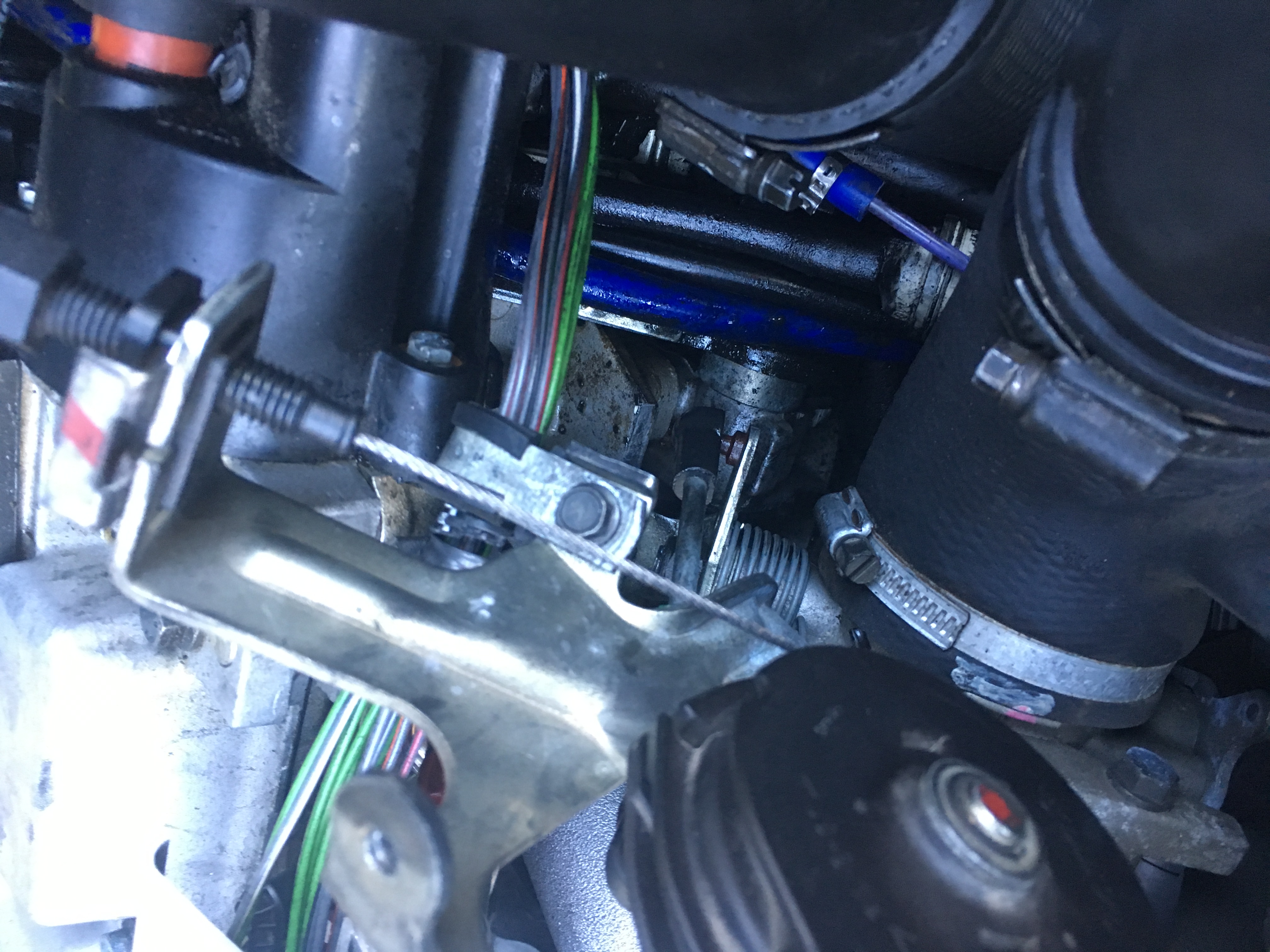

What is that loose blue vacuum line in the first pic?

Transmission pan and drive axle seal shouldn't leak oil, only ATF which is pink. I suspect those are somehow related to the other leak(s).
RMS weep hole looks pretty conclusive. :(
The all leak at the turbo, wouldn't worry too much about that unless it is copious (apologies but I didn't read earlier in your thread if you already talked about how much it is leaking).
Good eye! I was running a new silicone vacuum line to replace the rubber one and took this photo half way through the process.

I was afraid of that. I'm thinking now that the oil around the drive axle seal is leaking down from above, probably from where the oil near the turbo is.
