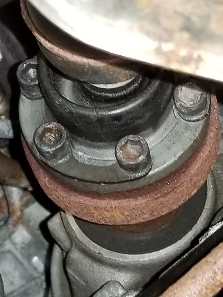

There is not much play on the propeller shaft, you'll need to break it at the cross brace.
After removing the center and rear hangers I dropped the exhaust as far as possible without damaging the CAT downpipe.
With the exhaust flange blocking the shaft center bearing and the resonator blocking the U-joint I couldn't get it angled enough to remove the rear CV joint from the flange.

I loosened the front CV joint bolts halfway but it gave no clearance for the rear CV joint.
Do I need to completely remove the front CV joint from the flange? If so then I'll mark the U-joints for lining.

With the exhaust bent to the right I did try lowering the center U-joint to the left but no luck. Biting my teeth in fear of breaking the exhaust I was too cautious. :o
I'll try it again tomorrow. If no success I'll cut off the resonator close to the mating exhaust flange. I can get the Walker resonator at autozone for only $43.

The shaft now has 100% clearance of the exhaust after letting the muffler sit on the floor. The U-joint still won't bend enough to get the rear CV joint out of the flange.
I also loosened the front CV joint bolts further, rotated the shaft to get the U-joint at different angles, and used a pry bar on the joint within the flange but still wouldn't release.
Seems like my only option is to remove the entire prop shaft or cut off the rear CV joint flange I'll be replacing?

I did remove the two M8 bolts on the back of the flange so I could push the rear CV joint backwards but no success. I tried prying the joint from the flange but haven't tried hitting the flange yet.
If I cut off the flange to get the CV joint removed seems as if I won't be able to get the new Febest CV joint into it's flange after I mount it with the 24mm nut?
