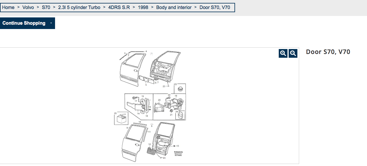

Pete - looks good per VOLVO OEM website
- Posts: 15482
- Has thanked: 2197 times
- Been thanked: 1850 times
To confirm wagon and sedan doors are the same. Aluminum control arms were fitted to 93 and possibly 94 850's only, and had a replaceable ball-joint so easy to identify. Some owner prize these and I sold a set in good condition to one of those owners. Personally it is nice to be able to replace the ball joint, but they are softer and more likely to bend, I still prefer the good old steel ones.

Door is for an S70. Not sure it will interchange. Hey Pete. I have a black driver's side front door you can have. I replaced it with one from Harry's in Hazelton because the paint was a bit scratched up and I could get a complete replacement for $35 which was considerably cheaper than repainting the existing one. There's no rust on it and integrity, other than paint scratches, is fine. I'm in western NJ and work in Newark. I have to be in Poughkeepsie, NY in a couple weeks, probably on a Friday evening. You can drive to Long Valley, N.J. or Newark, or meet me in Poughkeepsie, choice is yours. I'll take some karma points and a six pack of good beer for it. You'll have to swap the door handle and lock. PM me and we'll work out details if you're interested.
