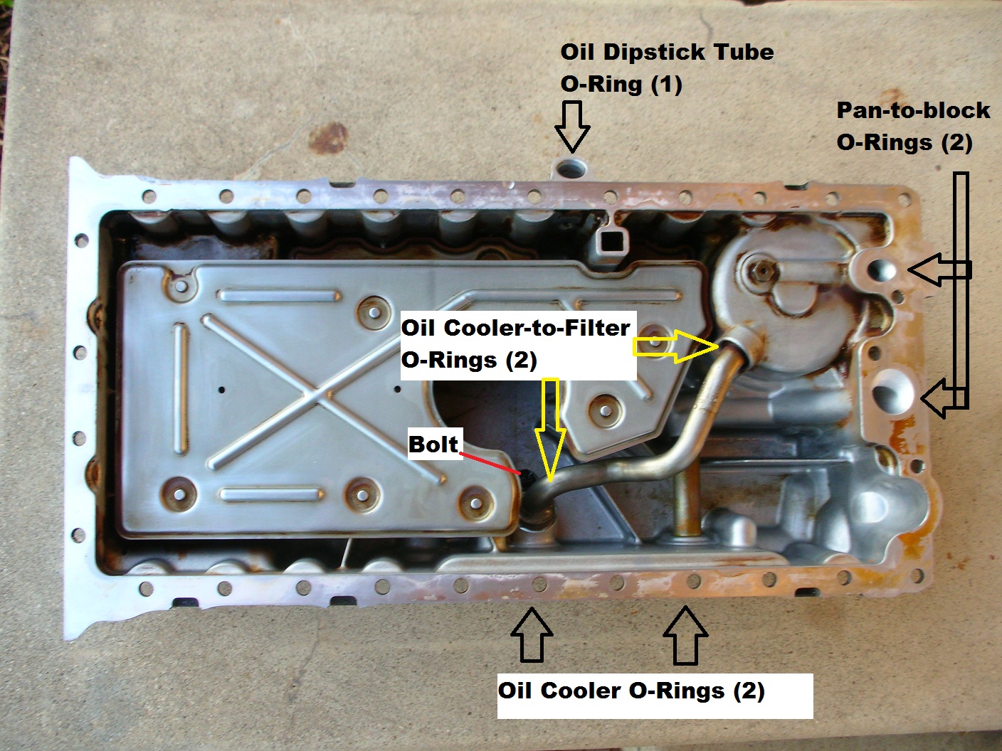

3. At this mileage of 170K-180K, consider dropping the oil pan, clean it all out. This is great opportunity to replace all the infamous O-rings. Again, use only Volvo O-rings.

CORRECTION on my previous photo, I showed a YELLOW arrow as "excess oil bleeding"...but not sure.
According to this DIY by ecbsykes, that port is for the external oil cooler for models from 1999 onward:
viewtopic.php?f=1&t=31236

2. Drop the pan and see what I find - clean out any crud - clean sump screen. If item 2 didn't reveal any BIG problems go ahead to item 3.

5. Replace the pan and O-ring seals.
