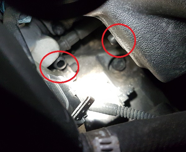

We exchanged it, but unfortunately it had not led to the desired effect yet.
Today I listened again to the running engine and discovered a hiss near the servo pump. A few minutes later I discovered some smoke with my torch light.
Well, what can I say: I had the suspicion that something was done wrong when changing the oil trap. On the left side of the intake manifold is a small hose connection from which the oil mist came. I also found the corresponding hose. It was not possible for me to connect it now due to the boiling hot cooling water pipe and the hot intake manifold, but I think tomorrow I will have a well running car again!
Can someone explain to me what exactly the small hose has for a function and whether a hose clamp is foreseen to secure it?

That small hose and nipple are part of the PCV system, it is infamous for the hose to fall off due to various reasons including just rotting away. Almost always throws a p0172 however, with the car otherwise running pretty normally. Hopefully there aren't other hoses or parts disconnected. Or maybe the Torque app is giving you there wrong code.
A hose clamp is not necessary, but it has one from the factory. A zip tie works well in there. Get some very long nose pliers to help you with the install.
